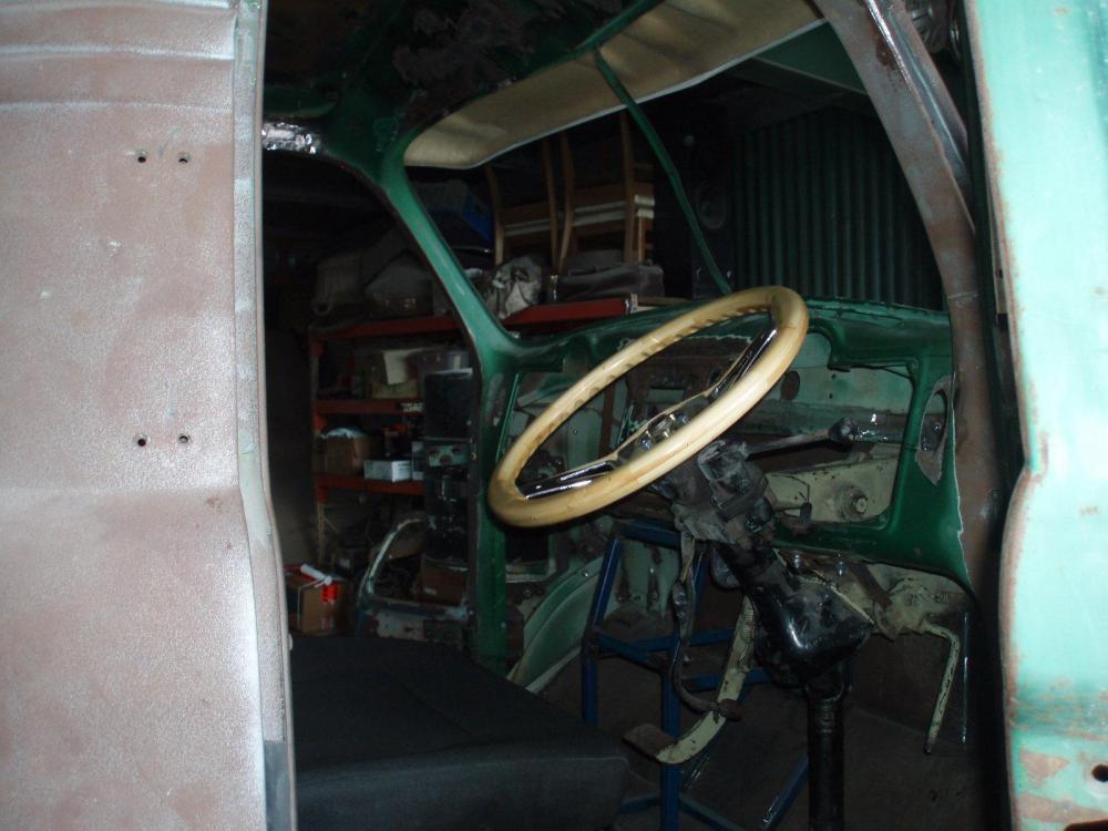

I was going to do that kevin all did that in his camper. I started but I took the thing apart and made a new column used a lower shaft with the joints from a freightliner. I mounted my box out front of the axle like a modern truck. I'll get my cousin to take some pictures I haven't a clue how to do all that on the computer.

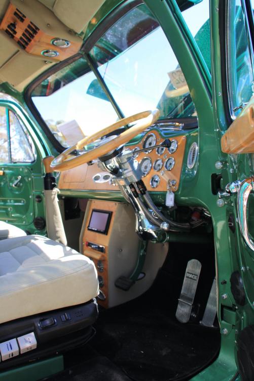

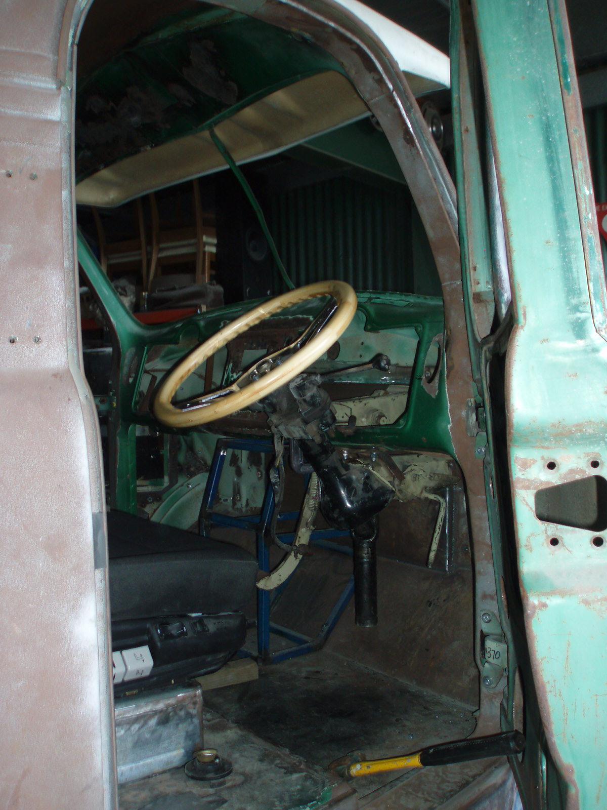

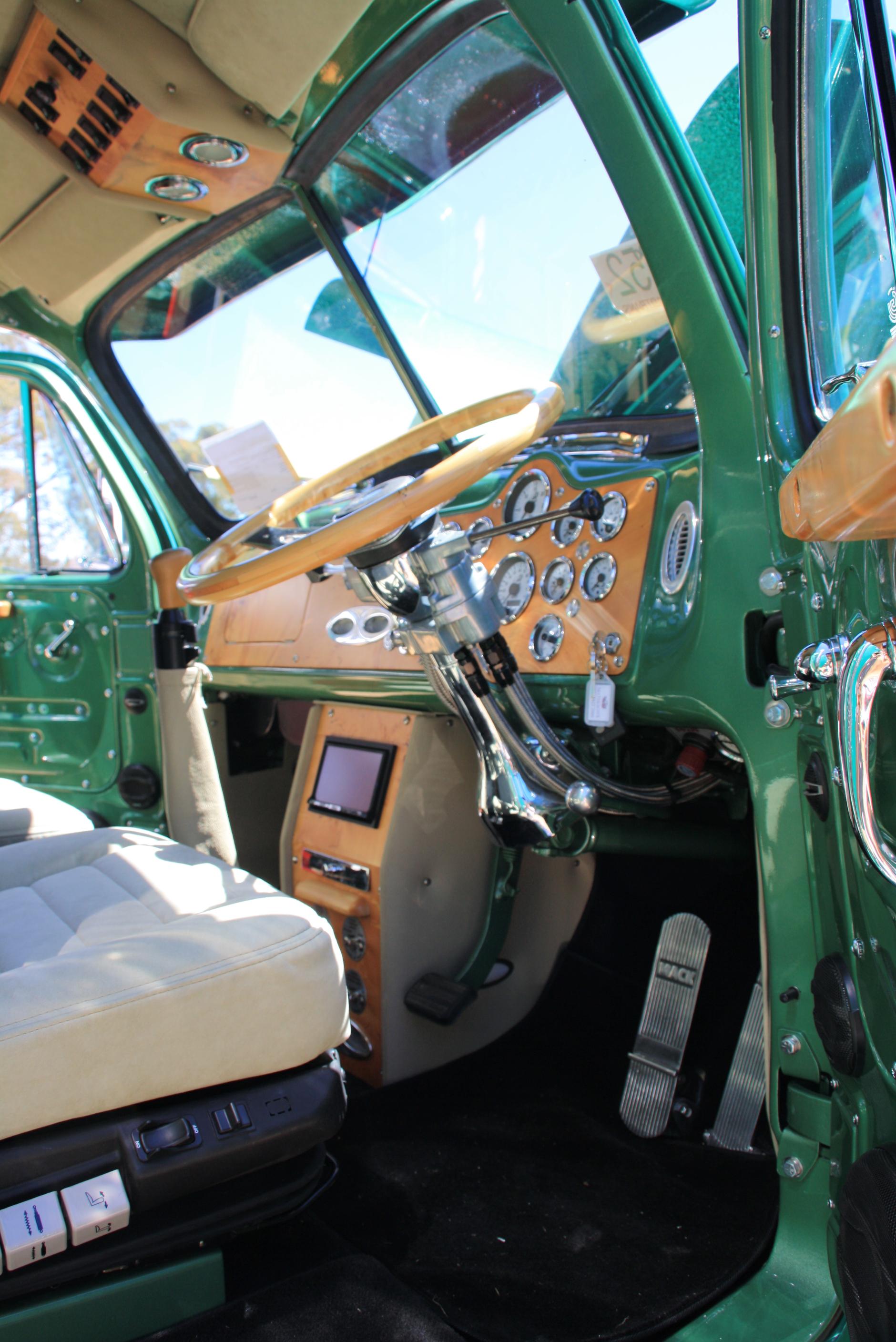

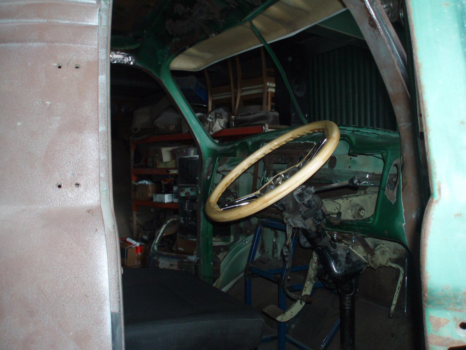

This is also the R model clutch pedal and yes standard right side drive, the reverse should apply for LHD. We fitted the complete R model steering with adjusting slide in/out and clutch system, all mounted to reinforced lower B cab dash board - all works perfectly. These are our work in progress with R model steering system, a bit dark but should give you an idea.

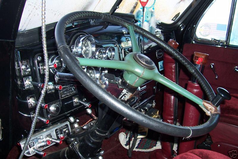

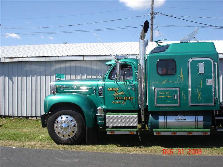

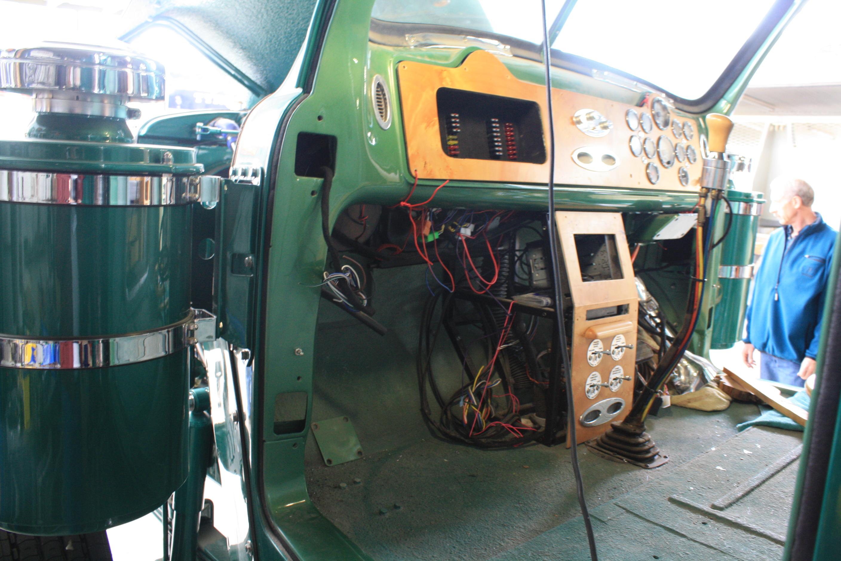

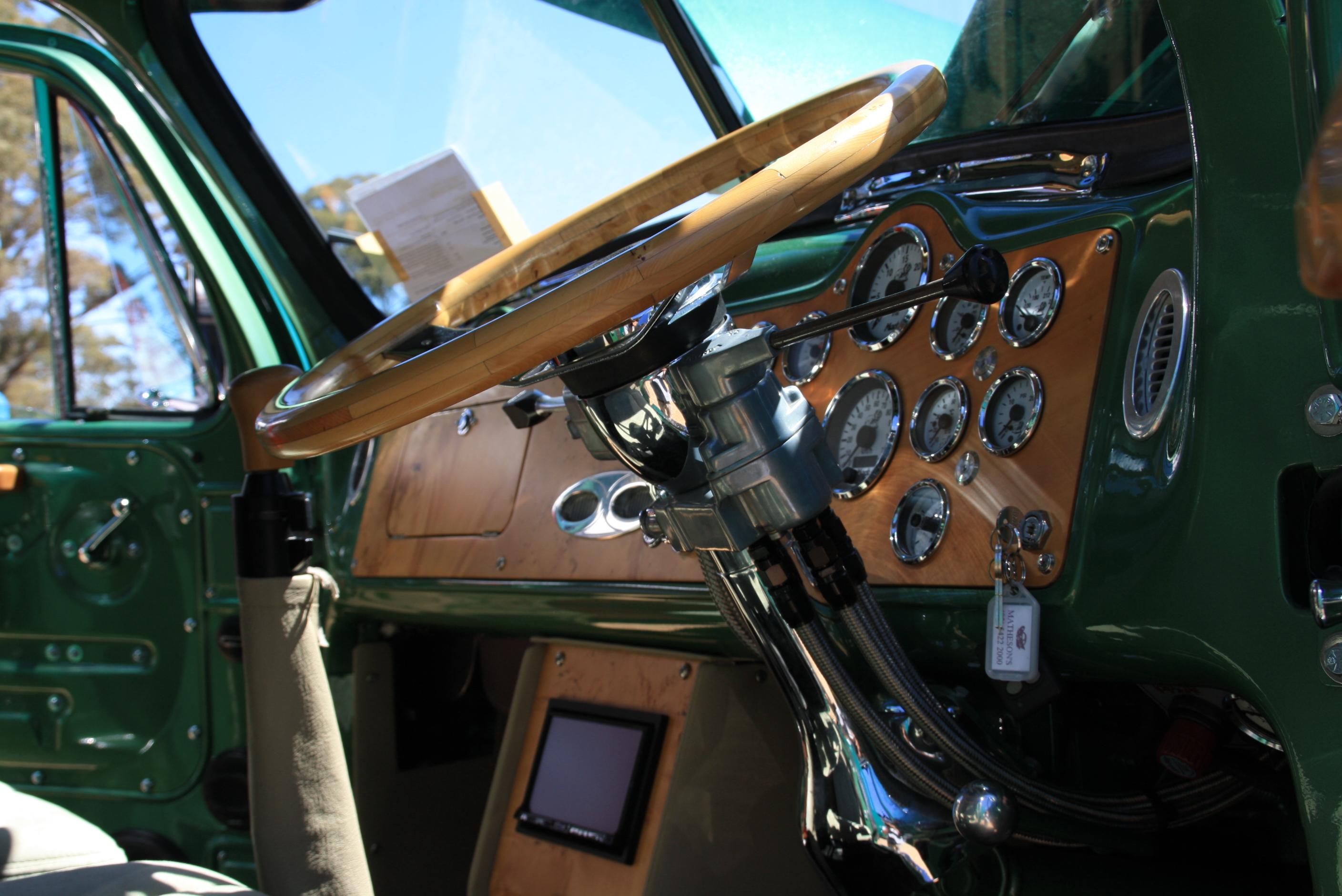

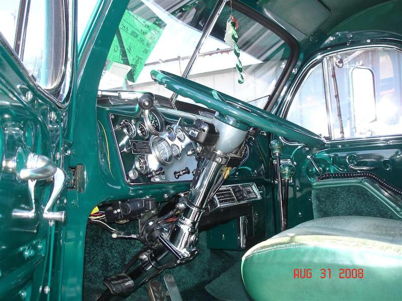

Also here is Mert Huberts B75 with the the standard B75 steering system that you may want to consider, you should be able to find a B 75 steering system - maybe try contact Kevin All, he has a good stock supply.

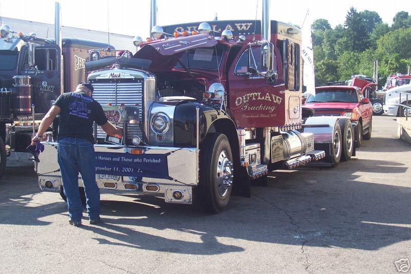

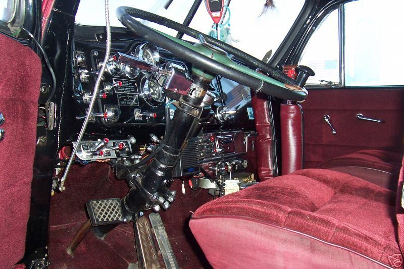

And here are 3 pics of the Outlaw B75 steering column and an original B75

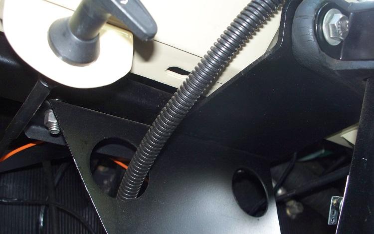

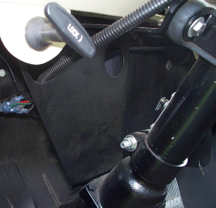

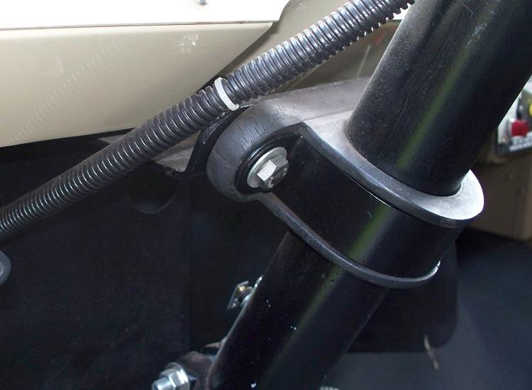

A couple pics of the original jointed column in my B75 with L cab.
The column is not bolted to the dash.
There is a tray looking bracket behind the dash with a separate bracket connecting between the "tray" and the top of the column using a rubber insulator.  An additional vertical bracket bolts between the steering column joint and the bottom of the tray.
