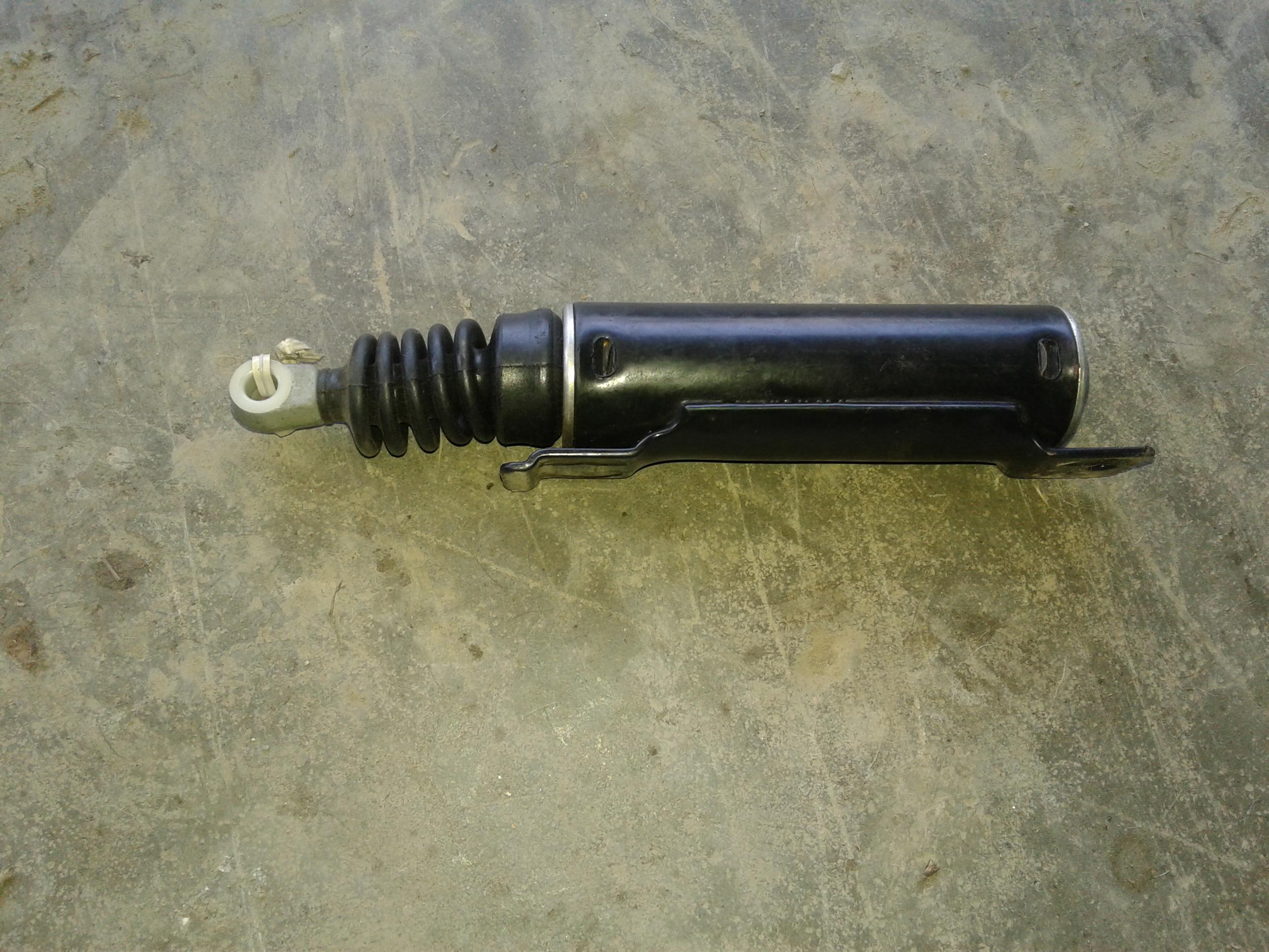

Is this the cylinder your looking for. I've got 3 in stock
