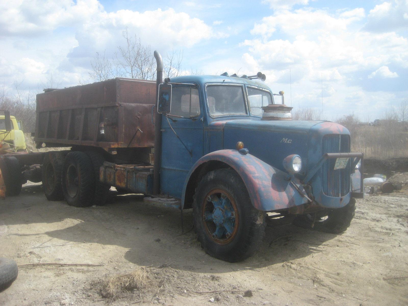

I have had this truck on the property for 10 years decided to do something with it. :)
I have lots of other projects going on some finished some not, and as the saying goes you need to start somewhere.
Interesting looking at the manifold on this Mack and it has the name LANDVA below the Mack name. ???

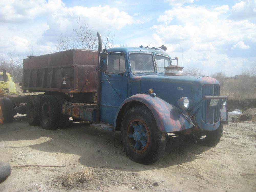

Yes Indeed the trucks are in Saskatoon. They have been here for a long time, The owner bought them from the US army when they were doing the Alsaka Highway. He himself worked with them building the Gardener Dam in the 60's i believe.
I was the one trying to sell all three on ebay an number of years ago. The owner is 96 years old. and a friend.

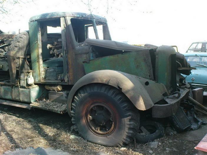

You were close 2 blue one green :)
I bought the property from him 10 years ago and they were here.
I bought the one you show above via a barter for rent.
This one is destined to be on the road again via mounting on a new chassis.
I just removed the cab today.

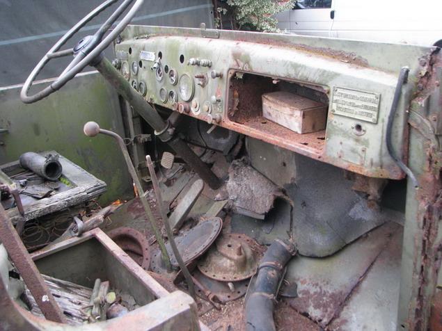

It now makes sense that they were recabbed as the owner says they are 1941 but the dash plate says delivery 1st month of 1945.

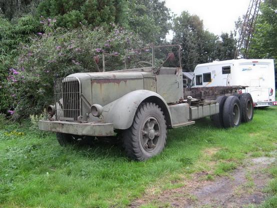

No, the trucks are 1943-45 regarding to dual rear tyres. All earlier series rode on "super-singles" at the rear, 14.00-20 size. One of the trucks had a VIN plate on the dash as I could see from ebay pics. It was about 100 trucks away from my NR. I got info from Mack museum of the truck leaved assembly line on January 15 1945. So about that time your truck did the same.

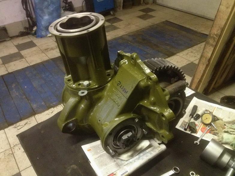

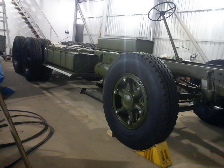

Happily I have a progress on them rear diffs. All NR's were equipped with 9.02 carriers from the factory. A book says there was some series of the trucks with 7.33 or so but those were early series bunch and a few in number and nobody knows for sure they ever existed. So 9.02.
With a help of one our fellow member I could purchase 2 sets of bewel gears off B-61 rear diffs. Don't remember the initial ratio but when combined with my spurr (bull) sets the result is 6.34. It seems quite good to me or even fast. The calculations gave me something like 92 km/h top speed but I'm not sure the truck would ever reach them with its stock 131 horse stable. Let's see. The actual progress is that fast that I have one of the diffs (mostly:D) assembled and going to put in the banjo (the next spring:D). The 2nd one is in the waiting line. Anyway those gear sets are an important point to pass by since I couldn't finish the chassis without them.
