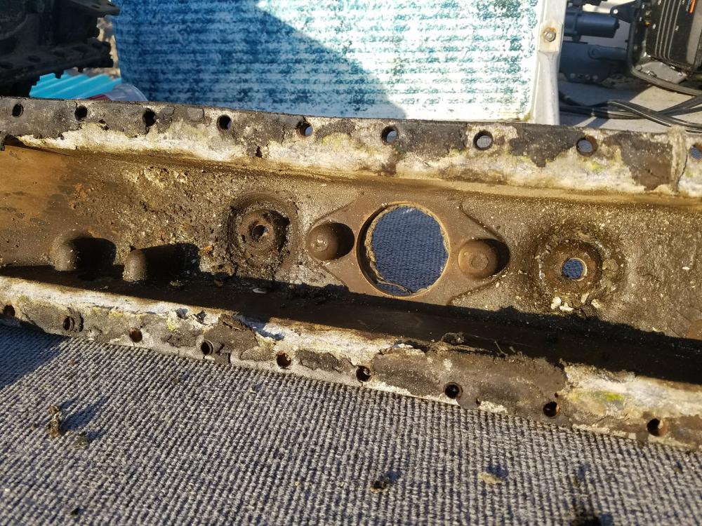

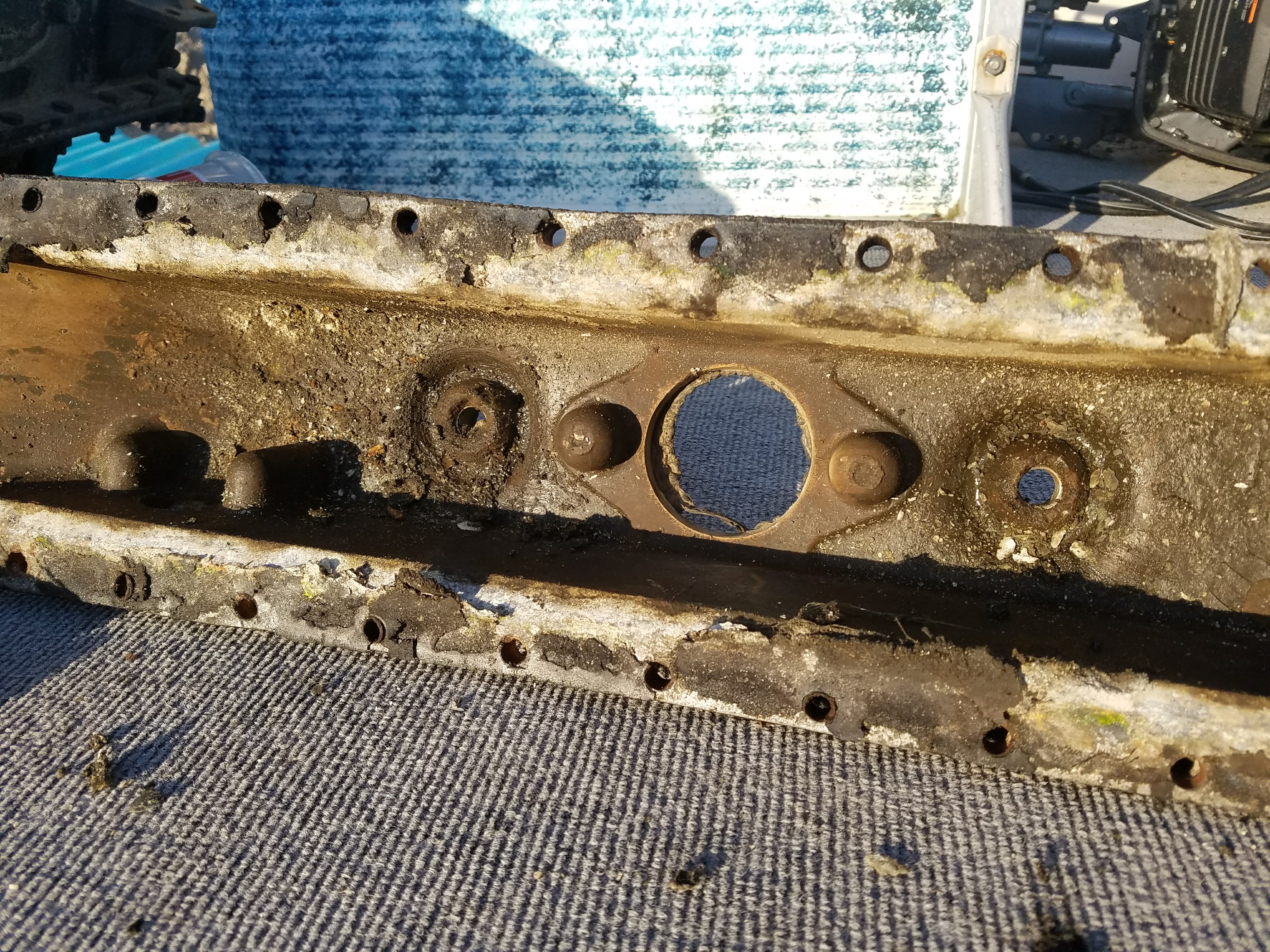

Finally had time to pull the Radiator out of the truck and get the lower tank off. As suspected both holes were punched thru into the lower tank. In the pic of the inside of the tank You can see the 2 domes where the lower water pipe bolts to to keep thats how the mounting bolts holes should look.
You will not be able to weld this because of the corrosion that has contaminated the aluminum.
Two thoughts; use a bolt from inside the tank turning the mount into a stud instead of a bolt. That way you would be able to adequately seal up the bolt head. Another option would be to use gray Marine-Tex or JB Weld to seal up the hole. I'd go with the through bolt if it were mine and reinforce it  with Marine-Tex or JB Weld and maybe epoxy it into the tank to keep it from turning as well.
And of course if you want to spend the money you can have a new tank cast. Probably in the three to four hundred dollar range for the casting and machining. I use Cattail Foundry in PA.
Not to disagree, because it may not work, but sometimes you can weld stuff like this, I'd try it.  I would media blast it and grind the area needing to be welded, than put some heat to it and then blast and grind again.  To me it would be worth a shot, but Id try to find a guy who is used to welding contaminated metals (fuel tanks come to mind).   Andy
Depending on the situation, welding may be doable or not.  I had several cracks welded on the aluminum radiator tanks for my 1959 B-75 about 8 years ago.  Knock on wood, no discernible issues.
Jim
If you try welding I would have a latex pattern of the tank made first. That way if the welding trashes the tank you can have a new one cast. Latex molding supplies are widely available on the net.
My philosophy on stuff like this "is do no harm" to what maybe a very difficult part to replace since most used tanks are probably going to have corrosion issues as well.
I would agree with fxyfmn   thats beyond any hope of welding
 Dropped it off at my local Radator shop today. (Rex radiator Bensenville IL) The Owner knew what kind of mack it was out of before I could tell him . He Even guessed the year right (1977)  He said he did alot of these out of valueliner cement trucks and cruise liners.  suggested going to a stud mount if he can save the bottom tank.he made mention of going to a 4 row instead of the current 8 row to save some $$$ not sure if I want to do that in case it ever gets  a larger engine at some point of its life.  he will be getting me pricing on Monday for a re-core and the lower tank mounting hole repair.

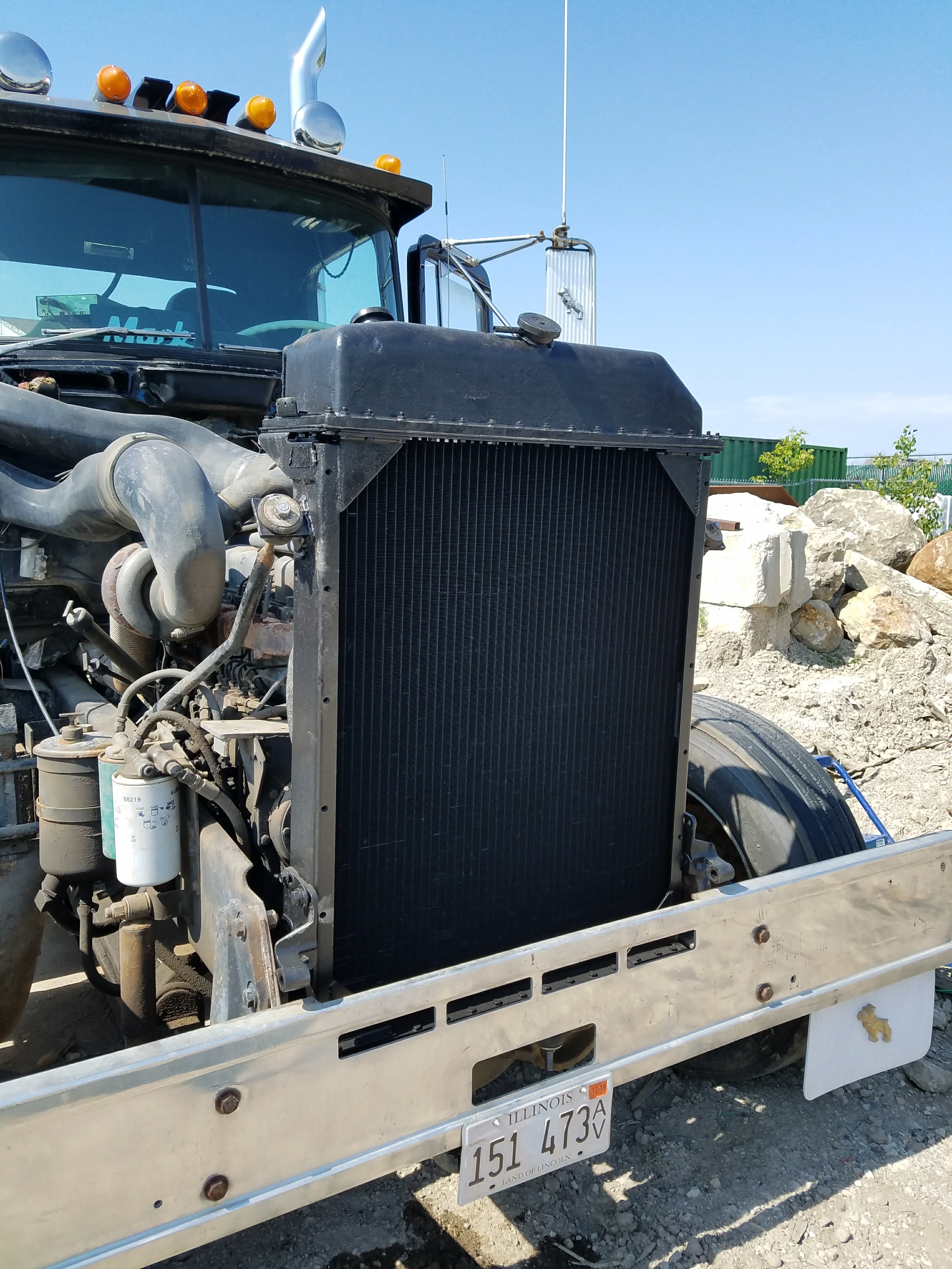

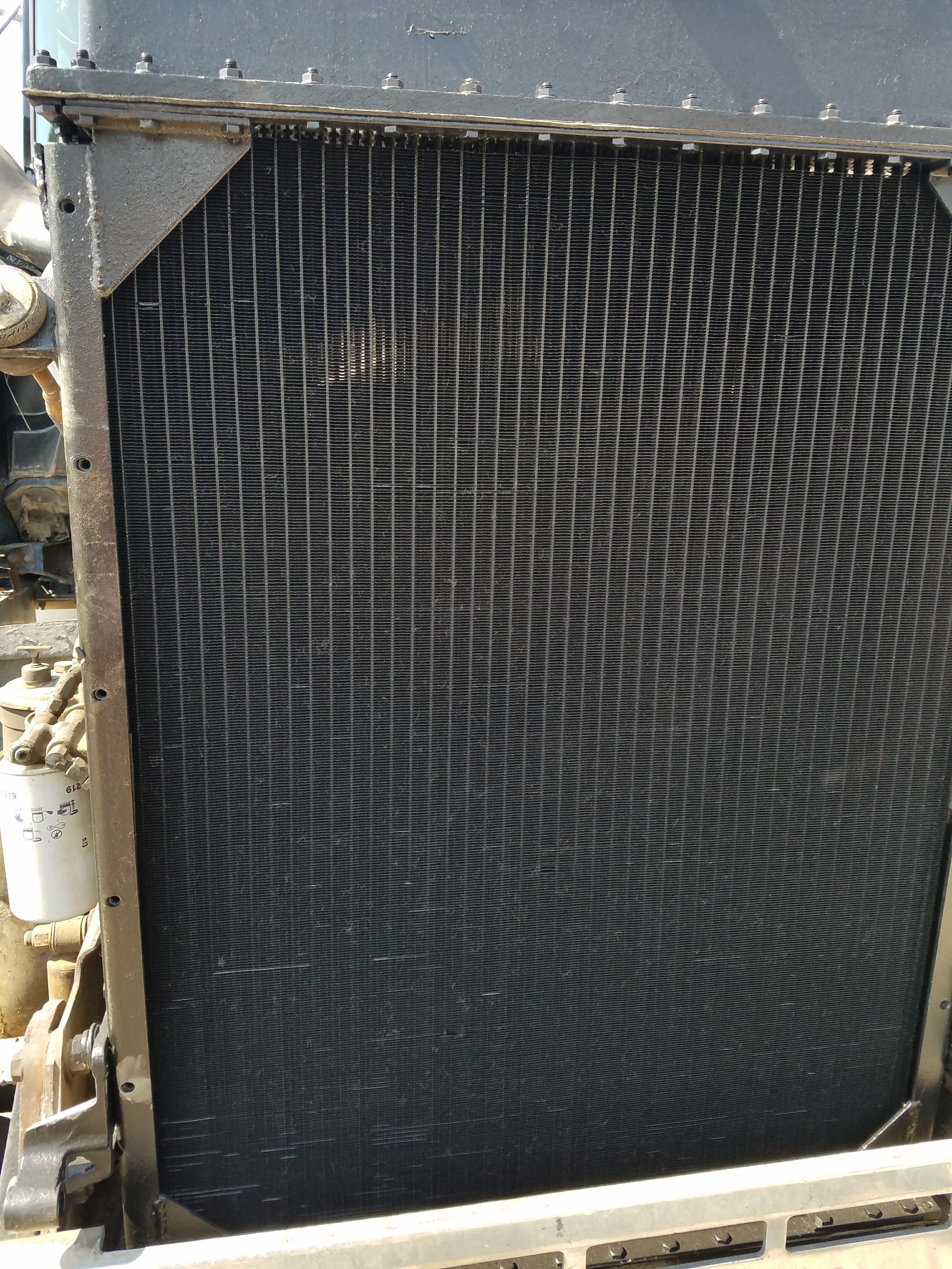

Got my Radiator back today. The shop was able to save both upper and lower tanks and put in a new core. they converted the lower tank to a stud mount as suggested. I was able to install it late this afternoon and fingers crossed it wont leak at the studs.... I will need to source some new rubber bushings for the upper mounts as they are dry rotted and cracking off. I had used rods and the rubbers off of a retired  87' R model when I converted my cab to air ride. (best thing I ever did to this truck)  I did away with the X brace that previously held the top of radiator to the cab cowl.  Took about 2hrs to re fit the radiator in and get the hood back on. not bad considering this would take a full day on these modern plastic trucks.

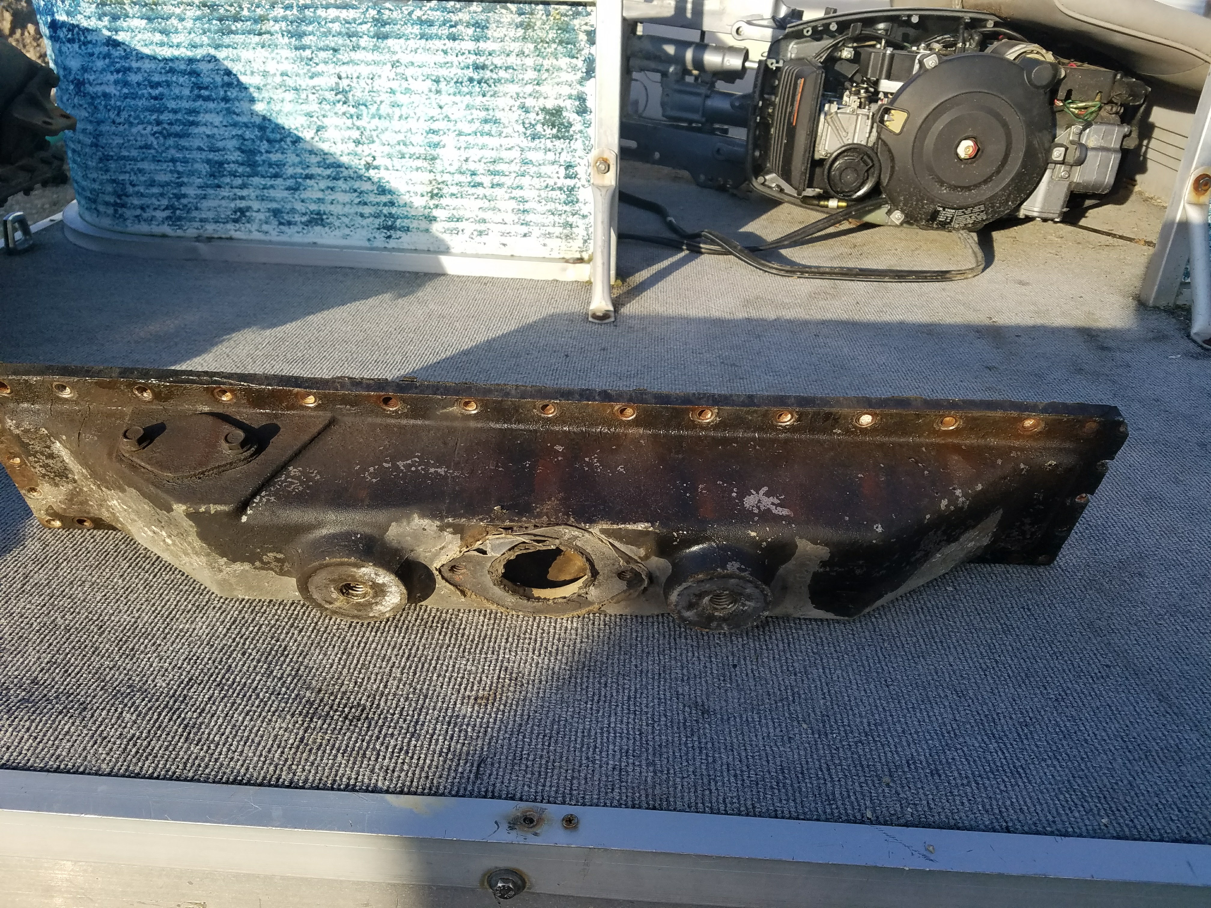

they installed a stud with a heli coil in the tank. they used some form of hi strenth glue/sealant to the stud / heli coil so it wont spin.  where the old bolt had punched thru inside the tank they ground it clean and put a weld across the area of the hole to build it up and seal it off.  looked fine from what I can see with the bottom pipe off and was cheaper than a new  bottom tank.
I had known this tank had a issue as 8 years ago as it started leaking from one of the bolt holes. At that time I just pulled the bolt out and put pipe thread on it and put it back in. It held all those years until the core started to leak at the bottom last month. hope this fix will prevent any further issues.
