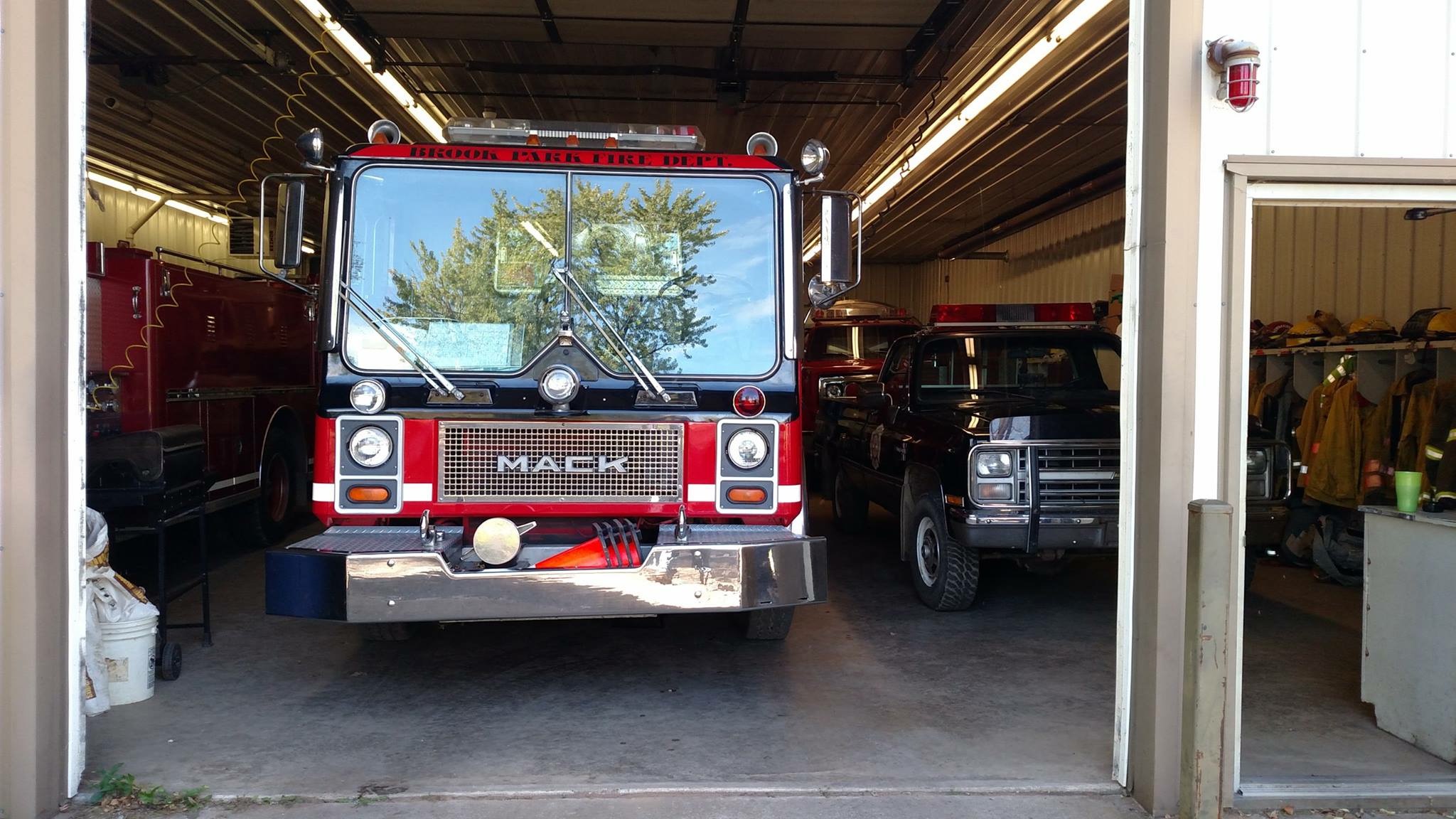

Hi guys, on our department we have a 1983 Mack for our pumper with disc air brakes, none of us have much experience with this type of setup and they need to be adjusted, so looking for some info and pointers on where to start, thanks Joe

can you take a picture of the caliper so we can determine the brand and era, there may be other issues to consider if the adjusters are odd ball....

I'll swing up there hopefully today and snap some pictures,  we've had the truck for quiet sometime, but that's not saying it gets the proper maintenance, me and another guy have taken it on to make sure it continually lasts as long as we need it to, both experienced with air brake systems, just this type is new to both of us, thanks for the input so far I'll post some pics of what they are asap
