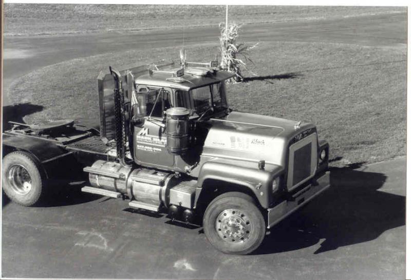

Valueliner, Just curious is all.
I'm talking about the American version.... are the cabs and hoods specific to those trucks?
What was the general intention with that particular model?
Looks like the cab sits higher on them. . .
I see the steering box is mounted on the outside of the frame too. . .?
The cab on both is based on the CA 49 but the mounts for the VL are a little different and the interior packages were pretty fancy.  The hood is different because the rear lower section of the fenders were mounted to the frame of the truck on the VL.
Mack built it as conventional with weight saving components.
Jim

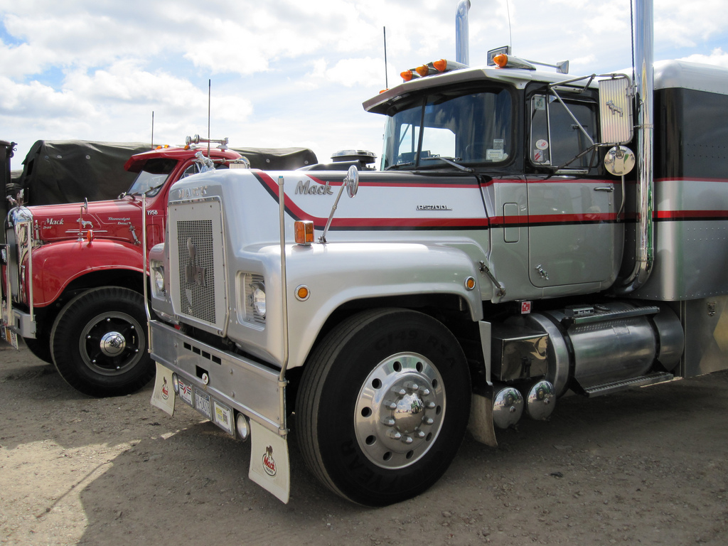

23 minutes ago, j hancock said:

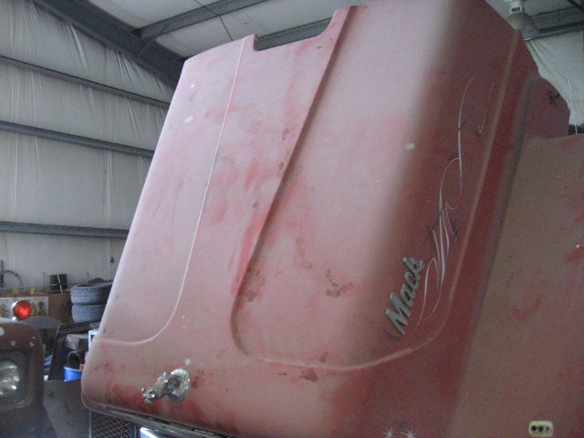

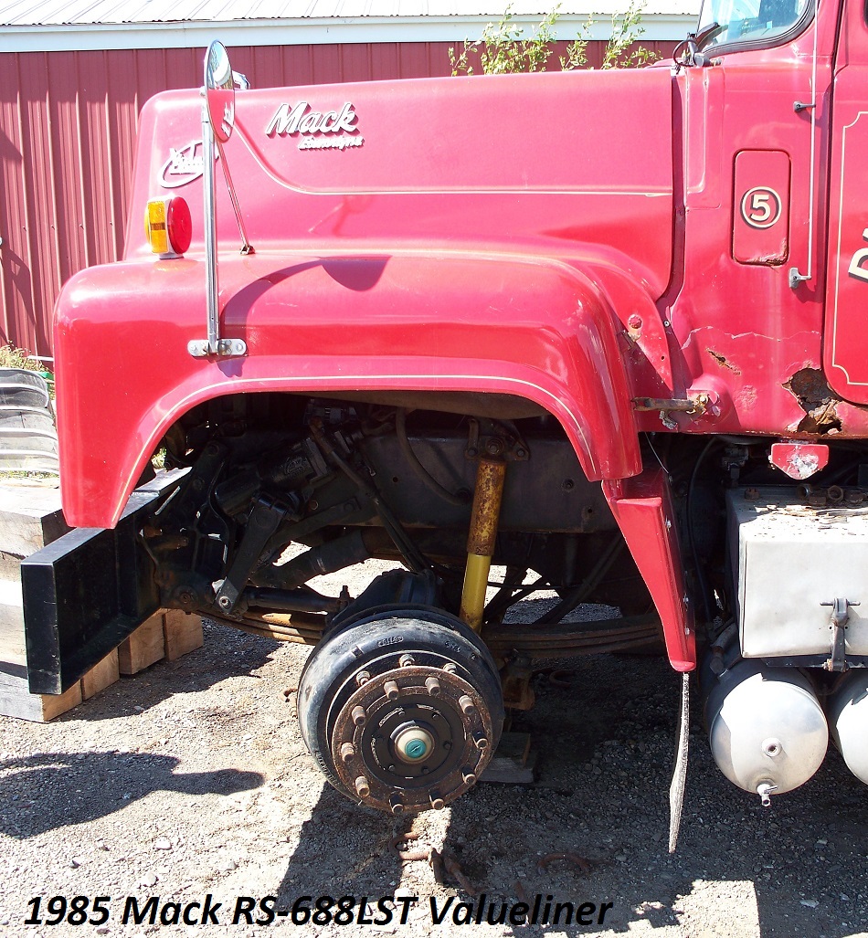

Found the picture showing the hood emblem, outboard steering box and the hood/fender detail.
Can you tell me anything about the logic involving the outboard steering box? Every other 'r' model other than the early Supers/Cruisers have some variation of an inboard steering box. Right?
Doesn't the value liner have a straight frame, and the r and superliner have a frame that spreads from the tanks forward.  Maybe that's why the box is outside the frame.
A buddy of mine bought that value liner from jakebrake86, & on the hood that risen part of the hood that goes across the front where the dog stands also goes down the center of the hood; & makes it look good too

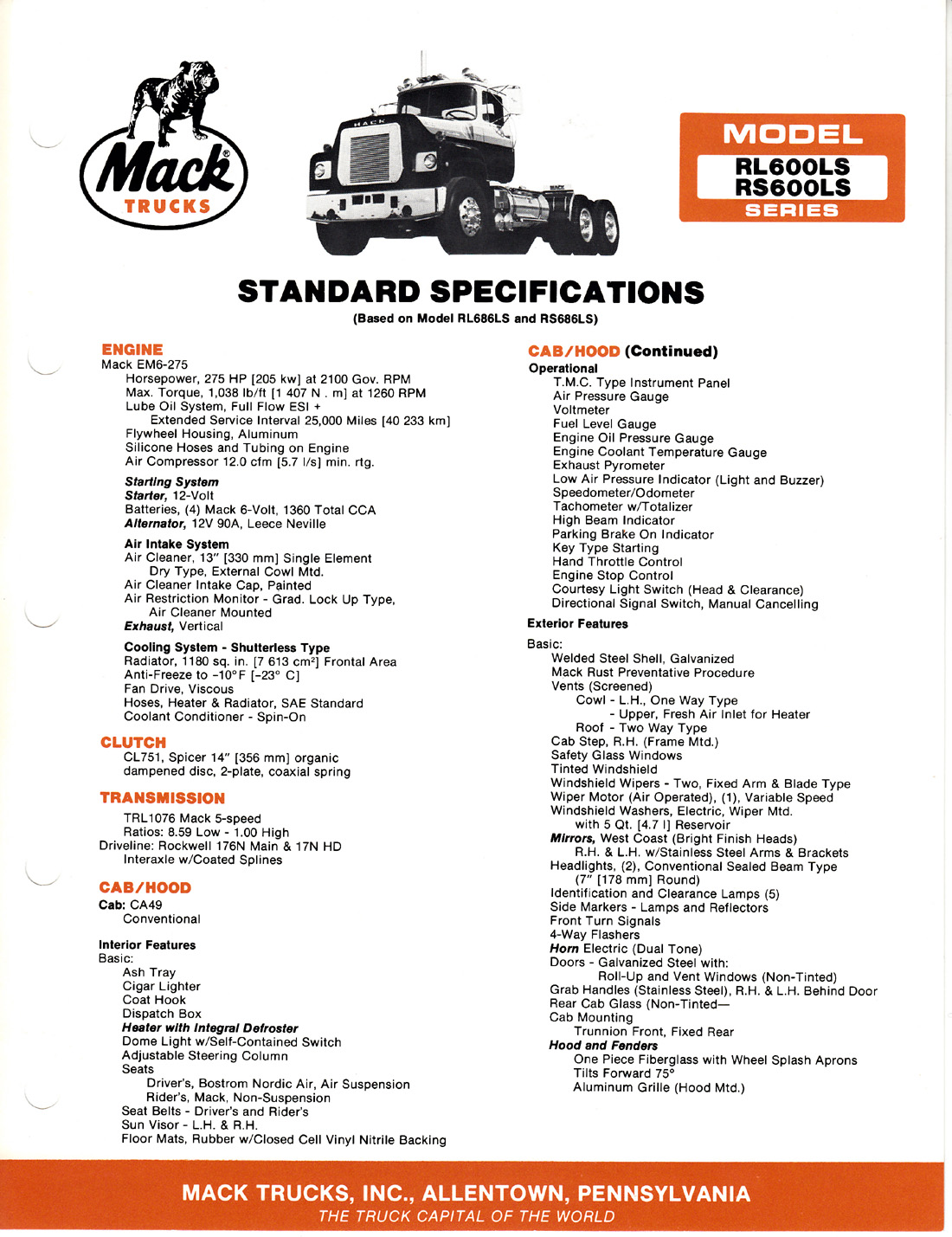

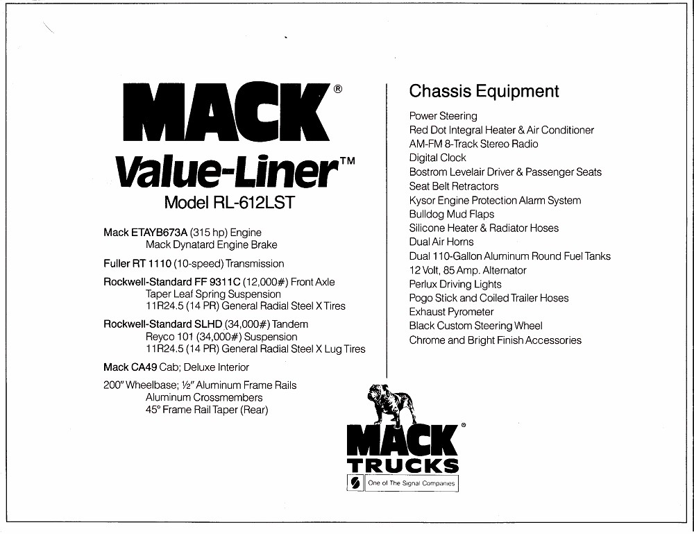

MACK U.S. Dealer Spec card.

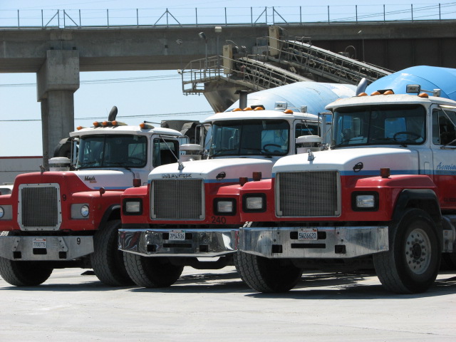

The Value-Liner  was built  lighter than its "east  coast" R model brother. Spec for  spec, it was lighter due to the extensive  use of aluminium,where as the R would  use steel. A big seller all around, I for one was sad to see  it go. The introduction  of  the  CH  signaled the end of the Value-Liner. An R model vocational  chassis known as  the  Western Contractor  replaced it in the dump/mixer field. They  were few and far between though,  as I feel MACK did not promote  them very well. The  salesman  that sold me my '90 RD, did not even know of the Western  Contractor  until I told him about it. I don't  think  they  had the weight  savings as the  Value-Liner  did over the standard  RD,but we're still  lighter than than the  RD. I did like the Value-Liner,as many of  you  did.       Al    (Western Contractor  models shown in pictures both straight  and sloped hood RD's)

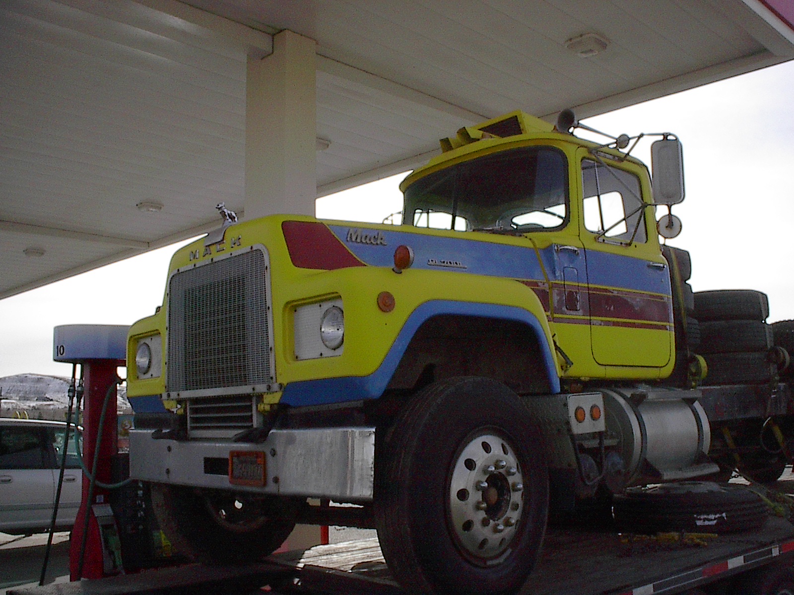

Were there any Valueliners "600's" with Non-Mack power plants?..... Seems the few I've seen have all been the 2v 300+ (or 350?) Mack six. When was the 600 Valueliner discontinued?
I've seen plenty of hybrid 700's
And I have to agree, it seems a little counter-intuitive to call them Valueliner when they were more expensive to buy. One can only assume that the "Value" was only realized in the long-term, and only if you were hauling by the ton!
