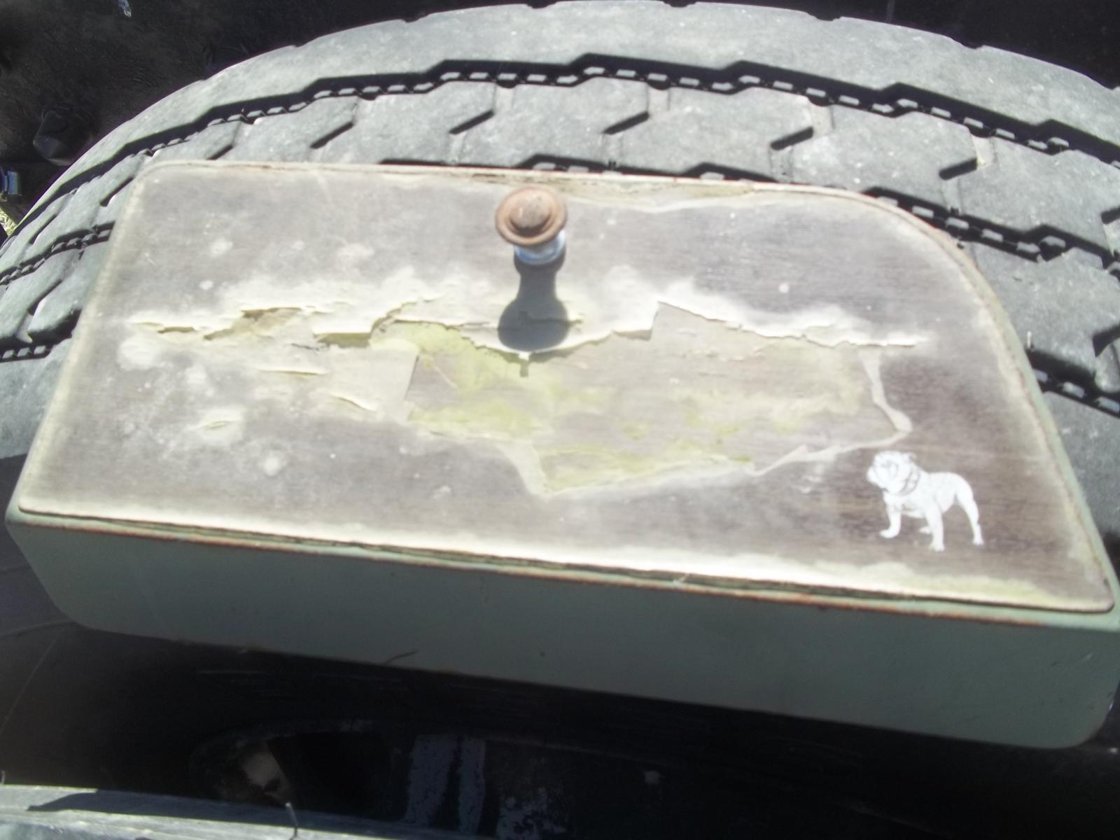

From my experience once you start to sand (dry sand!) clear coat you should keep thin skin of it.
Otherwise sanding wood it became its original light color. Like common plywood.
You have two options - keep some clear coat and when you re-coat it you still have some cracks and damages seen.
Or you "grind" off the surface completely and than tone the wood with some paint or acid trying to get the correct look.
Than overcoat it. By the word a two-component clear coat for body repair works perfect.
Seeing you glove box door I think you can only cut off the sliced clear coat only, maybe sand the edges a bit and than overspray it as is.
Or restore completely with total sand/tone and making new dog.
Better to bring it to a resto shop and it will be costy.

I didn't think of the epoxy but that could also work I was thinking get the old flaky stuff off and fine sand it down the edges than re-clear coat building up in the area that de-laminated but that epoxy probably would work also, not sure how you could control the thickness and running off the edge.

Feather edge the clear as best as you can and apply very thin coats of whatever you choose. When you have a hard line and put a thick coat of something over top of it it tends to lift and crinkle. The solvents in the top coat eat the old finish. Multiple Very thin coats would be the way to go. You could always get the bulldog remade and then sand/strip the entire facedown to the veneer, re apply new bulldog, then top coat.
