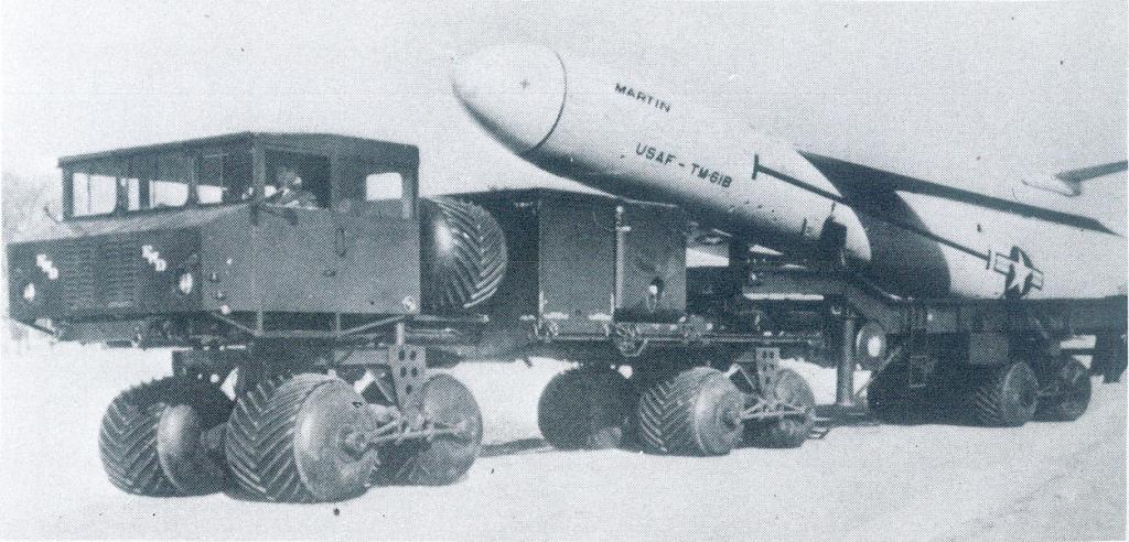

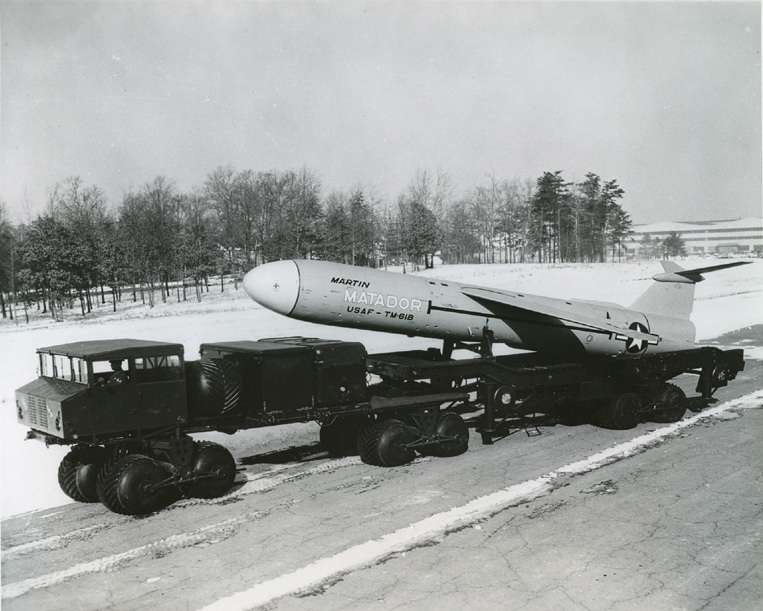

The final drive system is a planetary drive off a transfer case to a live axle with wide hard rubber drive wheels that contact the actual tires which are filled with air, and individually controlled from the operators console. The air pressure in the "floats" not only carries the load… it also controls drive tension on each tire. The planetary drive powers each boogie at the steering pivot points. Steering is by "Orbital Control using hydraulic rams. Transmission is an Allison 740. It can easily go through 22 inches of snow or 40 inches of water and on a smooth surface hit 30 m.p.h.
FWD produced several different Teracruzers.
This is a Model 8-320 B. It used a PE 200 "Continental Packett" 4-cycle 8-cylinder opposed piston air-cooled engine developing 250 horsepower at 2,800rpm.
An Allison TX-340 semi-automatic 4-speed transmission drove the two bogies thru an FWD-built central differential.
The air pressure of the 40x42 inch Goodyear Terra-Tires could be adjusted between 3 and 18 psi from within the cab.
Cruise speed was 40mph, and it could climb a 60 percent slope at 2.5mph.
It was designed to pull a missile trailer carrying a 40 foot long Martin TM-61 Matador land-based missile which operated at 35,000 feet and 650 mph, or the Martin TM-76 Mace.

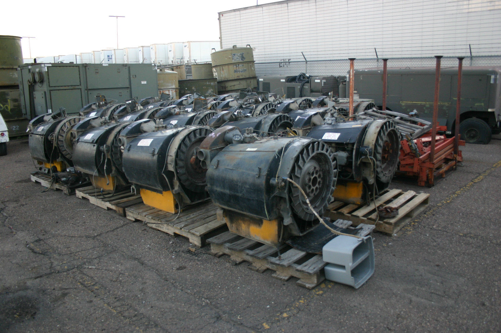

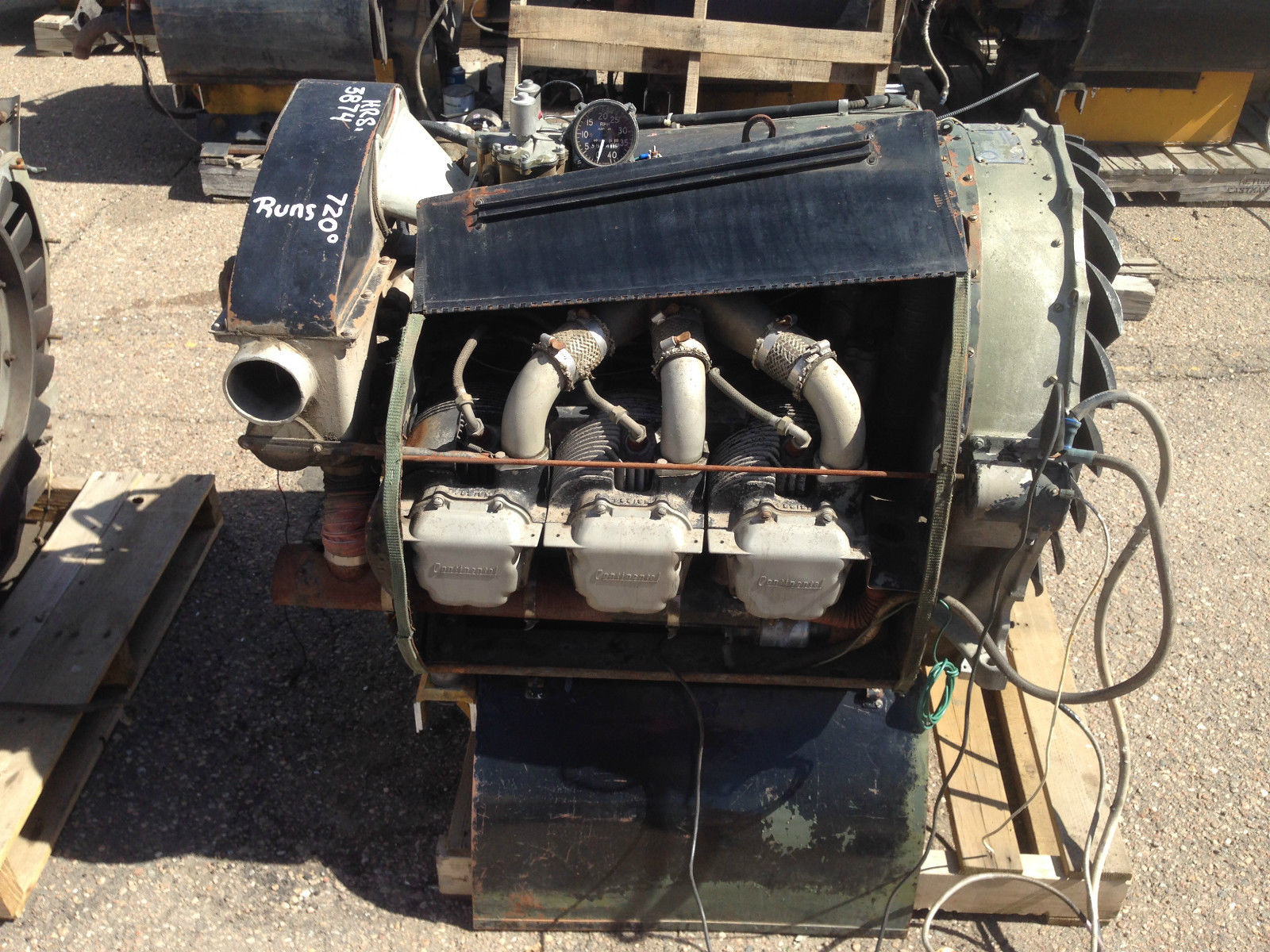

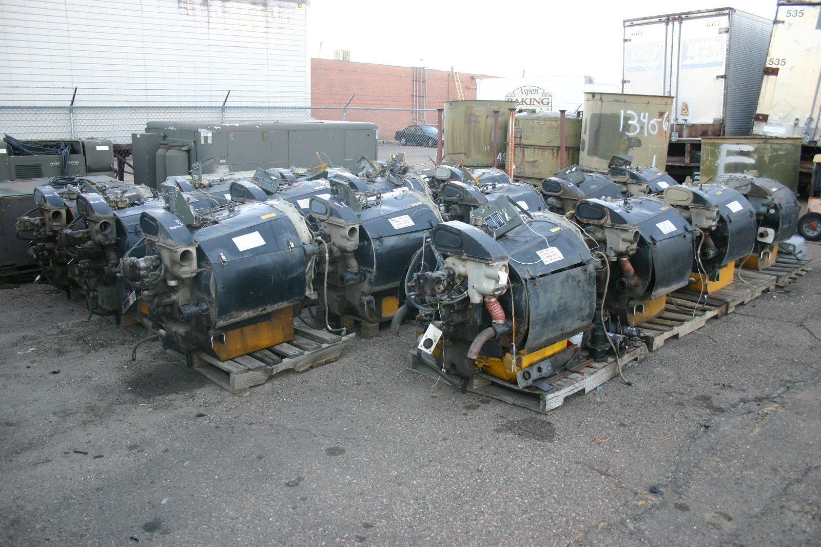

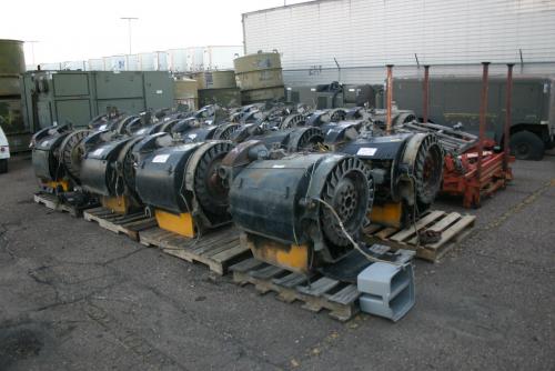

Got to make it air cooled. They ran a Continental Packette air cooled 6 cylinder opposed gassers. They were USAF ground power, light Air Craft engines (PIPER etc) and Heavy Air Craft tow tug power units. Paul

Picture one with a swapped in Deutz air cooleed V-8!!
