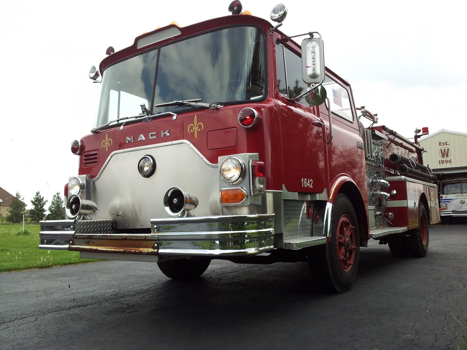

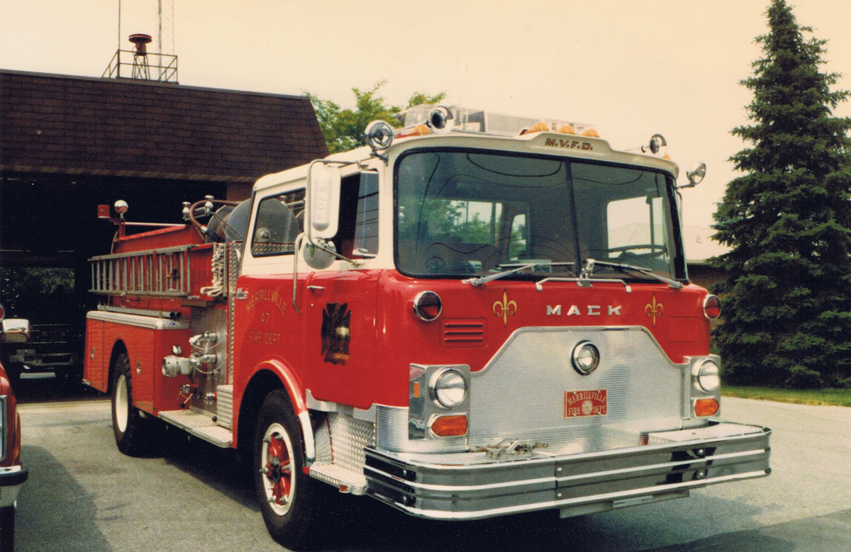

This is a pitcure of it a few weeks ago after I cleaned and polished the paint, as well as the delivery picture:

IndianaFireman.....Looks great.....Hope the paint works out for you. Let us know what you end up using..... I have some diamond plate to paint as well. On a different note who's bringing their fire truck to Macungie? I would like to try and make it....for the first time....Thanks...

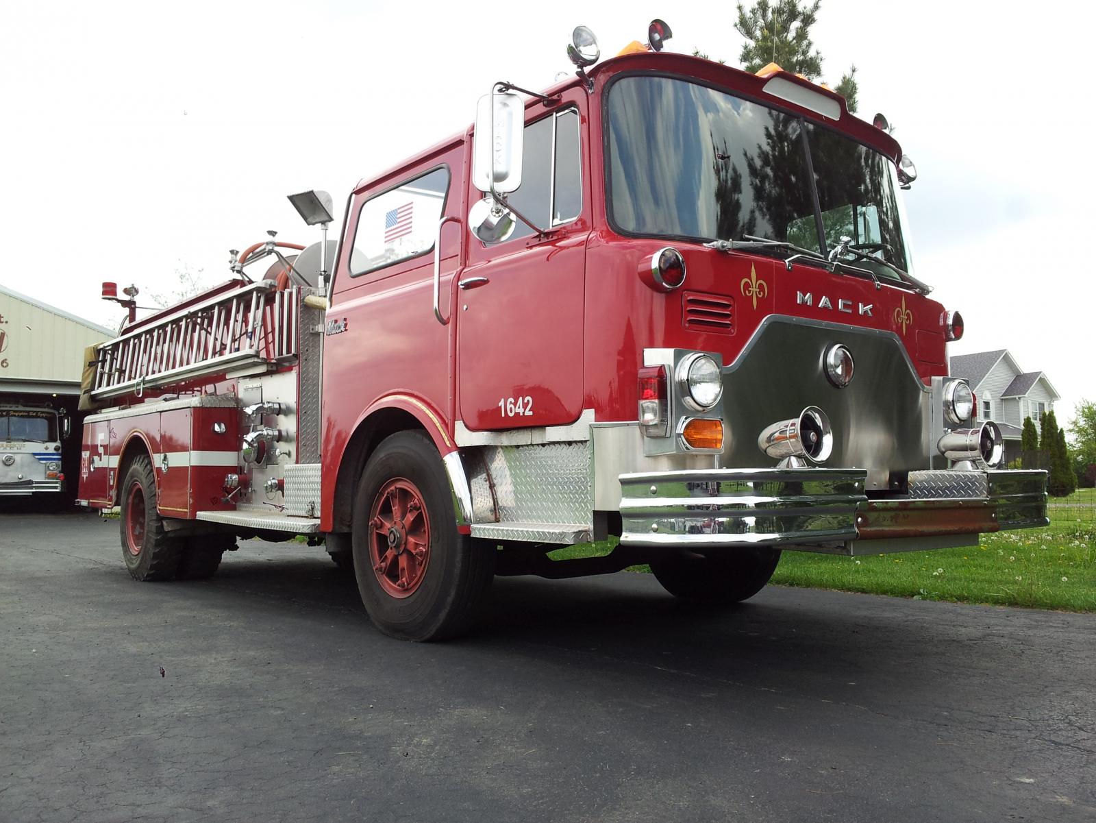

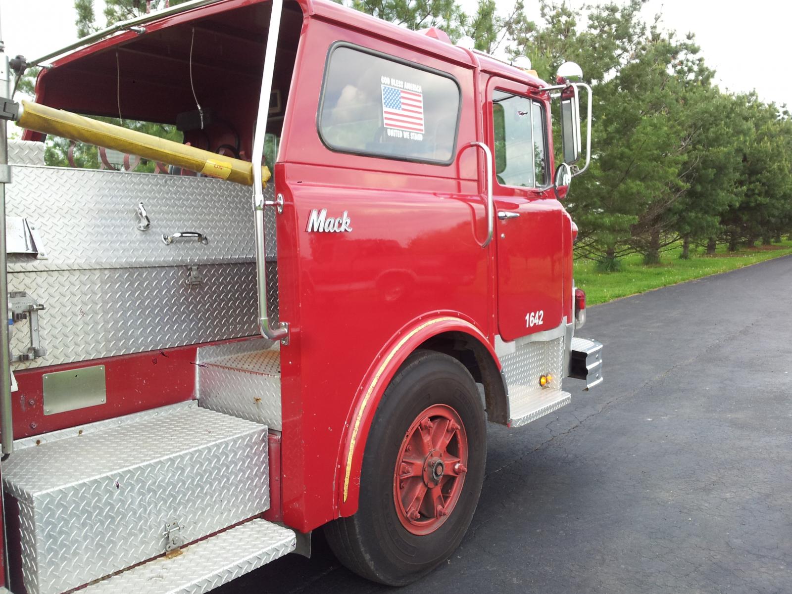

The only steel I see in those photos are the front bumper and foot plate right in front of the rear jump seat. Everything else on that truck is like my CF, alumininum. Try fire chiefs friend, just keep it off the paint.
The front bumper is chromed steel, but the sides are just plain steel. They're magnetic, so they're not aluminum. I've tried Shield Solutions acid, which I believe is the same thing. I bought some Rust-O-Leum over the weekend, so I'll try that when I get a chance. Thanks for all the advice!
That looks like aluminum on your side steps (I can tell by the sharp edged diamonds in the pattern) and steel (smooth edged squared off diamonds) under the jump seats....aluminum can be buffed (will be hard on the buffing pad) and the steel needs silver paint. We used to mask off the red and apply the paint with a rag .....sponge brush might work as well..
