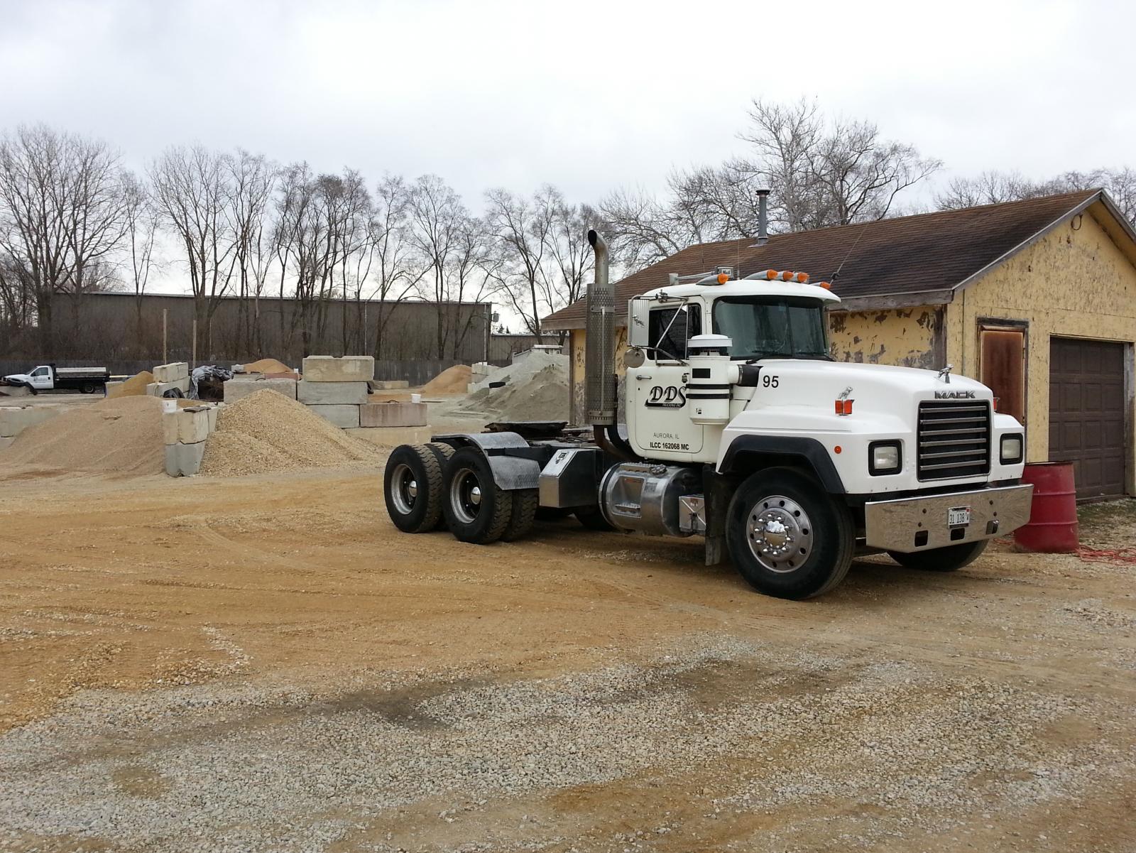

For example, i have a 95 mack rd 350 mechanical single frame, eaton 9 speed, 442 rears, 2 aluminum wheels and 6 steel wheels. I am trying to find out empty weights and how they differ. All i know is that they vary from 14000 to 17000? So how do i find out what that weight was from mack?
I think the r model tends to be heavier because of the steel doors and cab right? A guy i work with just got a used EAST trailer with liner in it and he is around 27000 empty. We have the exact same spec'd truck. I weigh 28860 with full fuel and everything at max, with barely anything, i am lucky to achieve an empty weight of 28100 to 28200. The trailer i use is a 1980 fruehauf tub that was rebuilt to be more heavy duty. the inside of the box has more bulk on the sides and i also have a 1/8 inch steel floor from the doghouse to the trailer. it's quite a nice setup as far as being durable.
I guess i was just wondering all this because I can see myself driving this truck for quite awhile , and lets say if i put aluminum wheels on my truck and when i was ready to sell my trailer and get a used lightweight with a liner in it, could i be 27000 or less? Or is the R model just TOO heavy because i am an R model guy for life!

Here is a picture of my heavy ass truck

The Rs seem to be a bit lighter, maybe a couple hundred pounds, than the CHs and CXs. Back when I worked for the Postal Service I had the chance to weight our different Mack models on a certified scale. The lightest tandem was the '99 CH600 with E7, Allison 5 speed automatic, steel wheels, 40k Eaton axles on Hendrickson air ride, and starter, and a single 60 gallon fuel tank- at the end of the shift with maybe 40 gallons in the tank and an overfed driver in the cab it weighted only 16,200 pounds. A more normal 100 gallons of fuel would have pushed that up to around 17,000 pounds, but with aluminum wheels and super singles 16,000 pounds would be possible. Get radical with a 6x2 and a few other options and a 15,000 pound empty weight would be possible...
Yes you can! Your trailer is going to be heavier because the steel floor and spoke wheels. The newer trailers are lighter due to many different things, that being said, the old Axle's, Heil's, and Fruehauf's were lite weight. If you get into a newer aluminum trailer you can realistically get down around 27000. The RD I run weighs in at 17600 full of fuel, wetkit, tool box full of straps and edge protecters, and all aluminum wheels/tanks. Hope I helped you. -Brad
Agreed, trucks vary too much for anyone to tell you what it weighs, just run it to the scale bobtail and get a weight then you can subtract it from your combo weight and see what your trailer actually weighs. I would guess you were close to 1700, my 84 Superliner daycab was a V8 12spd truck with double frame and 44 rears, had all aluminum wheels and tanks but weighed 19100. My 85 sleeper truck has a V8 and an Eaton 9 spd double frame and 44 rears with all aluminum wheels and tanks and weighs 18,900. I had one 97 R model triaxle dump that was all spokes and a steel bed that was 28400 and a 2000 R with the same specs but all aluminum wheels and a thinner bed that was only 24400. Point being they vary a lot any two are never the same even built as twins, they can be close but one will be heavier, run her to the scale real quick and you'll know. As for aluminum wheels from spokes you will get cast hubs for 44 rears and then with all aluminum wheels my math says you'll lose about 360#. Lightweight aluminum alcoas are about 20-30# lighter than a 24.5 steel rim, hub piloted cast hubs are around 30-40# lighter than 44k spoke hubs so that's 120-160# in hubs and 160-200# in wheels for a total of 280-360#. A big bonus to swapping is making brake a seal changes a lot easier, no more dealing with that heavy spoke hub and swapping brake shoes can be done in minutes without removing the hub.
