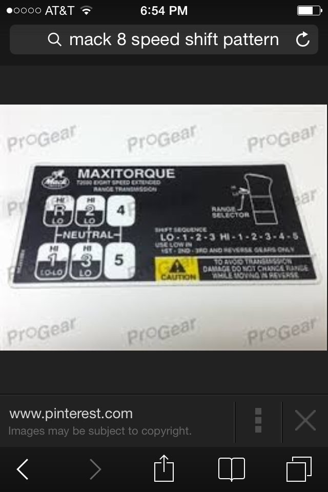

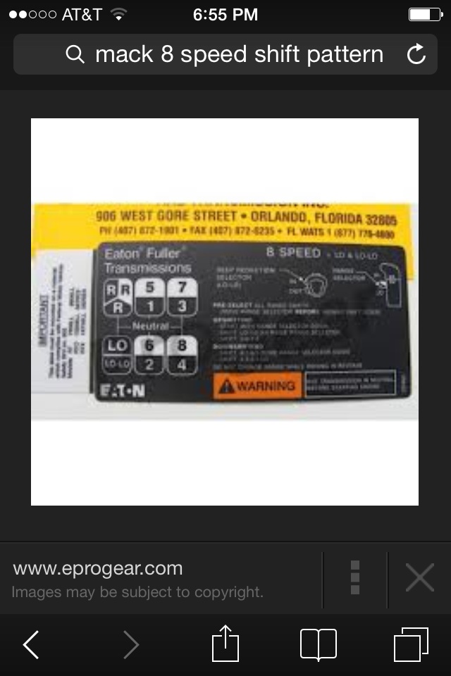

  3. this is a 8ll and a Mack 8 speed
  4. Is it 1,2,3, in low then 1,2,3,4,5 in direct that's how the 8 speed Mack that I have seen shift
