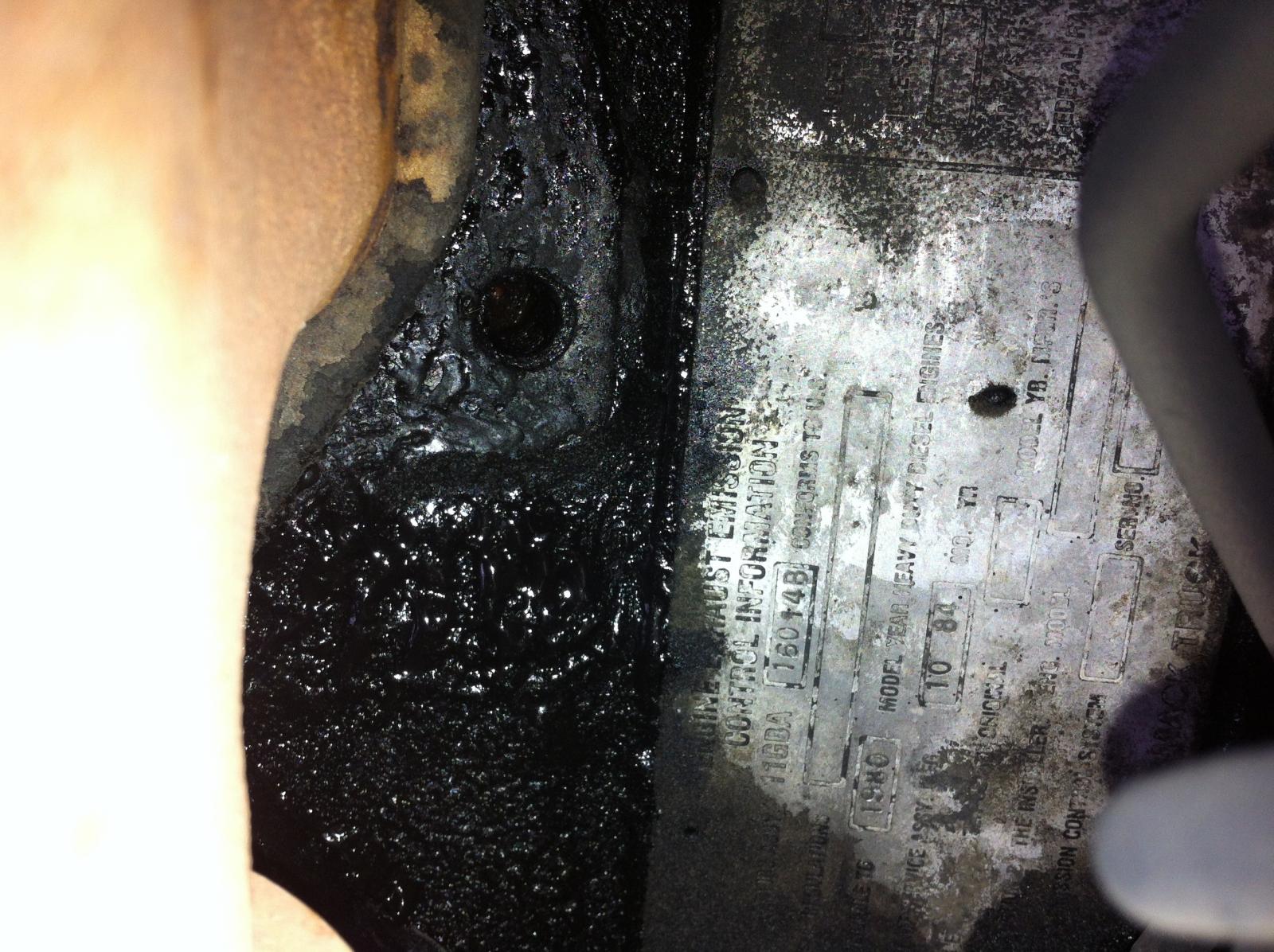

  1. something eles is the truck info on the cab sticker says it is a maxidyne engine, but the vavle cover says thermodyne engine on it maybe some one swap out the covers off another engine,
  2. yea it is a 237 but the truck is a 1977 model and the engine is a 84, just wanted to know if some one could tell me anything eles, it pulls and runs really good for what it is.

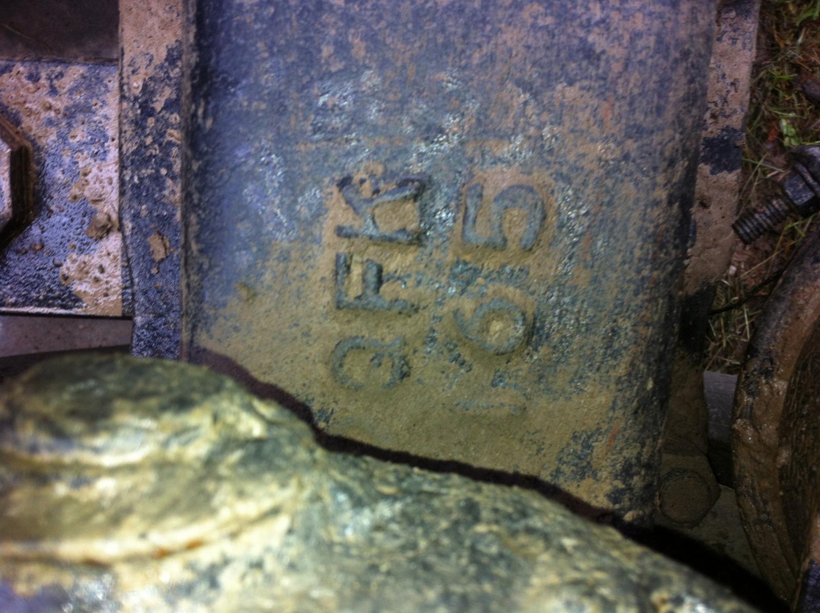

  3. I thank it is 55 rears here is a pic of the rears

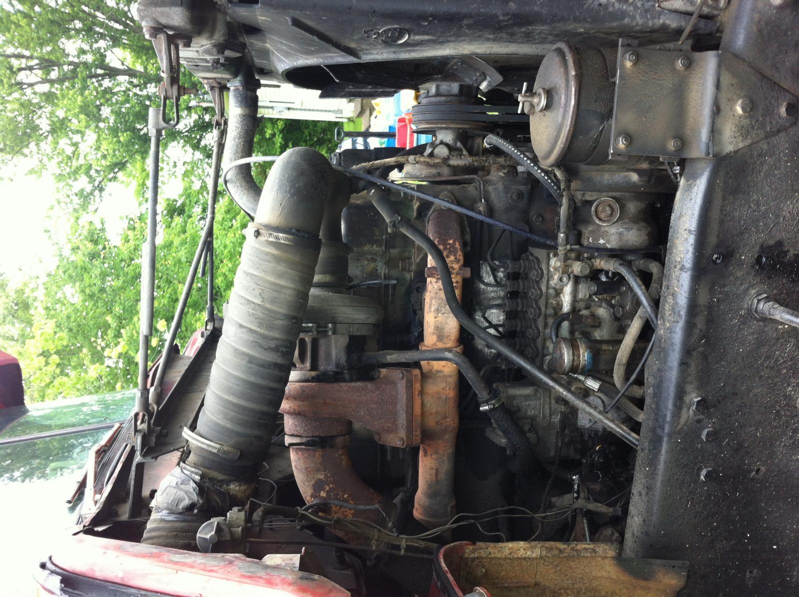

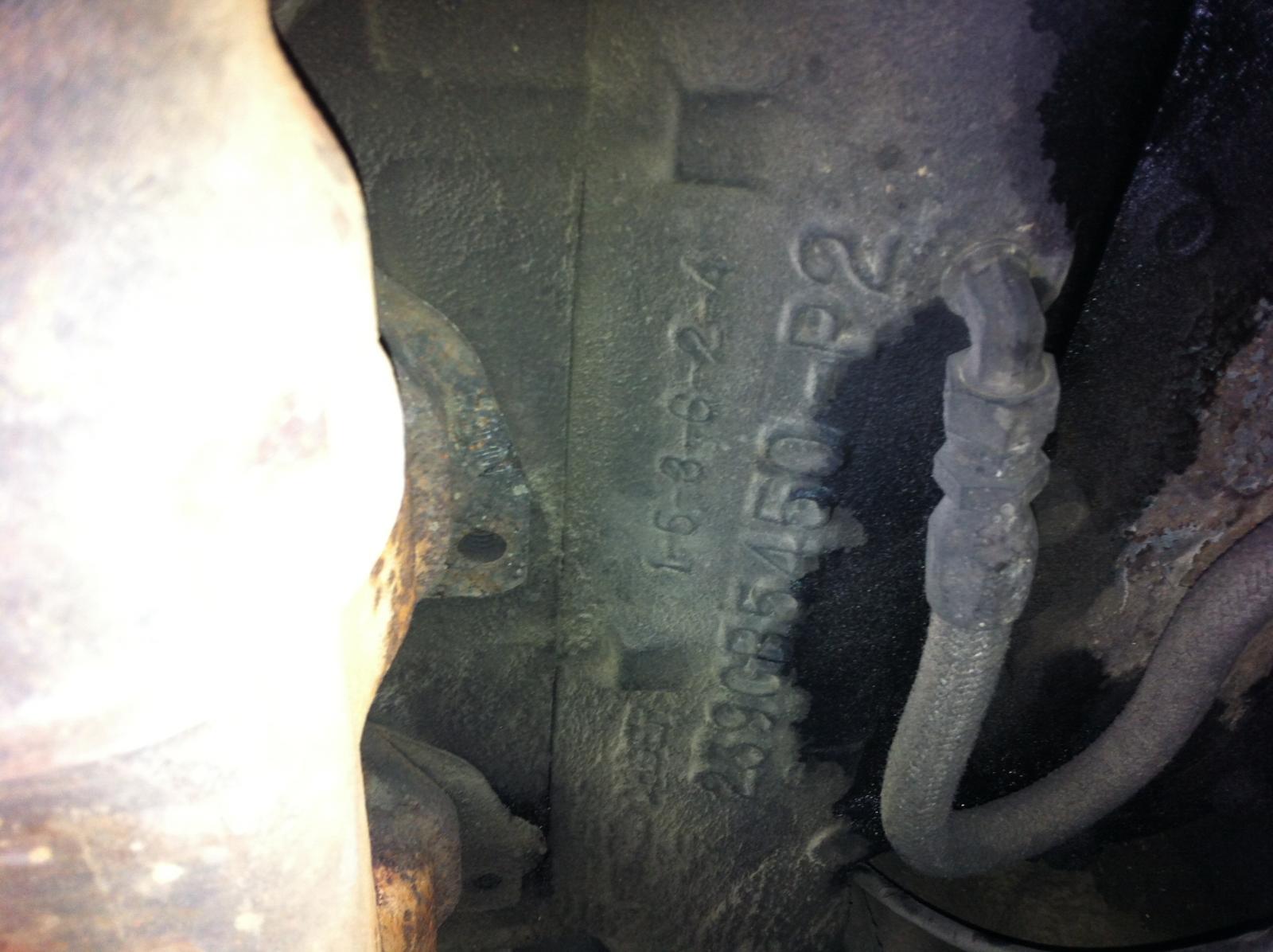

  4. What does the letters and the 65 mean on the rear end housing I figured I would post some pics of the engine to if anyone can tell me what I have I would love to know any info you all can give me
