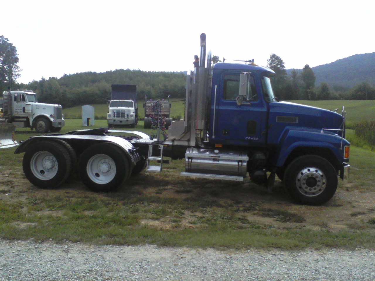

  16. Name: mack ch 613 (1998) Date Added: 04 September 2012 - 11:41 AM Owner: oilburner Short Description: day cab ch 613 View Vehicle
  17. Hey everyone this is my frist post and i was wordering if my 98 e7 454 has a problem or not. If you start it up frist thing in the morning it runs rough and smokes white for about 30 or 40 secounds and has no throtle respones, but it will run like this for just a bit and then runs fine, untill you cut it off and go back to start it again, when it is warm it only does this for about 20 secounds or so a little less than when it is cold, no is this normaly or a developing problem that will leave me on the side of the road, no other than that it runs fine it had a leak in the primer pump and i thougth it was letting the fuel drine back but replaced it and the truck still does the same thing, this is the frist e 7 i have had so what do you all think?
  18. Hello everone my name is eddie, and i live in south eastern kentucky, The truck i drive is a 1998 ch 613 with a forward front axle, i mostly work in the gas and oil fields here in ky and tn but also help a buddy that logs as well. This is the frist all mack truck i have ever drove, with a 454 e7 engine and a 13 speed maxi touqe trans and 44 mack rears on camel backs with 4.17 rears. I can't wait to see what kind of service this truck gives in the rough working conditions of the oil and gas fields of old kentucky, i will keep you all posted thanks
