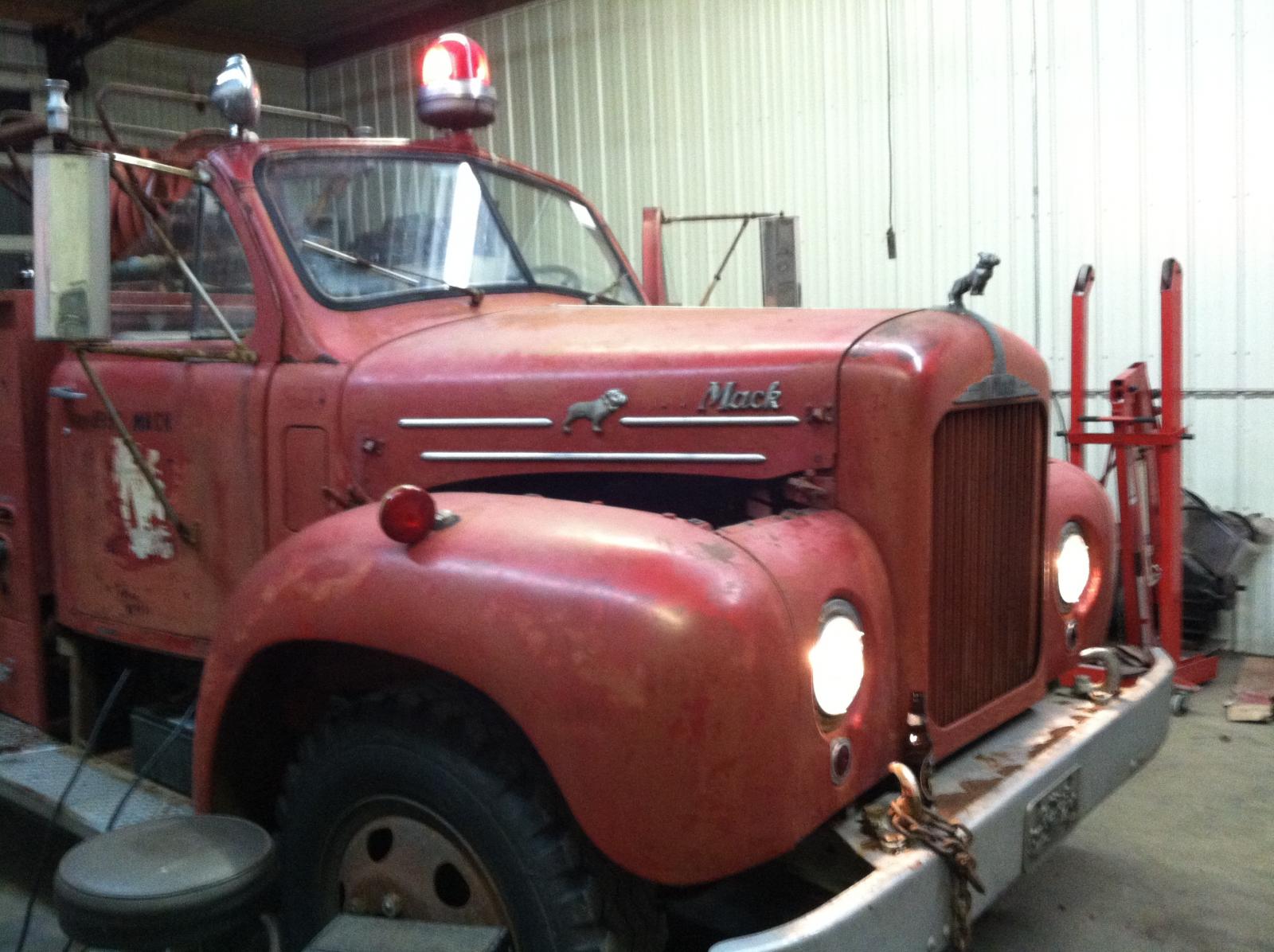

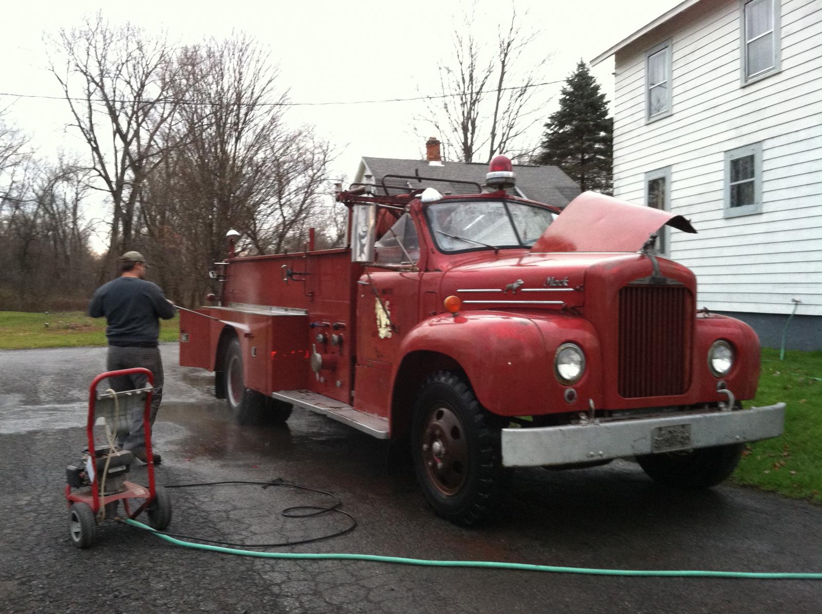

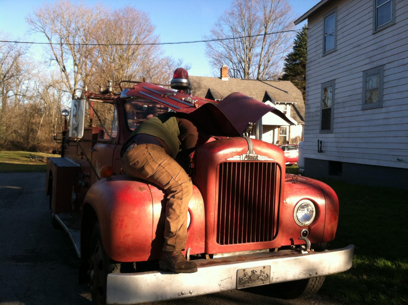

yup, first fire truck i have done, not first B model. hopefully wont be too challenging although every piece of fire equipment has been stripped off of it except the light.

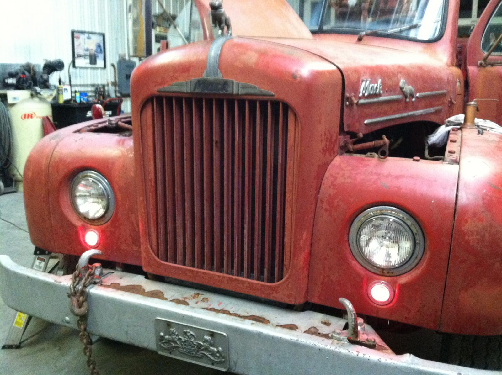

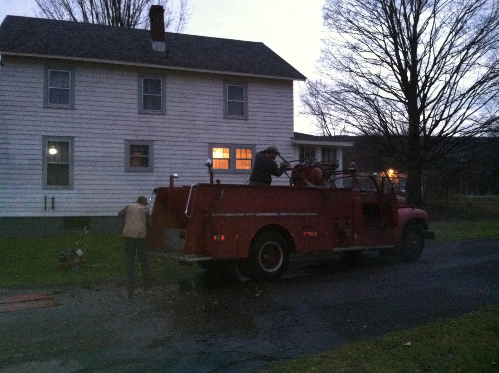

In the pictures it looks like there is a lot of fire equipment left on the truck. You're missing the ladders, but the brackets are still there. The steamer caps are still there. They are usually the first thing to go. You have a booster real, hard suction, rear spot lights. You even still have the red lenses in the parking lights. I would think they would be hard to find. The compartments are almost always empty even if you buy the truck right out of service from the fire house. It looks like a good start on a unique truck. What is the serial number?

Good luck putting it back together. If you need some help finding the equipment you are looking for send me a PM. Stay away from EBay to buy the items; they are generally much more expensive than you can find them elsewhere. Your best bet is to go to one of the flea markets such as the Spring Melt held in April in Allentown, PA.
Mack used very specific brackets and mounts that are unique to Mack. If you want to keep the original look and not drill new holes you will need to locate those items. If you are unfamiliar with the correct mounts try to check out a complete rig such as FireMack's Radnor B Model.
Most fire truck restorers try to keep the tools and extinguishers period correct. For example the soda-acid extinguishers you used to find in a building were never used on apparatus.

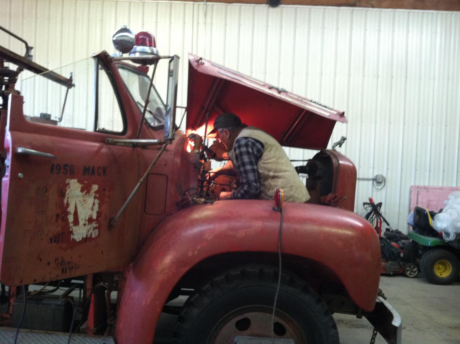

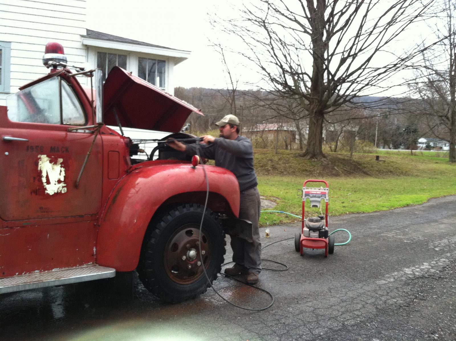

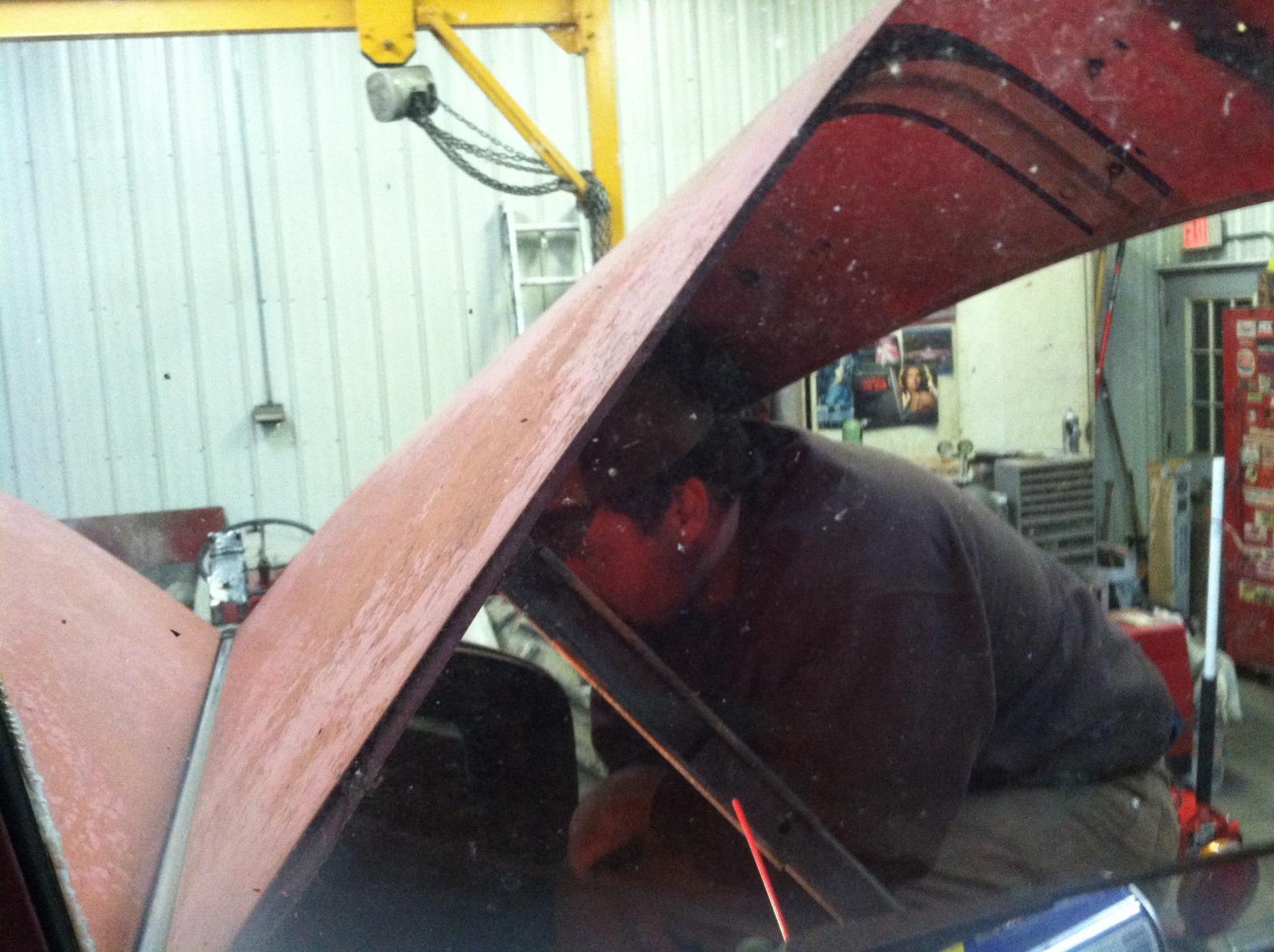

haha we took my Silverado along to Otherdog as the firetruck doesnt run and needed to be towed on the trailer.i also brought extra antifreeze, oil, blockin, chains, binders and a jack for the ride. good thing as we had to jack the front end of firetruck up and put on blocks to get the front bumper over the gooseneck. i wanted the rear tires off the rear tires of the trailer. all in all an uneventful trip which was good except for a few slooooooooooow hills. the old thermodyne doesnt like those 10 mile hills in Pa with no turbo. also cants exactly hotrod down one hill and up another in Pa cause there is always a 6'' bump at the bottom you have to slow down for and lose your momentum. only got tailgated by a Pa state trooper once and his only concern was gettin the hell around me at 430 pm. must have been shift change haha. workin on gettin it runnin this week. had to order two new sets of points and condensor as they were junk along with the 3 sets in the glovebox. gotta work on the spark plug wires as they are generic and totally junk but hopefully enough to get it running. wanna see how good it runs before i put too much money into it as the Hemi spark plug wire sets are outrageously priced. if its a pos engine i can always put the 413 in it that came from my B613 with a baby quad haha. never know, 2 sticks in a B Mack firetruck?
