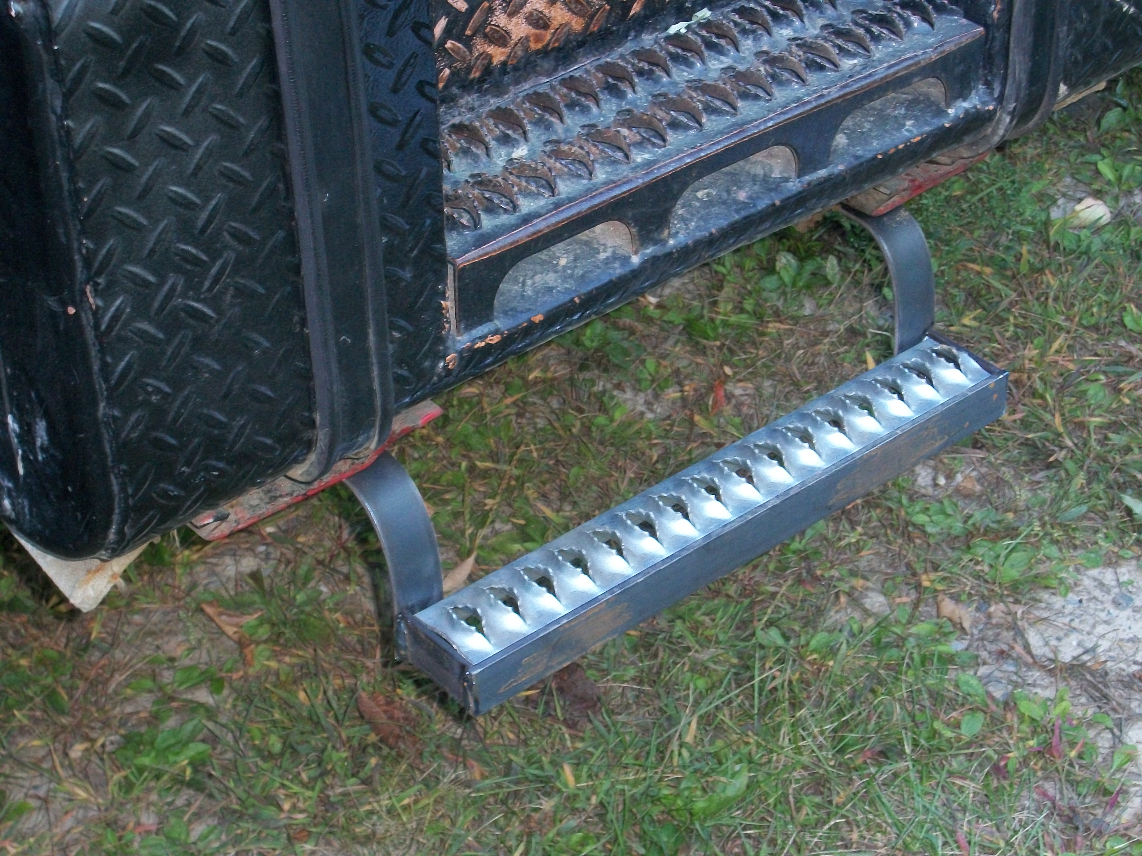

Does anyone know if the rubber channel that goes around the square steel step fuel tank straps is still available? In addition to B models I believe the tanks were also offered on R and U models. If no longer available, any other options?

post-1625-072388200 1285726138_thumb.jpgGuys-thx for all your suggestions. Just for kicks I'm going to try the local Mack outlet. I probably should call Watts but they don't list it in their online catalog.
