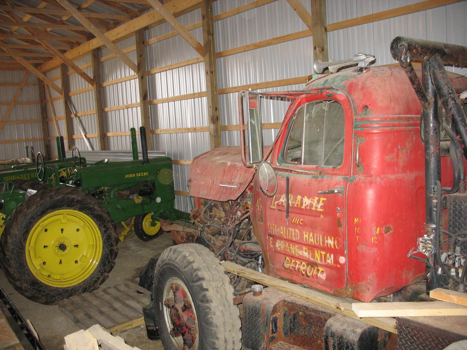

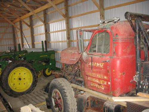

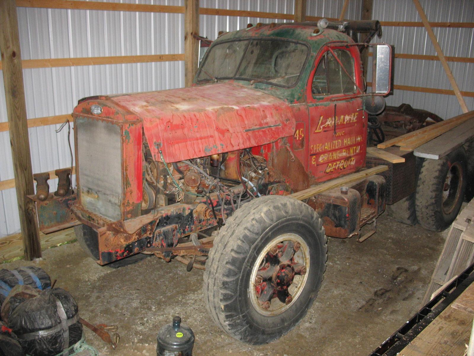

  3. I have a B 83 SX ,220 Cummings quad, power steering, Truck is rough but savable . Hasn't run in two years. I think a 100k fifth wheel. No title $2000 offer. Delivery possible 513 889 7777.

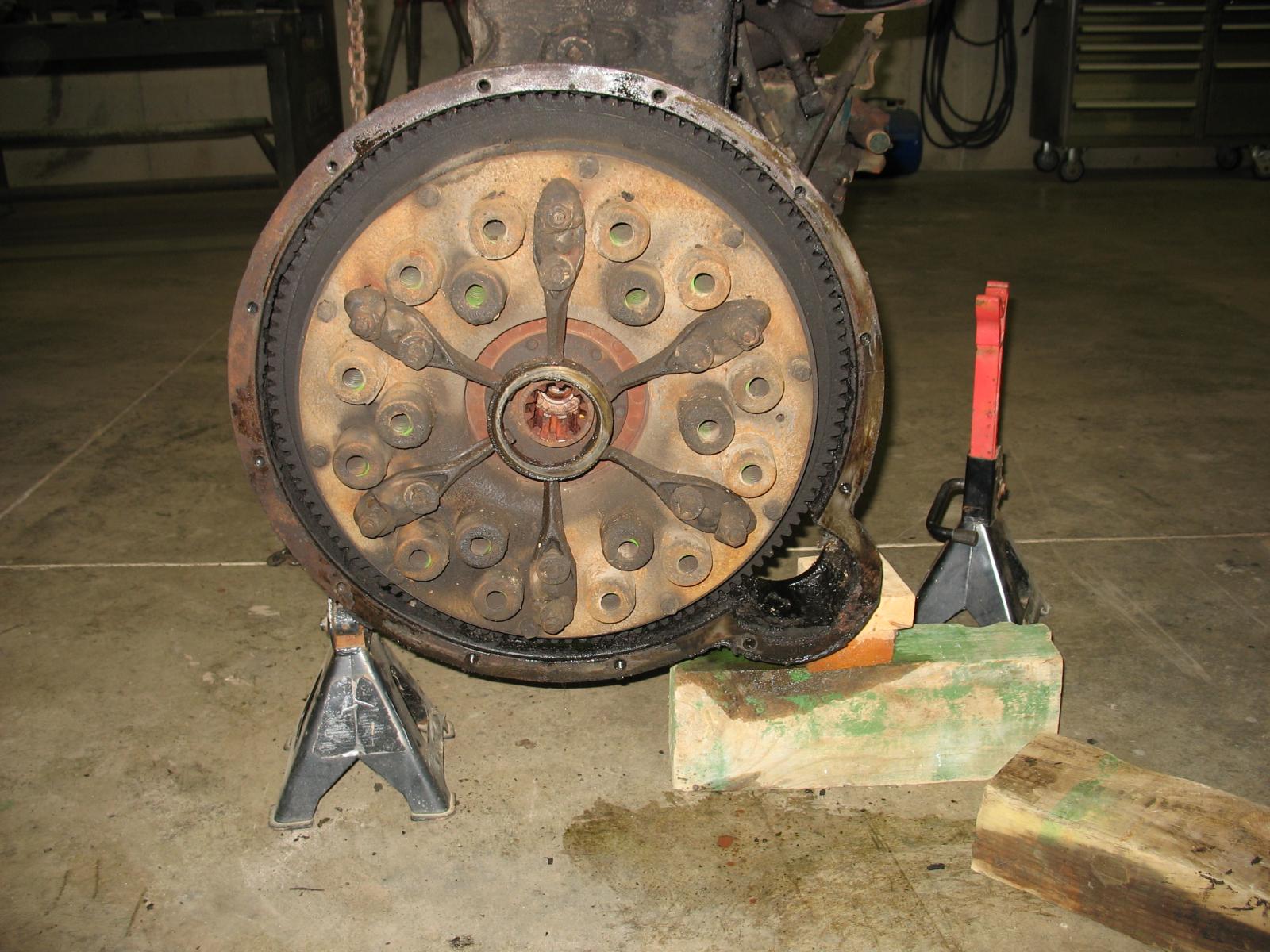

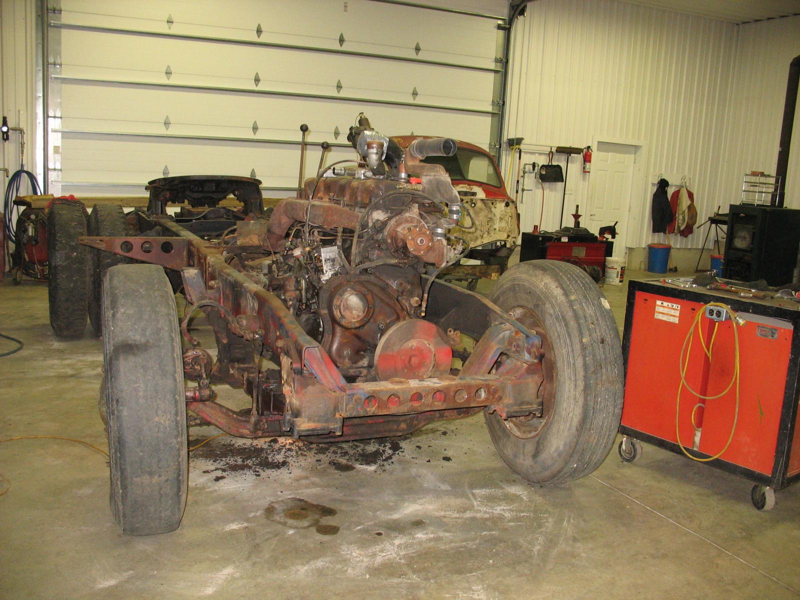

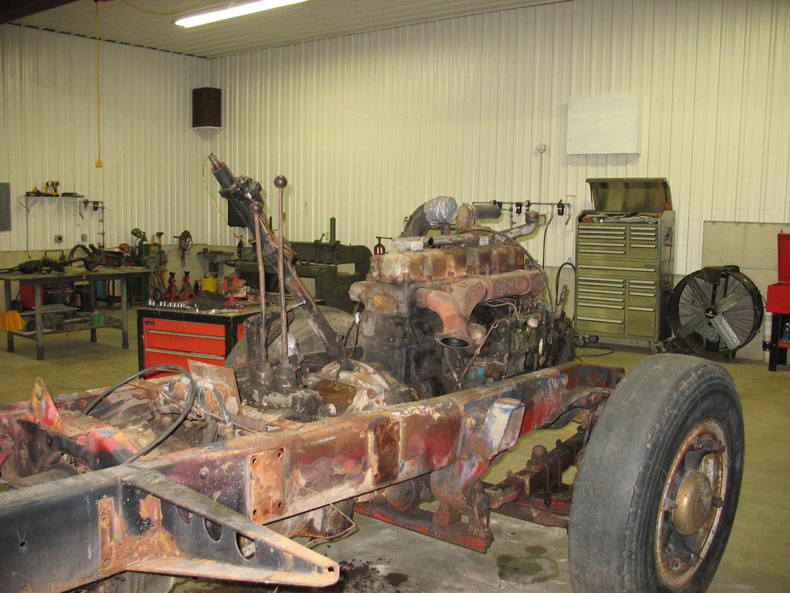

  13. I want to remove the clutch from my B 61 but have a question. The service manual reads " Use three spring retention tools ( 17- T-1123 or retaining cups ) when removing assembly" . Just can not figure this out looks like every other clutch I have worked on. Thanks for any advise.

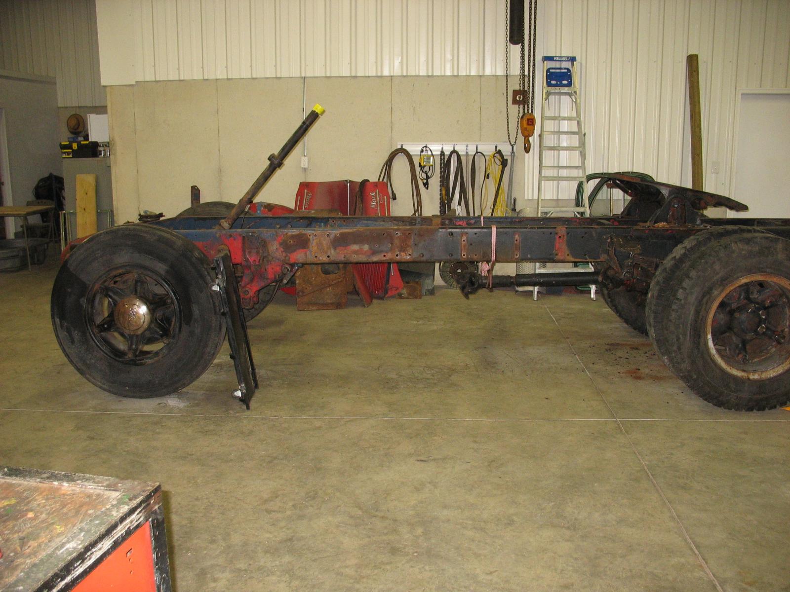

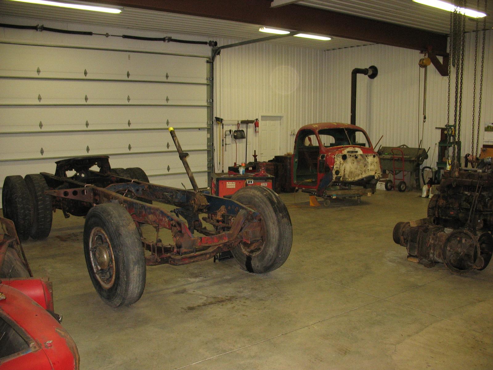

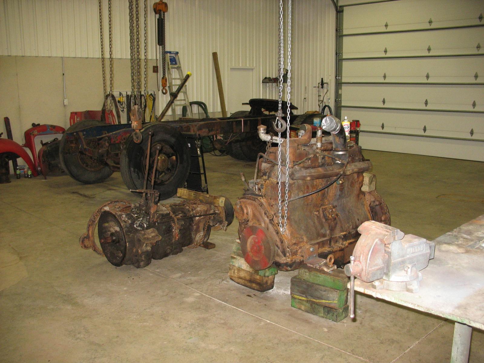

  14. Thanks everyone for the advise. It makes sense to pull the engine and trans at this point. The size of this is somewhat overwhelming. I think I will split it and pull as two separate units. I have some concerns on line up on reassembly but will deal with that when the time comes.

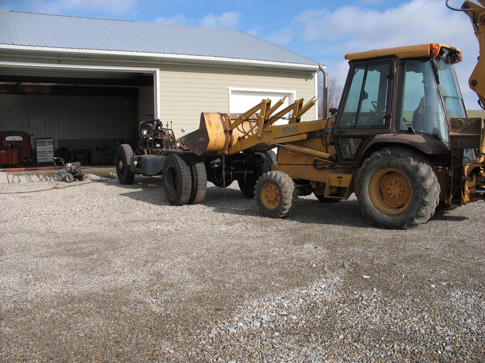

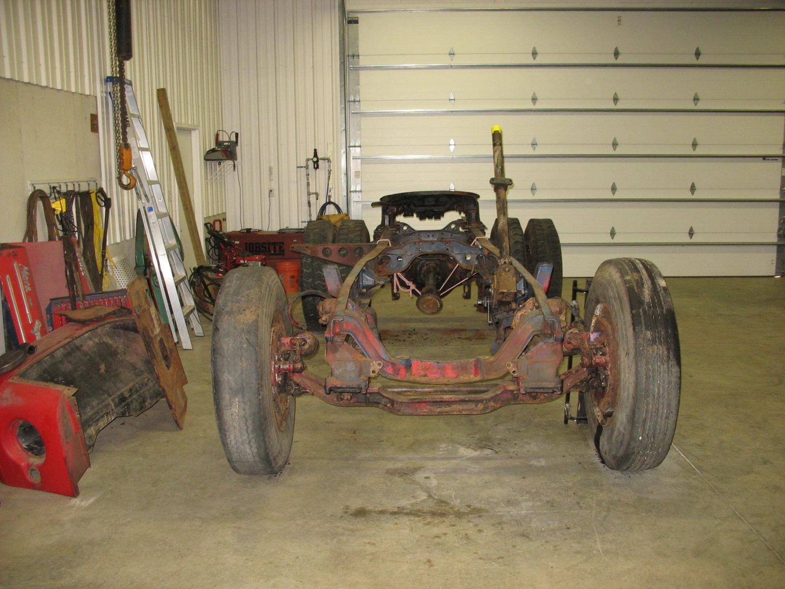

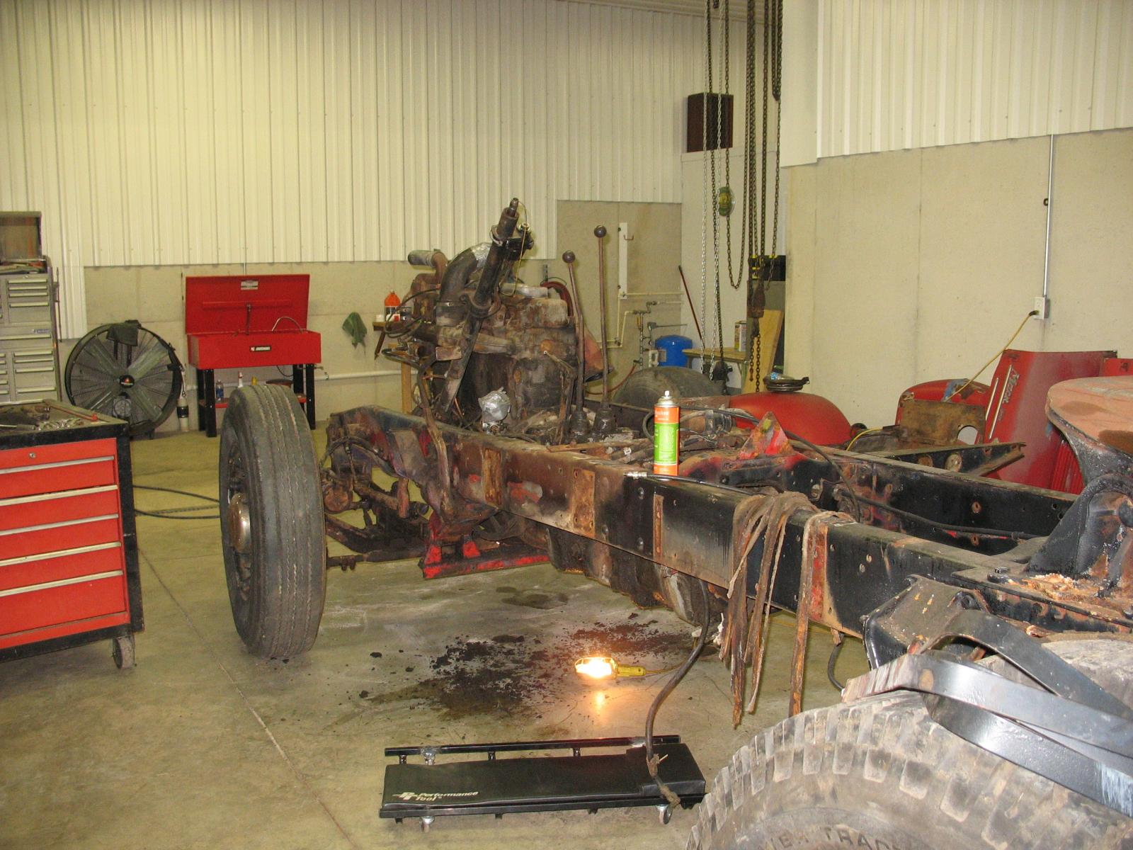

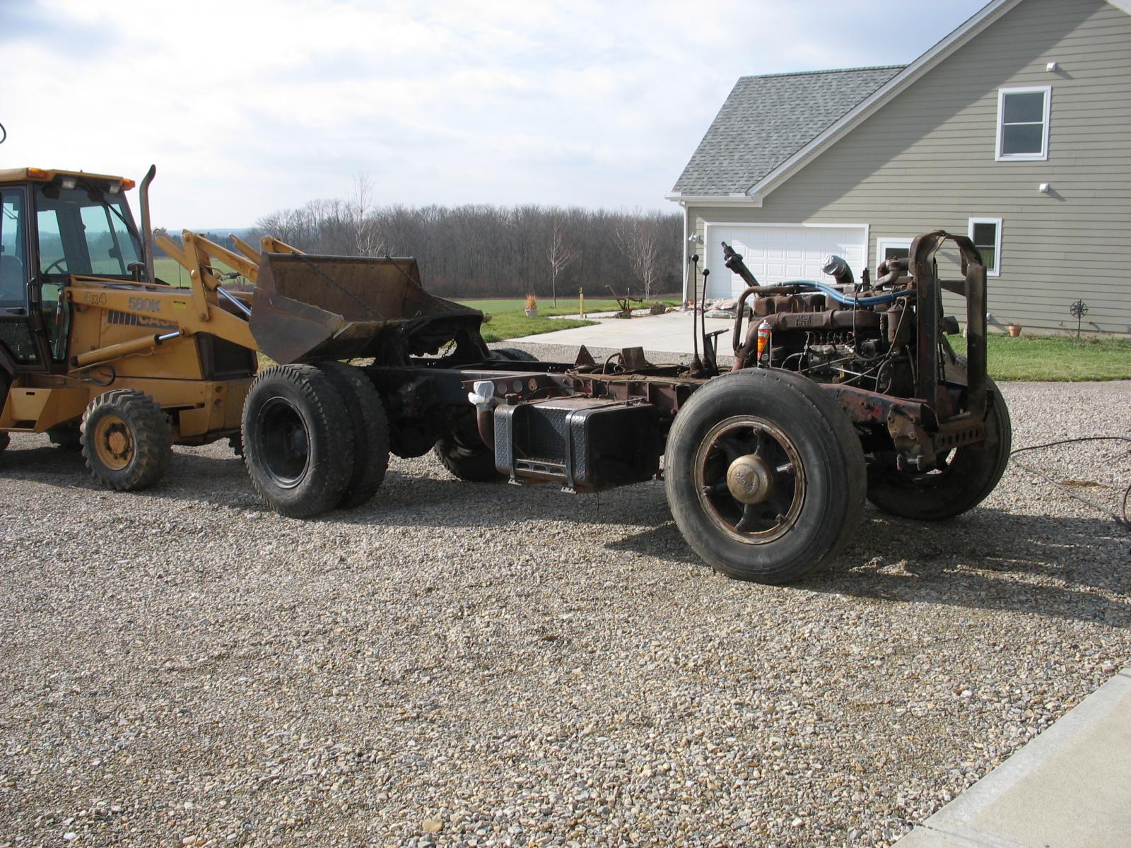

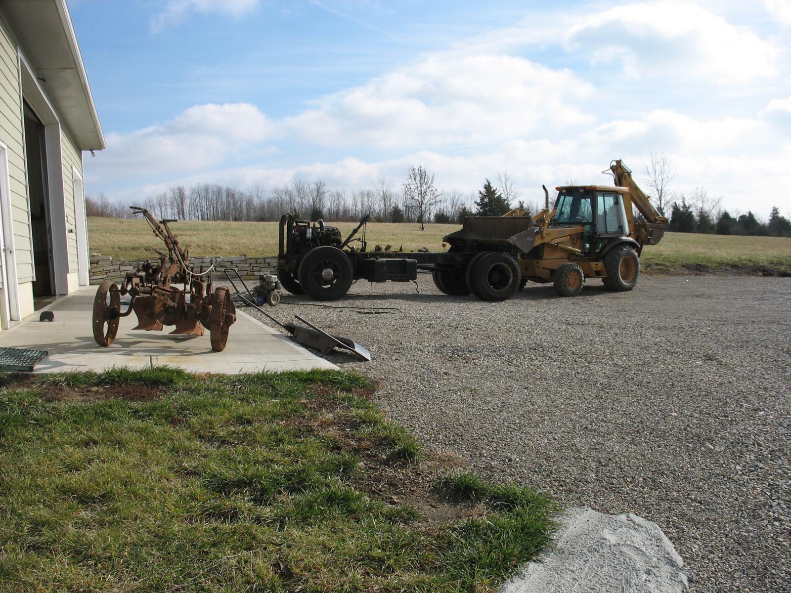

  15. Had planed to stop disassembly at this point to clean and paint frame. The truck was used to pull an asphalt tanker and spread it. It has asphalt and gravel almost every where. Had about 2" on the springs which I got off . The inside of the frame is packed in places. I plan to change motor mounts. Thought about pulling the engine and trans as a unit to clean. Can this be done or would it be better to split. Where and are best places to lift from ?

  18. Pulled the truck out to pressure wash. Most likely last sunny and warm day for a while.
