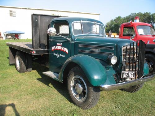

  2. Great pictures. The suburban looks clean.

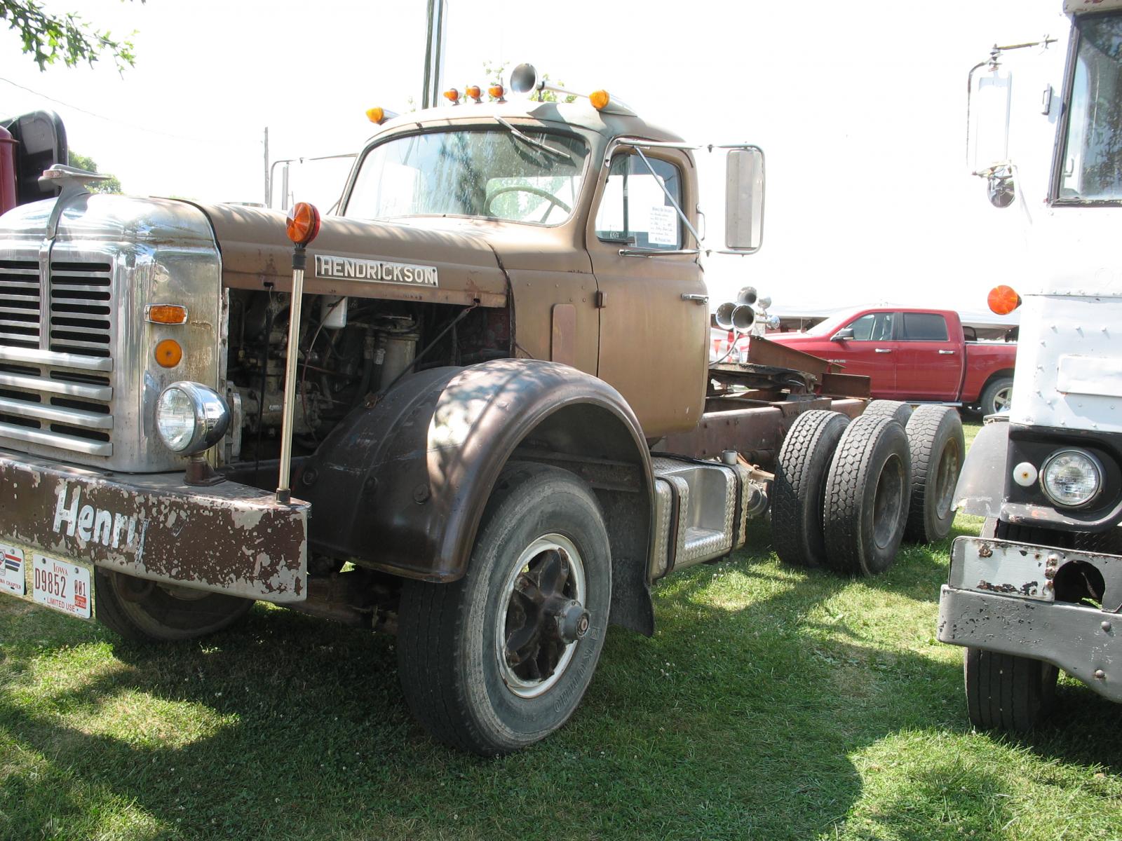

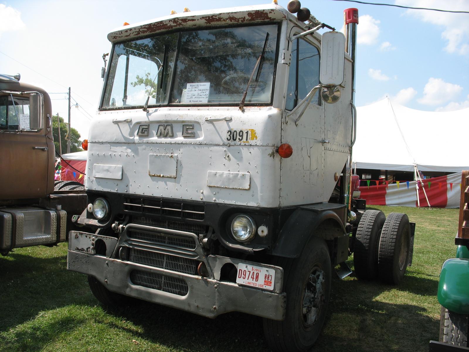

  3. Great pictures. Thanks for sharing. May try to attend this show next year.
