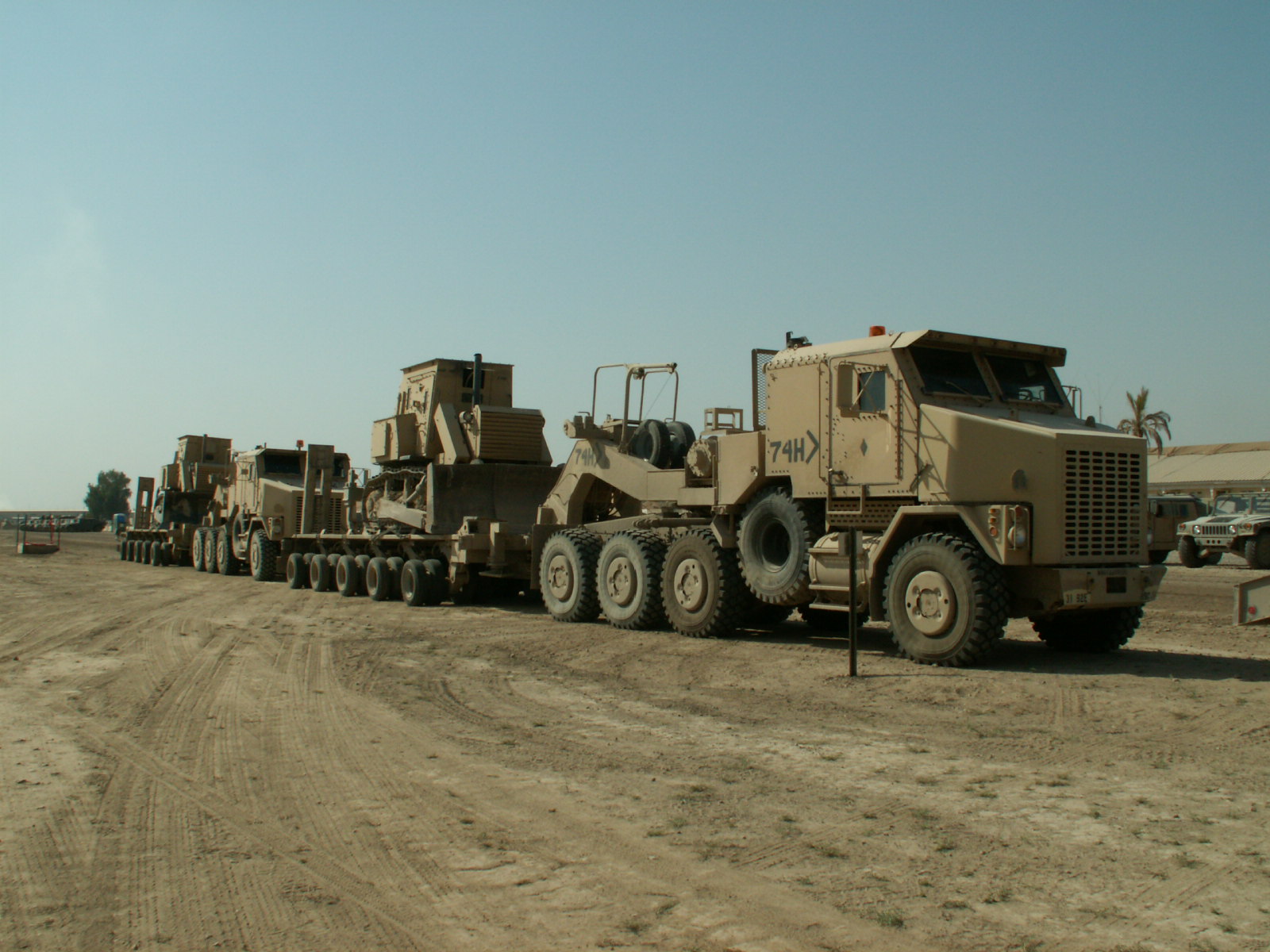

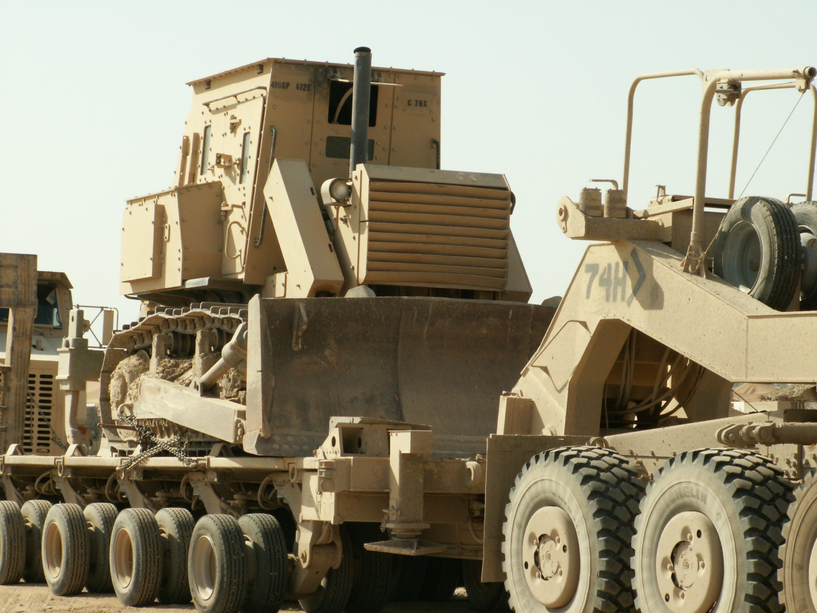

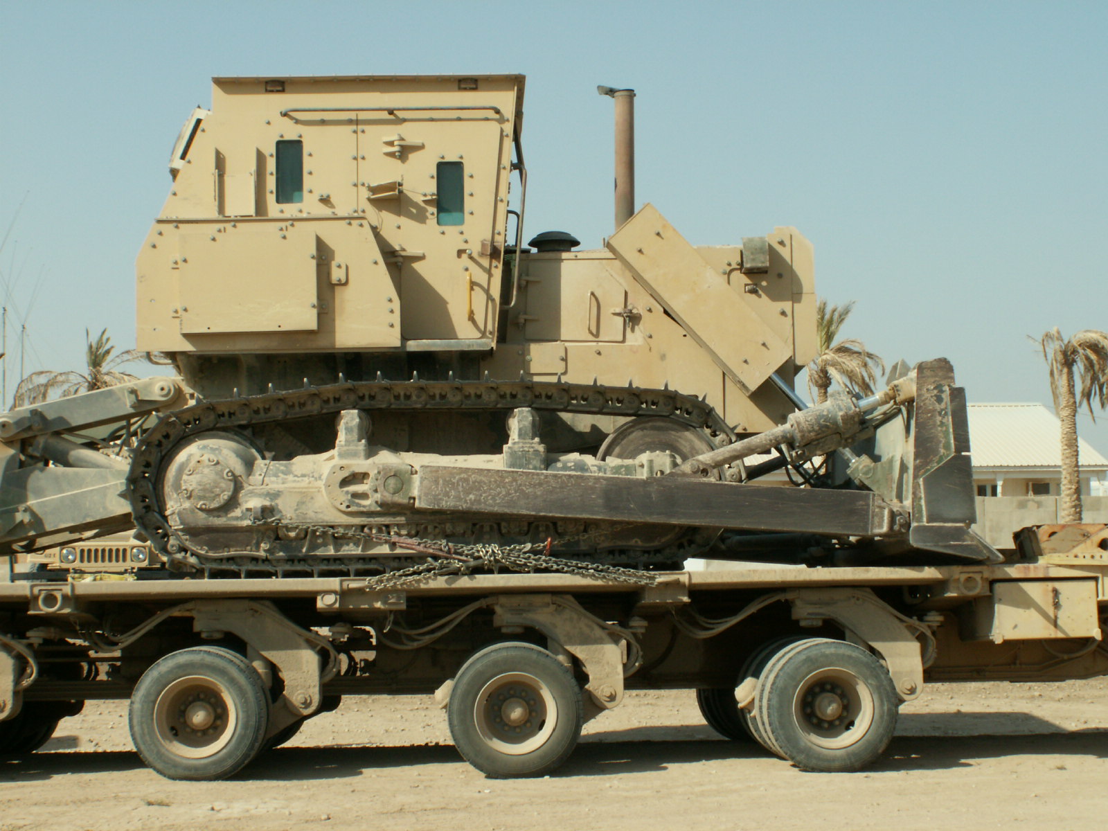

  19. Here are a couple of big horses waiting for action- fall of 2005. At the lay-down yard between Camp Liberty and Sather AFB, Iraq
