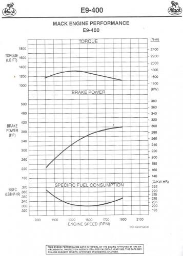

  3. This should help- The first scan is the reference.

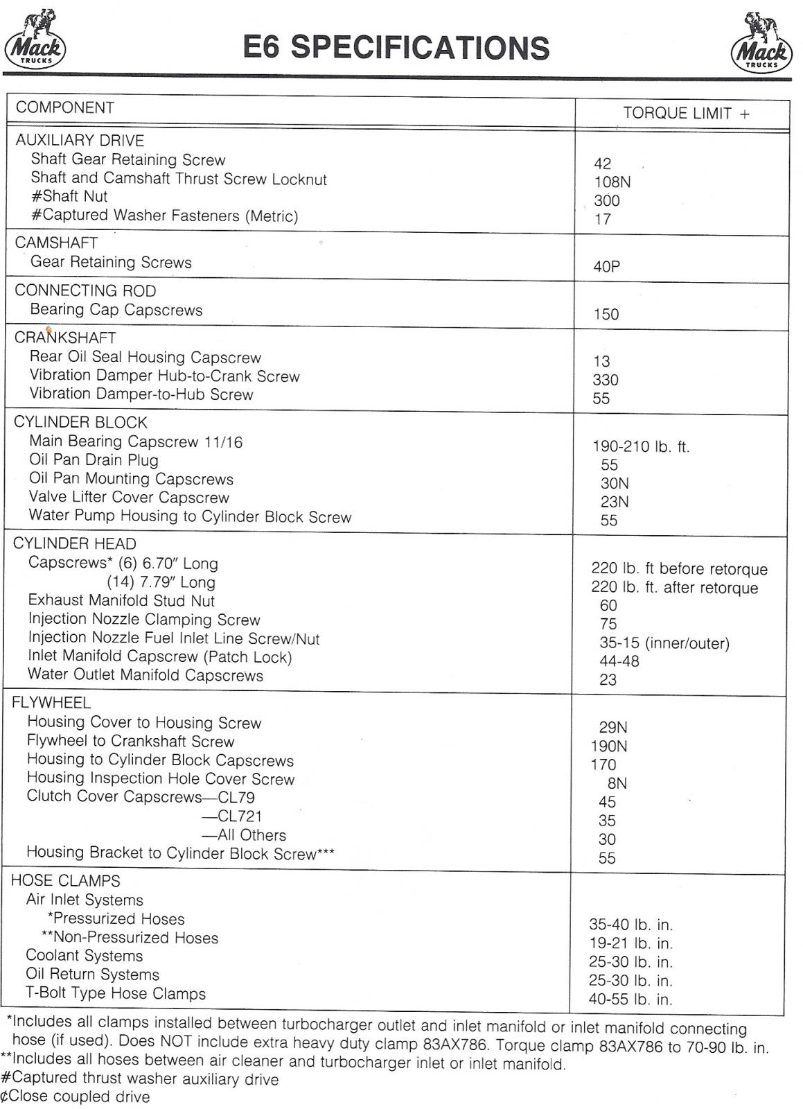

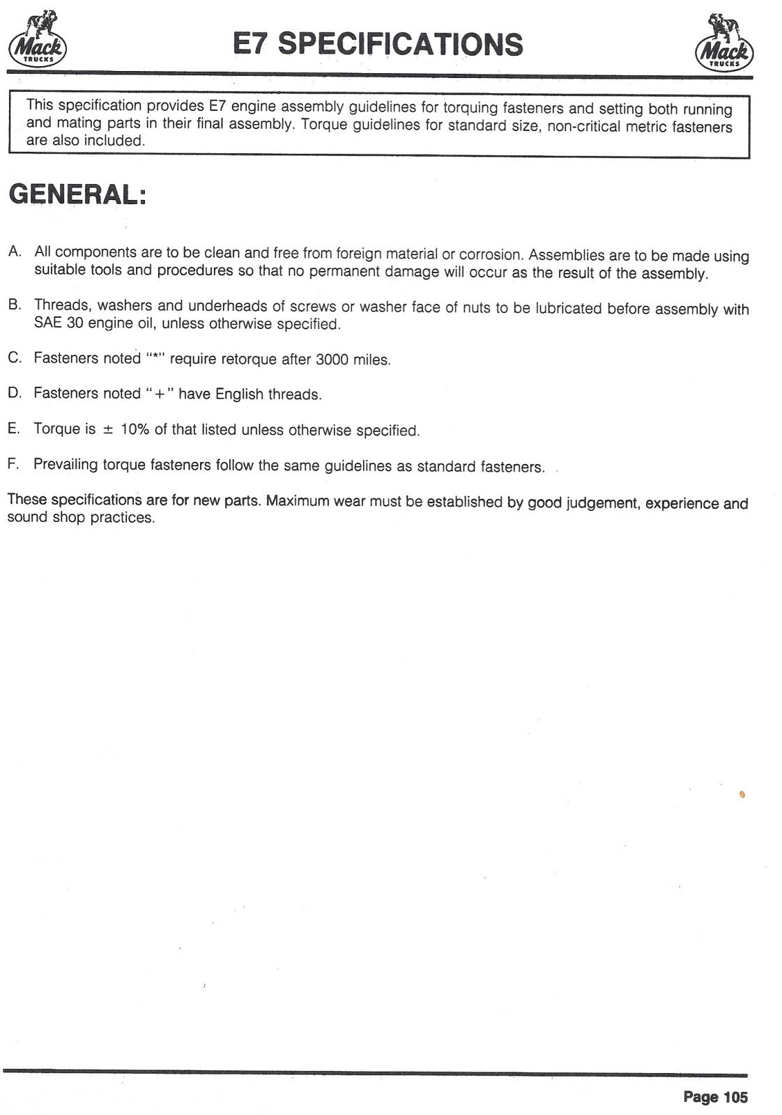

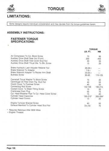

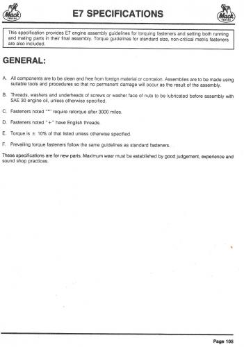

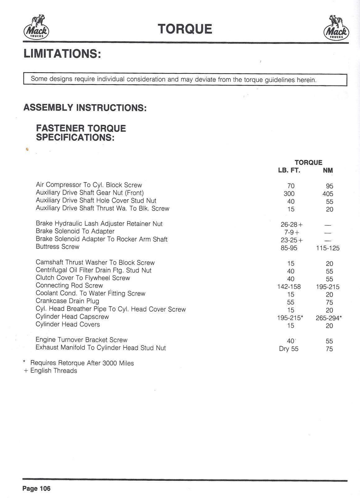

  6. Here you go- the first picture is the source book

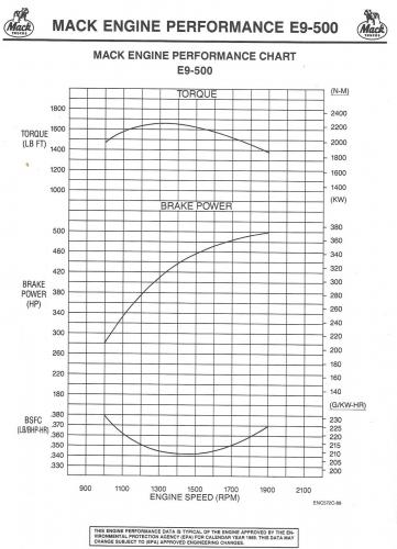

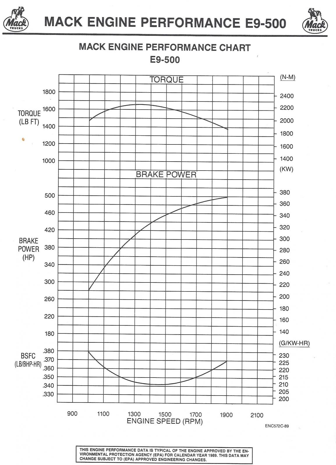

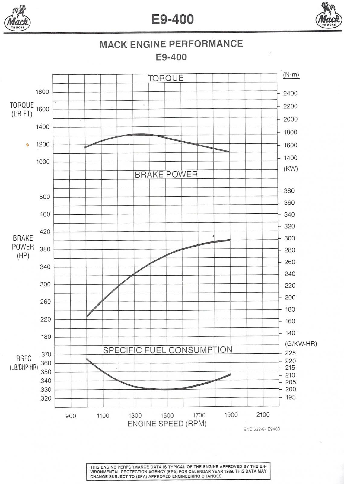

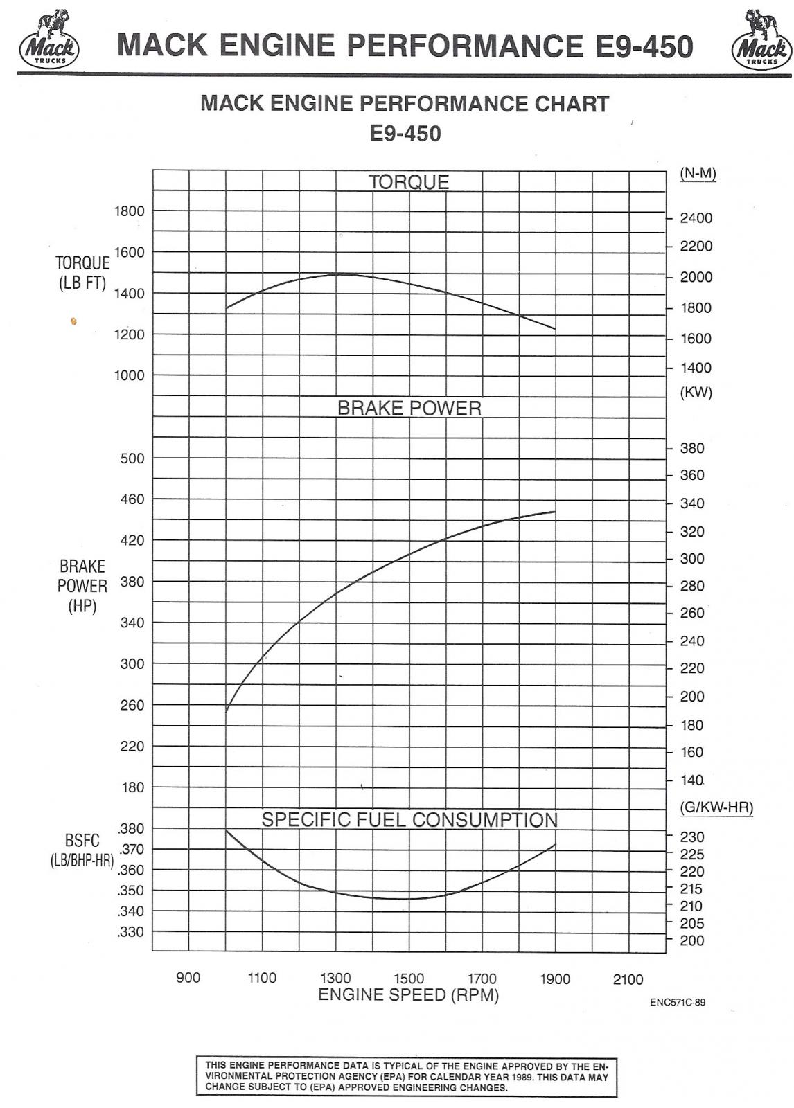

  7. Here are the 3 charts- the cover sheet is the source for the scans. Phildirt
  8. My 1989 Mack engine performance charts show: E-9 400 1350 ft/lb @ 1300 rpm E-9 450 1495 ft/lb @ 1300 rpm E-9 500 1660 ft/lb @ 1300 rpm If you would like to see the performance charts I can scan them for you.

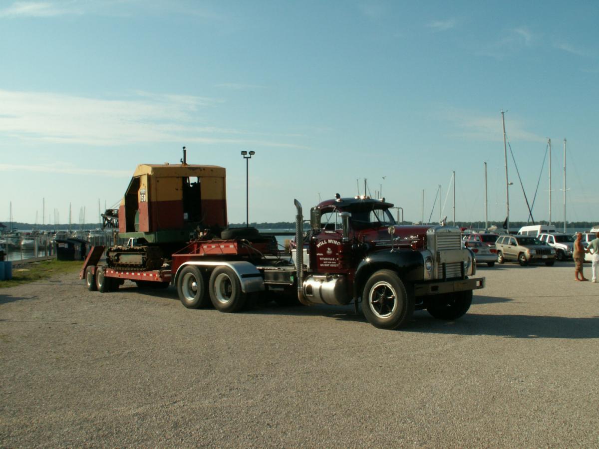

  16. Unless things have changed, J.C. Taylor will not insure big trucks. The will keep what you have but not add any. You could go to their website and get a quote, then call them and they say they will not write the coverage. Gulfway seems about the only choice.

  18. Moved a 15B Bucryus- Erie crane from a barge in the Port of Erie last evening. The B75 enjoyed the exercise- thank god for the winch. Phildirt

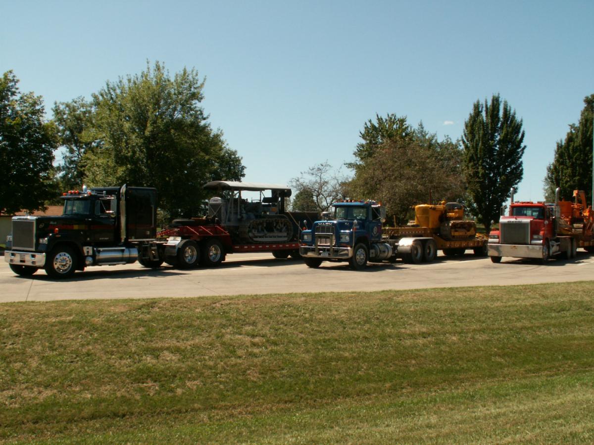

  19. Doug- Why wouln't you be using it? The weather stayed good until early Sunday morning- the skies opened up. We had to scrape 3" of mud to make it up the hill, Carl came out behind a D- 4 Cat. This is the northern PA and upstate NY gang on Thursday on the way - dog, cat, dog, cat, dog, off brand.

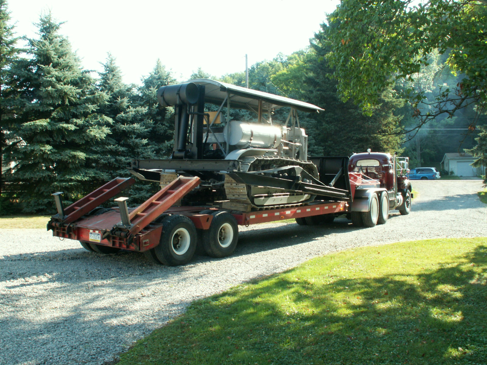

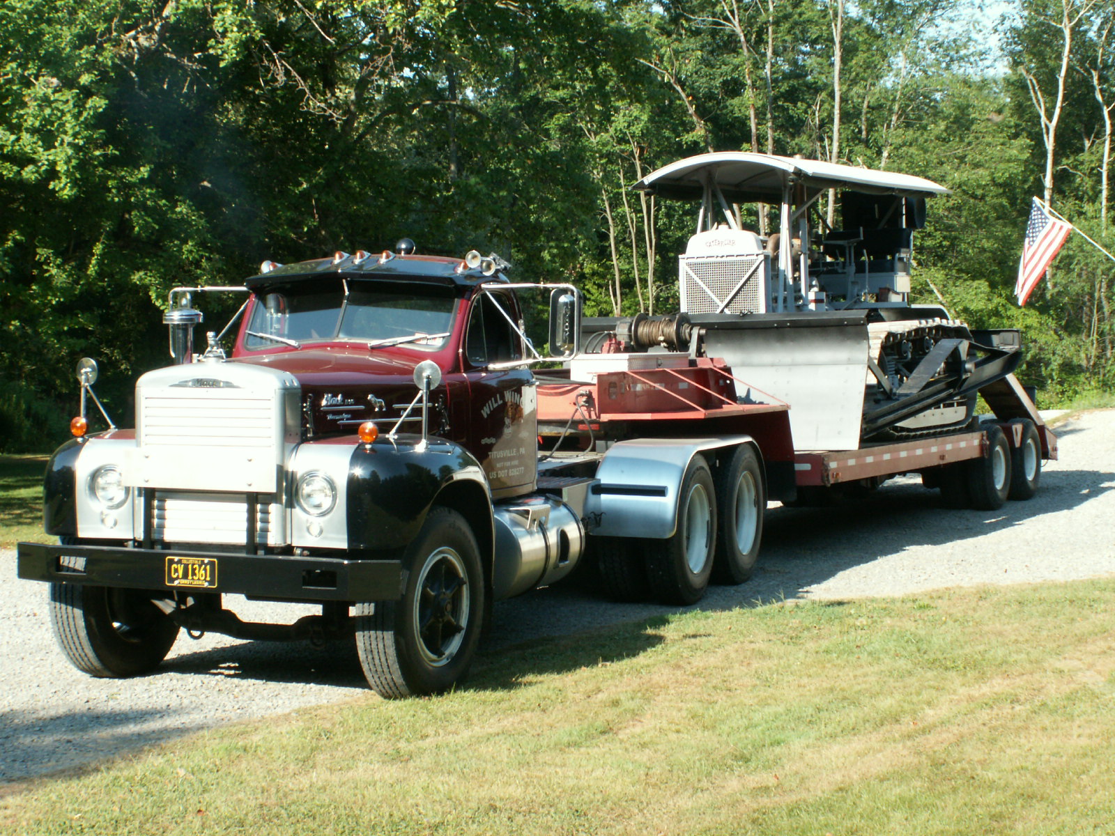

  21. The Mack is a 1963 B75, ENDT 673 turned up to 260 hp, 15 speed triplex, Mack camelback with 4.54 gears, trailer is a 1972 Hyster, ex- Pennsylvania oil patch - (rode hard and put away hot many times), it is just 8' wide. The Caterpillar is a ca. 1928 Model Sixty with a LaPlant- Choate hydraulic blade (same age as the crawler). Weighs about 27,500 and is just 9'6" wide.

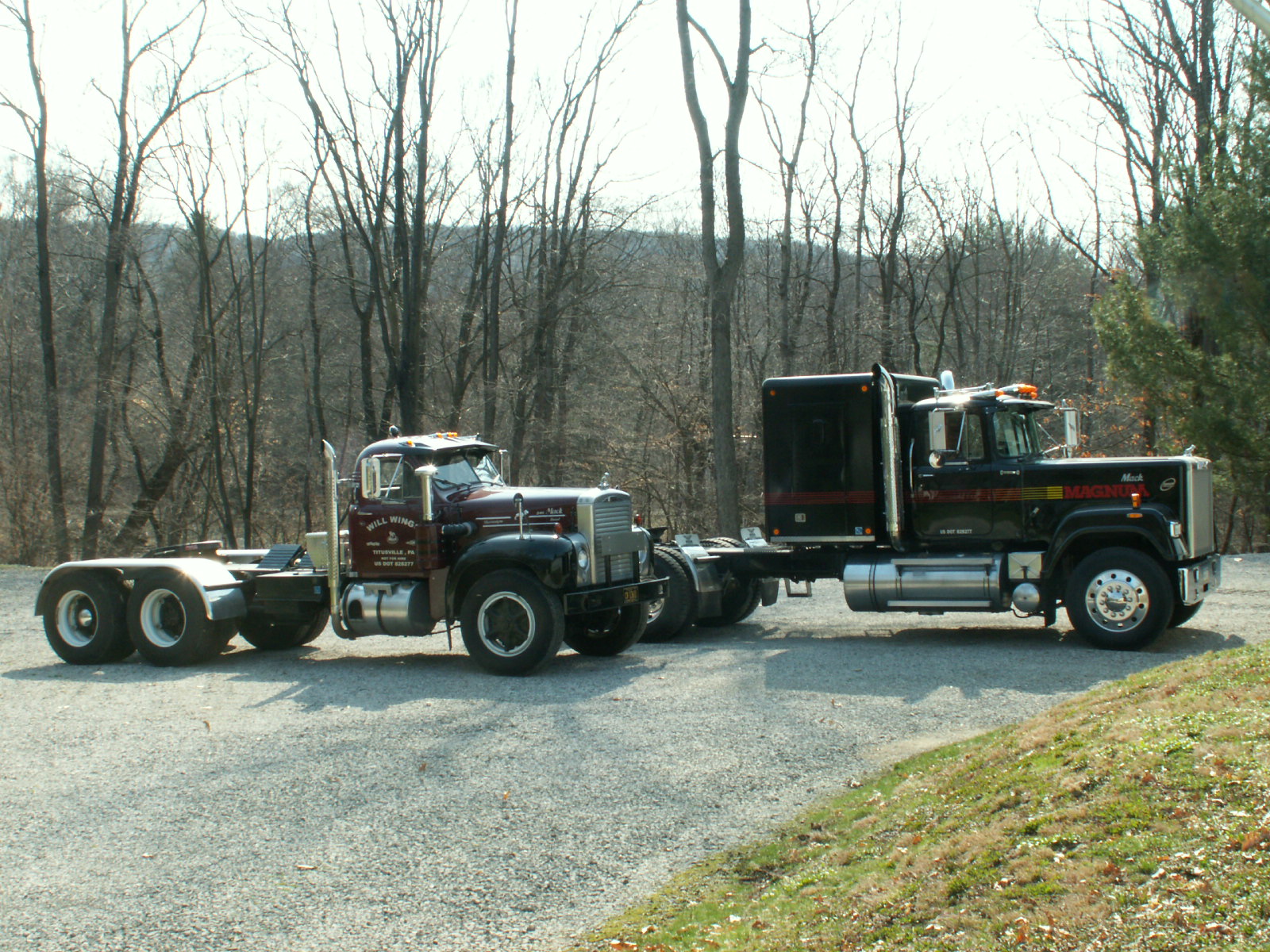

  24. Around noon today the last frost went out of the ground here (NW PA). Today was the first warm day in 2011 (72 F). We had snow on the ground every day from the day after Thanksgiving until March 31st. Talk about your old fashioned winters- where is this global warming? Got the trucks out to celebrate. First time they have moved since October. Phildirt
