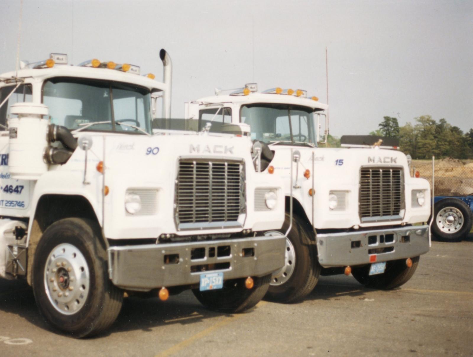

  1. Fernel Trucking Freehold NJ. These R models were Glidered from mid seventies F786's. The R's were daycab tractors and had more wheelbase than most largecars's of the the day. If any of you guys have any more pics of this company please post them. (pic Dave Pearson)
