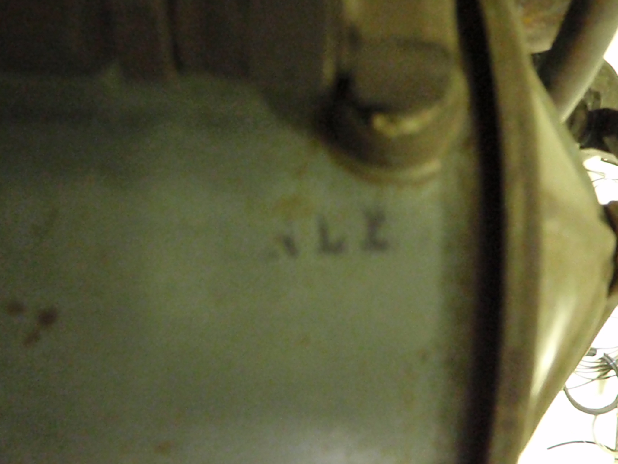

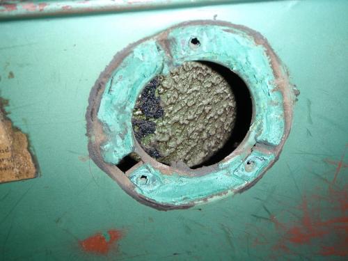

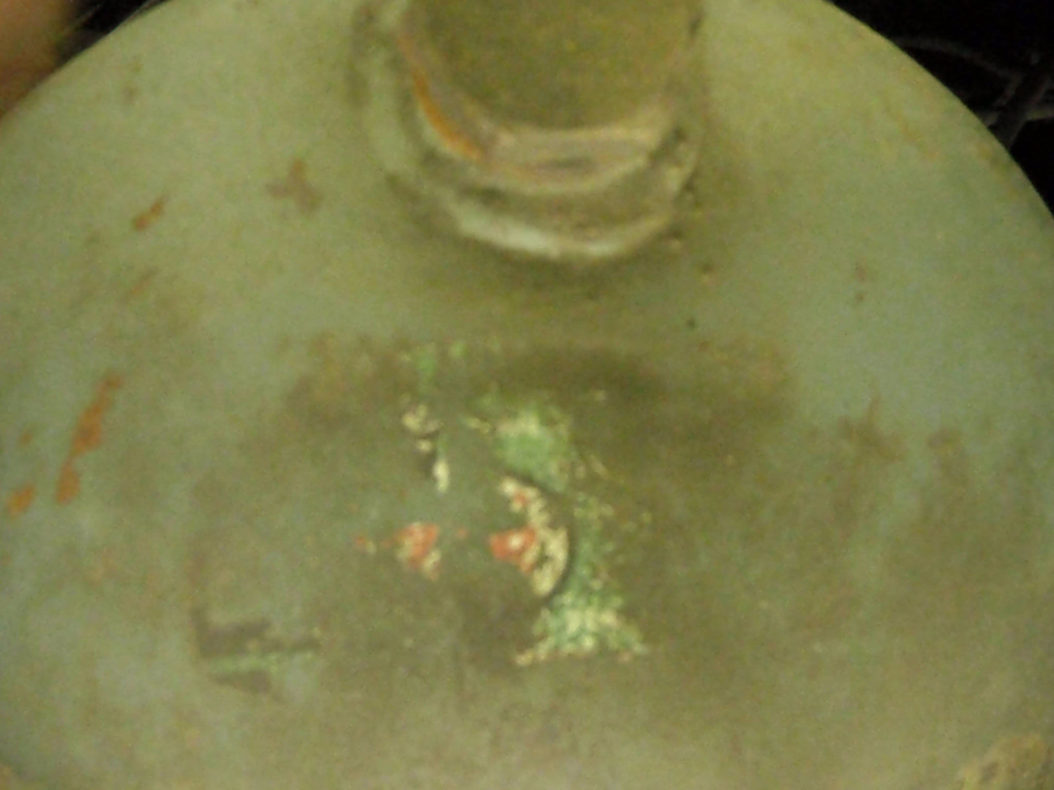

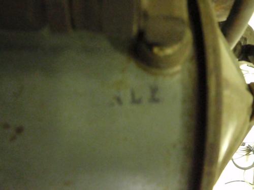

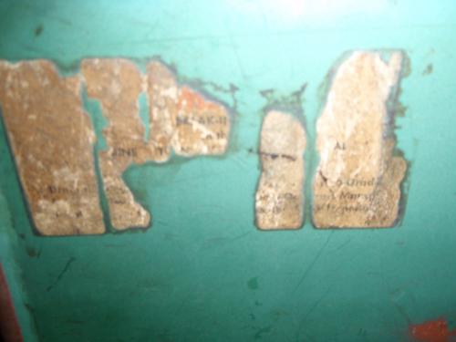

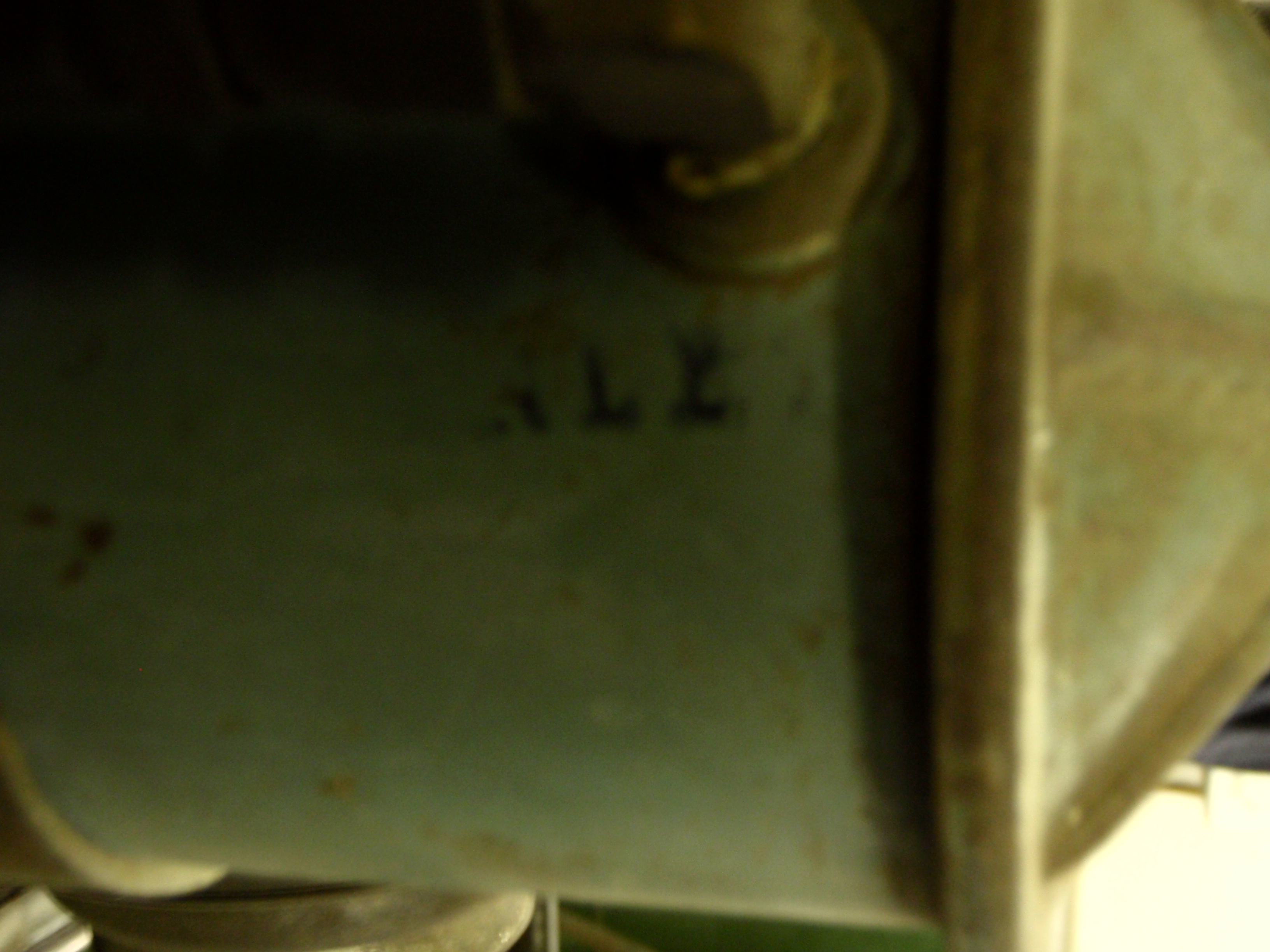

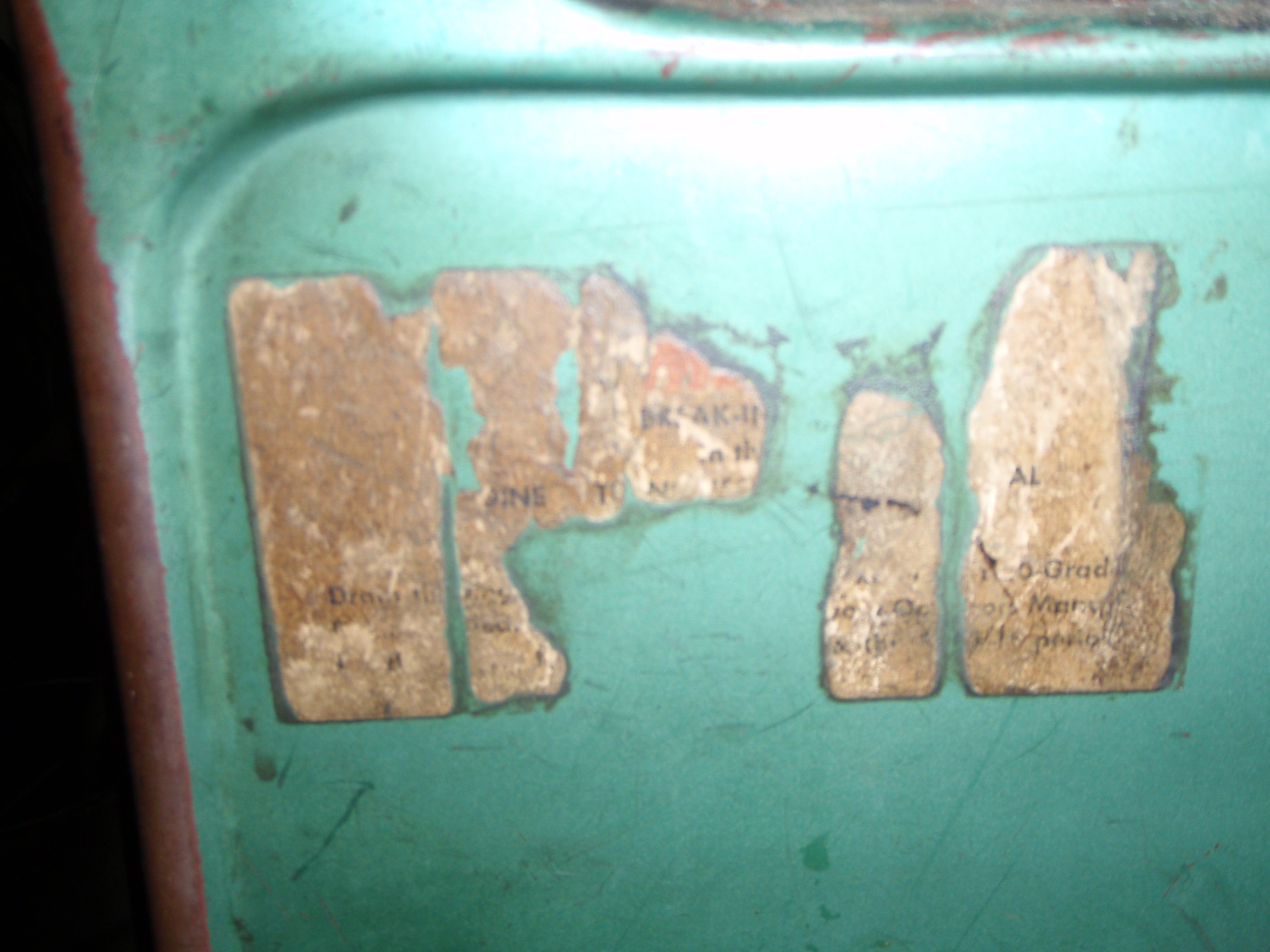

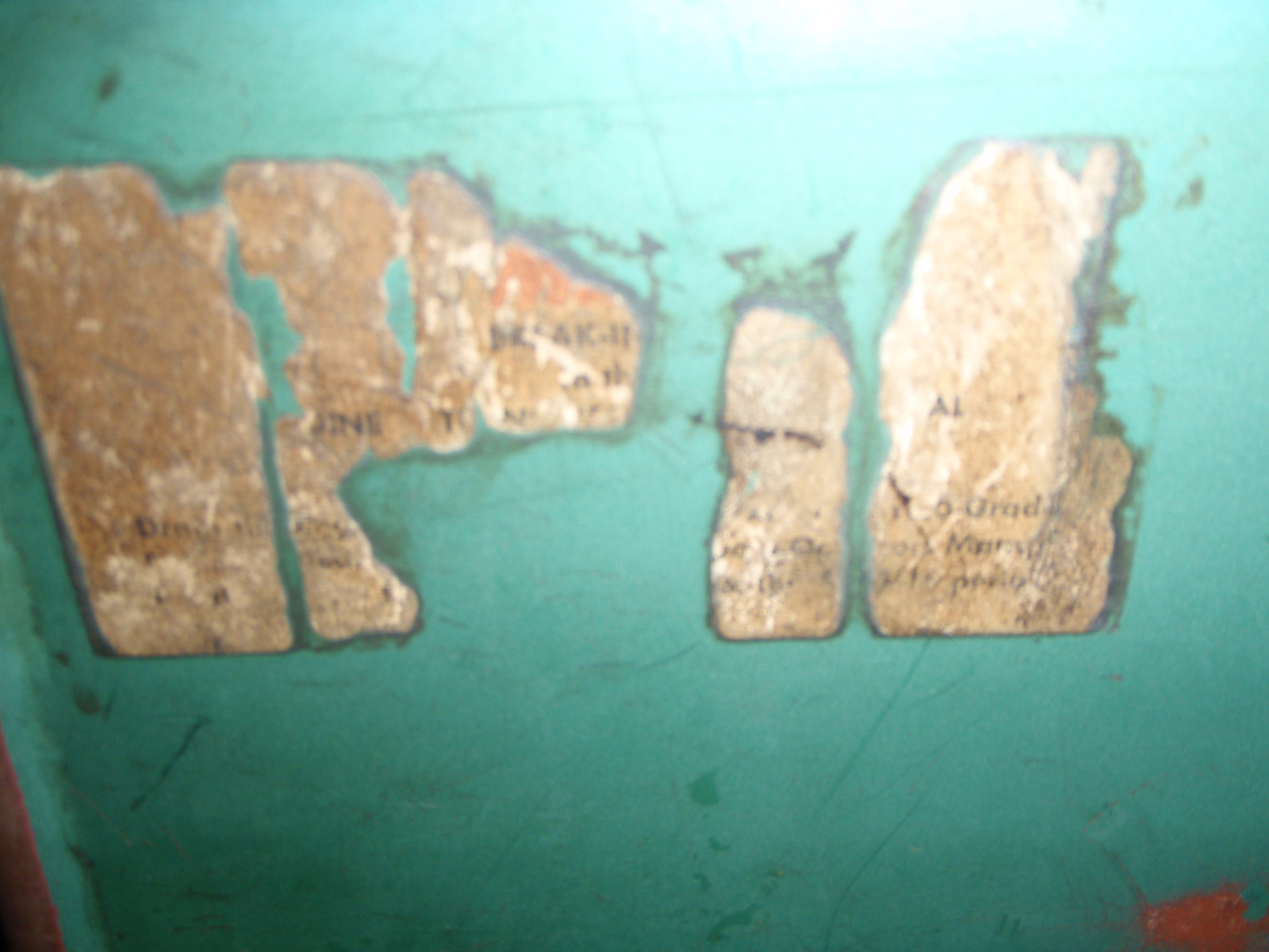

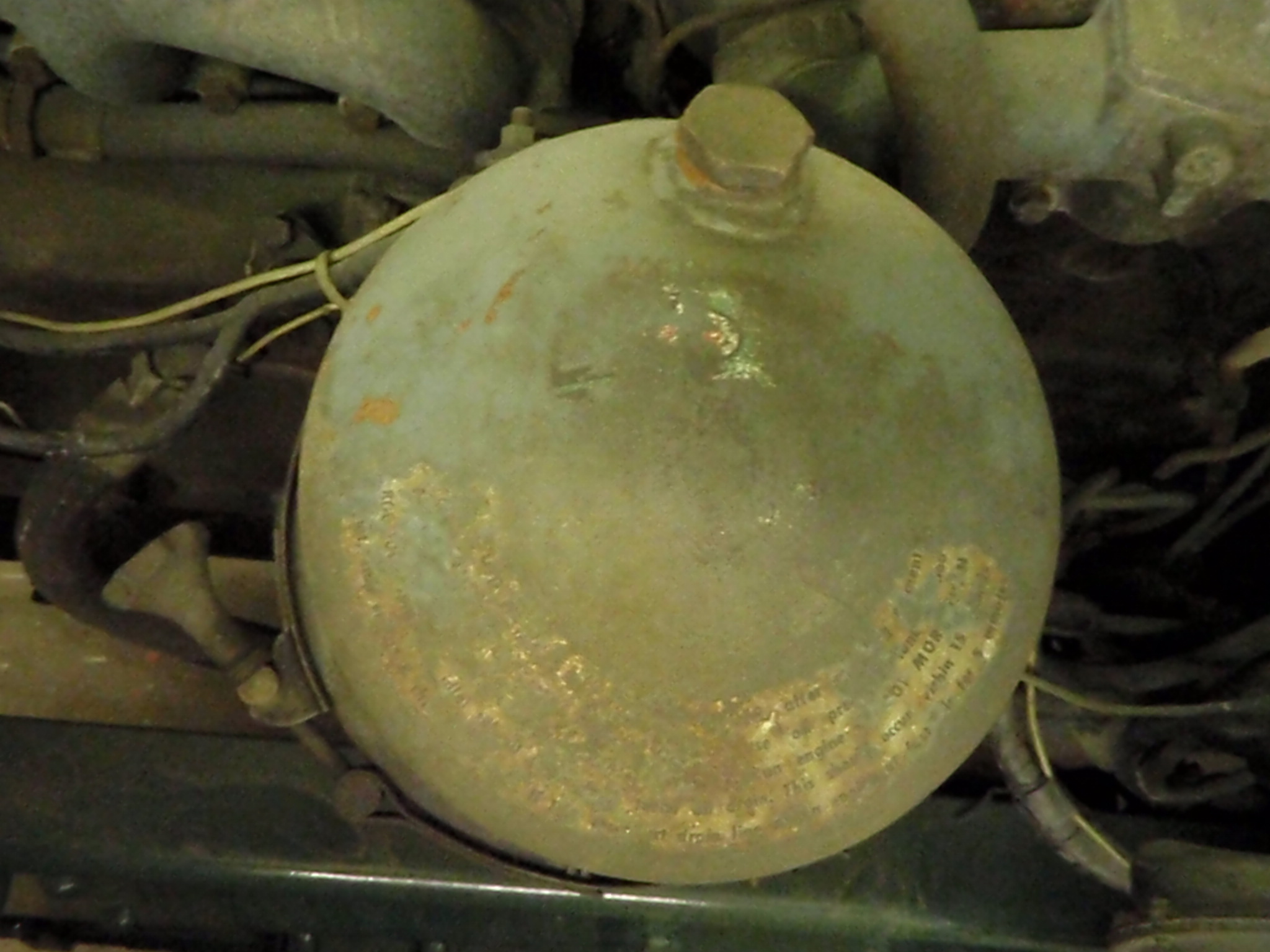

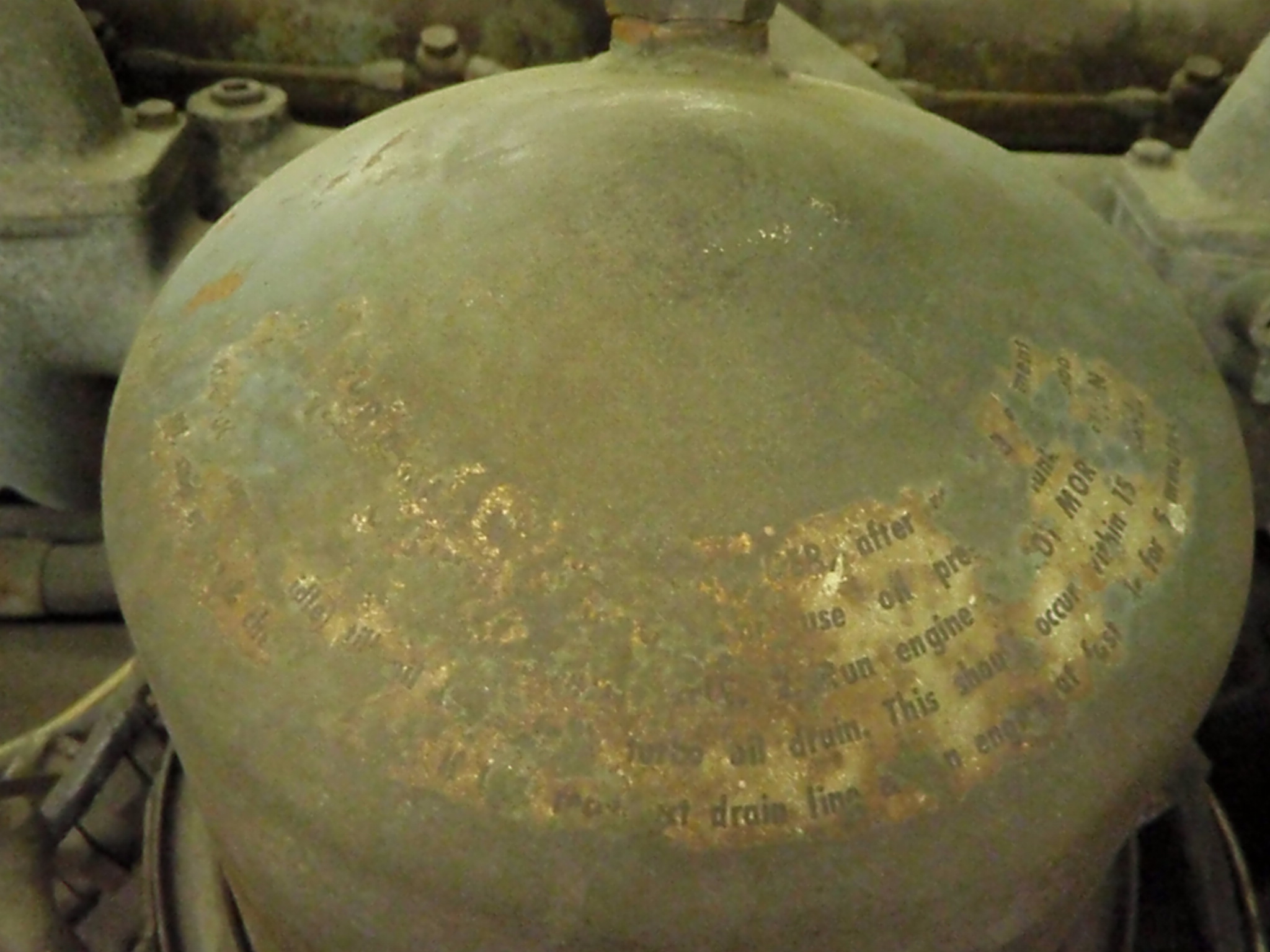

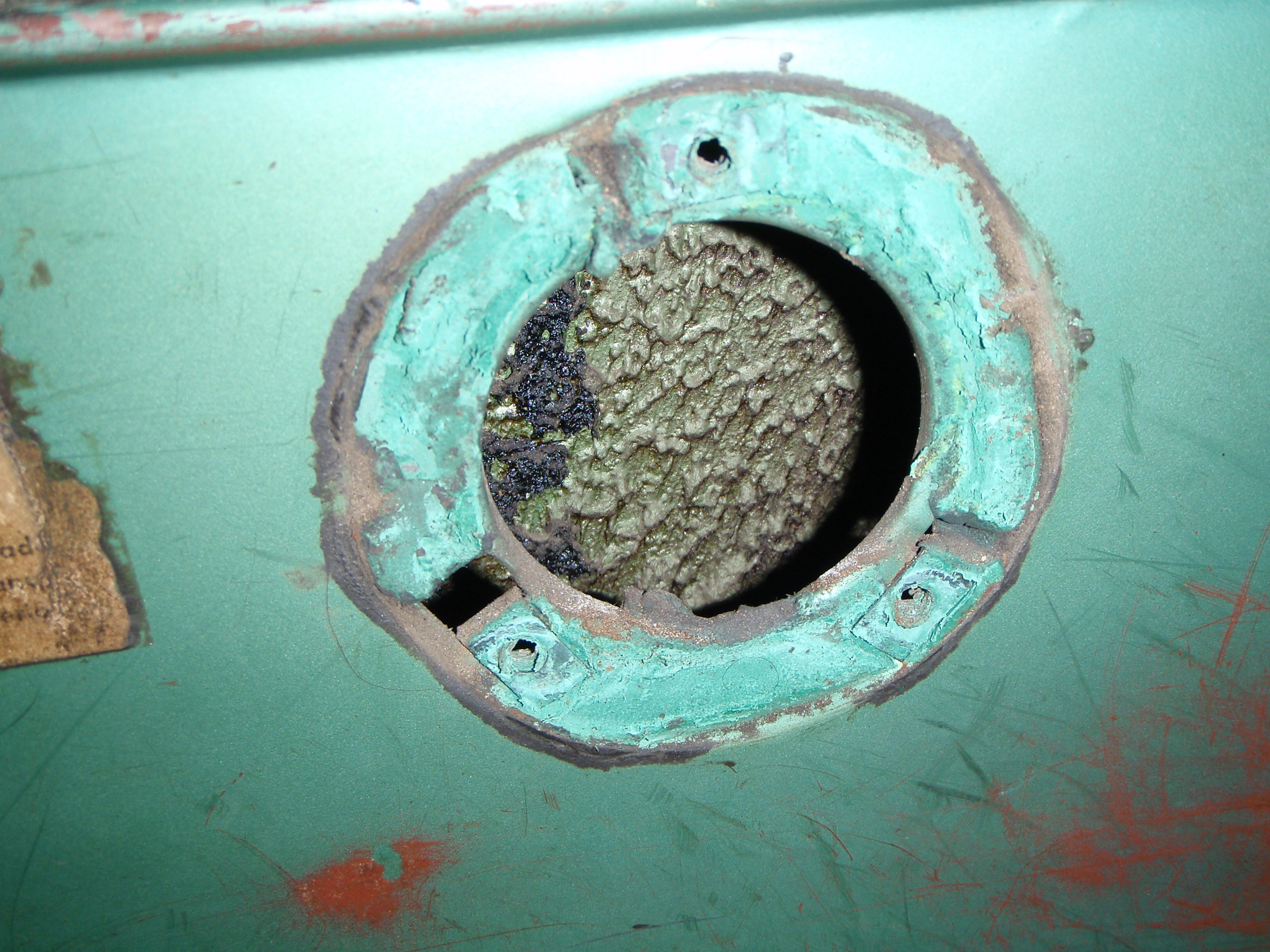

  16. Heres some pics of some random decals that survive on my 65 B-81SX. Mack break in instructions on driver door Door caulking putty (first time window stop was removed) Full flow filter instructions Mack logo on full flow Top view Inlet stamped on fuel filter Just thought id post these since most of this stuff is long gone.
