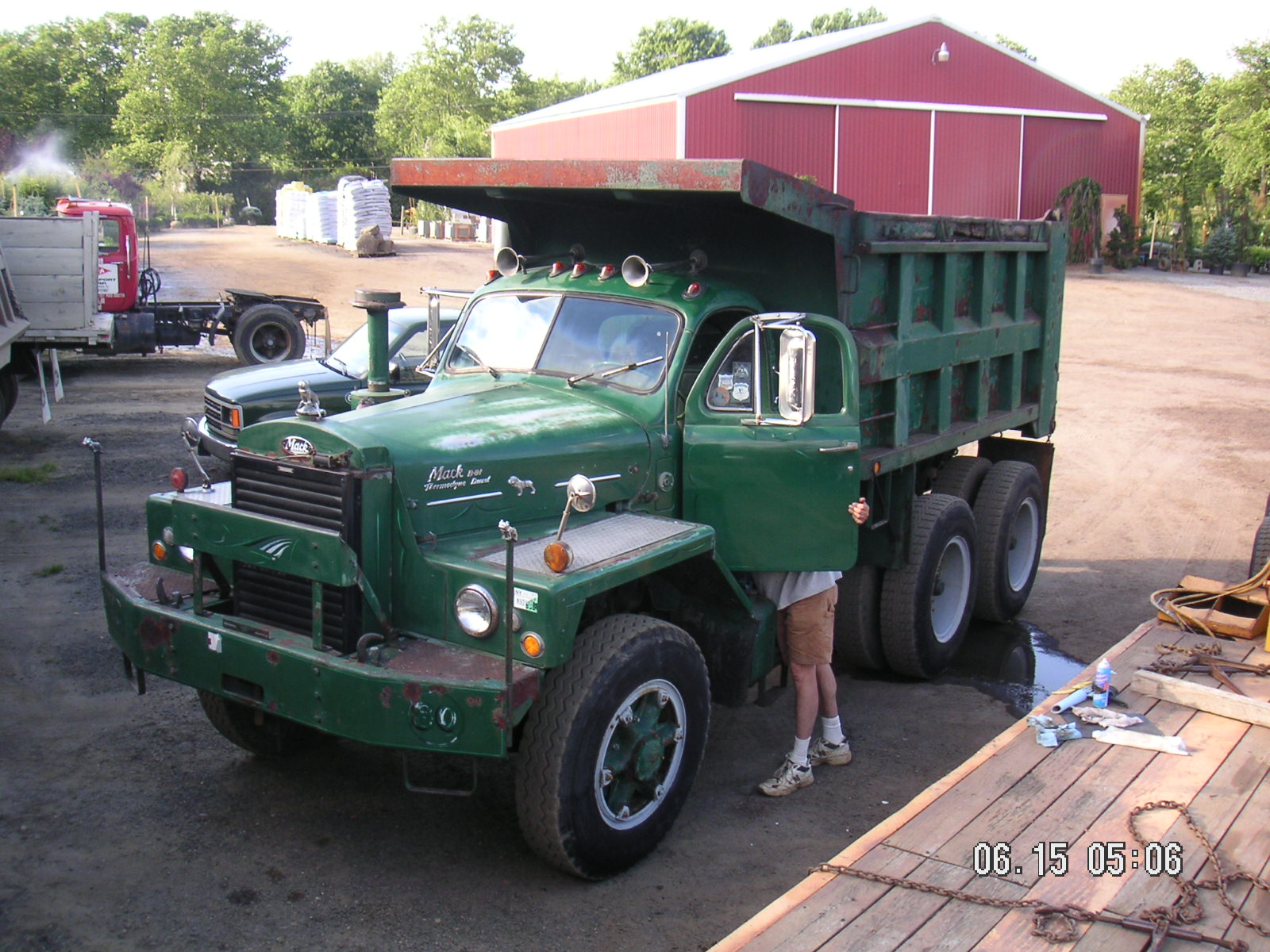

  16. heres a pic of the DM800 I just got done re doing also a pic of my B-81 its going to get redone this winter

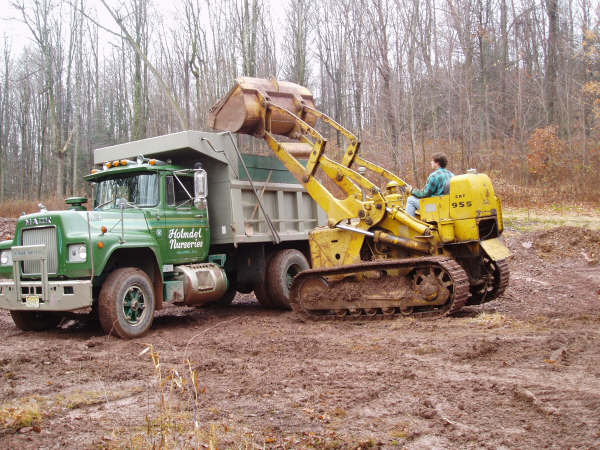

  17. sorry i havent seen your post sooner bulldogman but your right its a 77 thanks for the complement dumper, she can be a little tipsy at times, and i do my best to stay away from the boards! You need a quick hand to knock that clutch out though. This 955's only a toy though.
