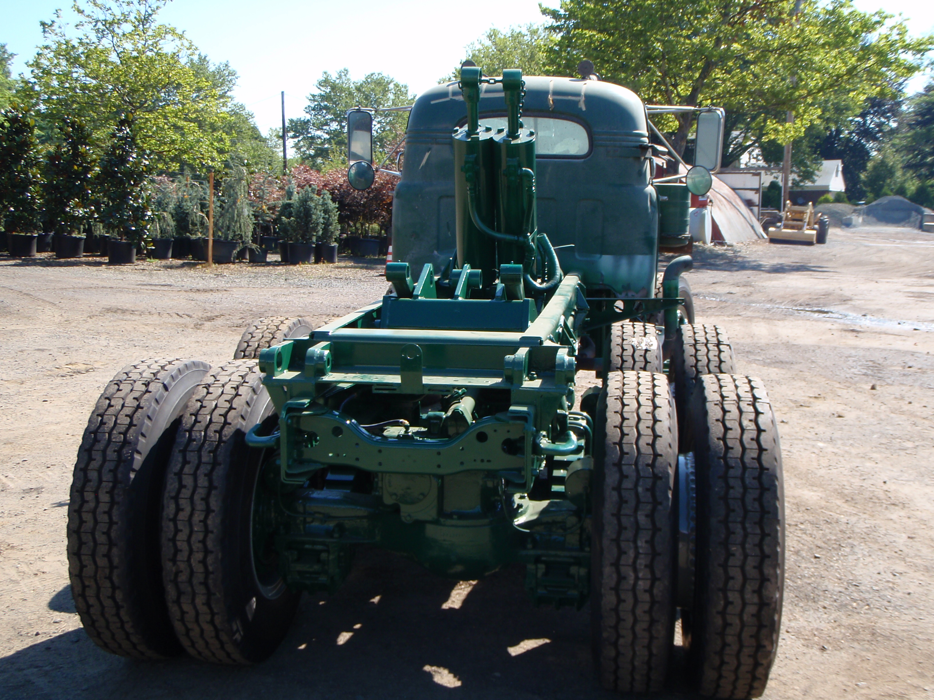

  2. I was looking at your trucks in the gallery (very nice!) and I have a question for you. Where did you get those stacks that look like the old b model and early r ones? Also who makes them? Pretty neat stuff, I need a couple for some of my trucks. Thanks

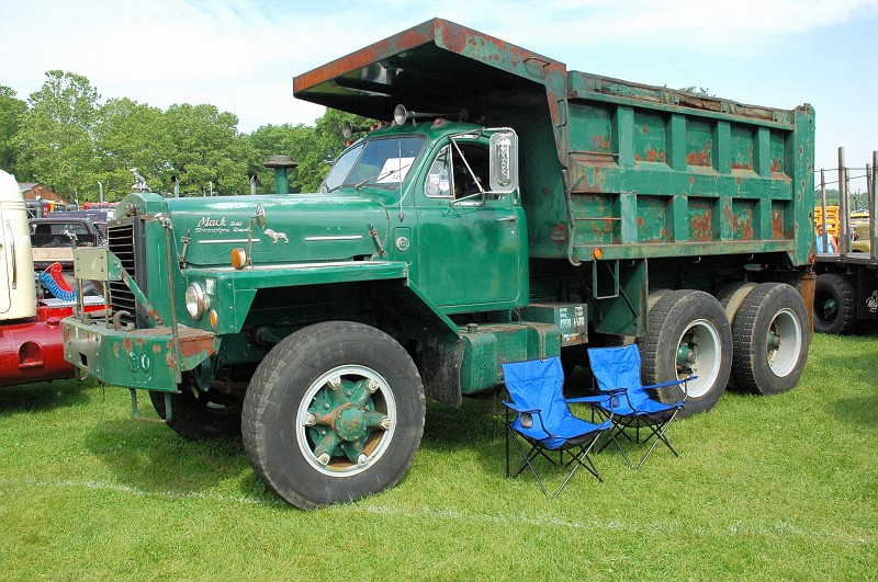

  9. After all the recent talk about heavy spec NY trucks on these forums I thought Id ask a couple questions about the original owner of my b-81. It was purchased by Joe Farina and was the personal truck of Eddie Farina and was originally lettered as Fiori contractors #80. If you remember anything about this company or its trucks Id like to hear about it. Even personal opinions about the operation they had, let me know. Thanks

  13. how about a pic of a Farina B-81? Ive got some pics of jersey spec dm-8's if you want me to post some of those but I know they arent quite as heavy as those big grandfathered trucks from ny.

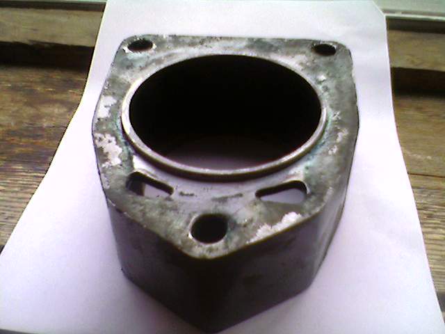

  18. Well the adapetr that bolts between the block and air compressor is cracked. i looked at all of my parts and parts trucks and I dont have one. it is on a '65 711 and my '67 r model w/673 has one as well. I enclosed a pic . If anyone has one kicking around please let me know. thanks Chris
