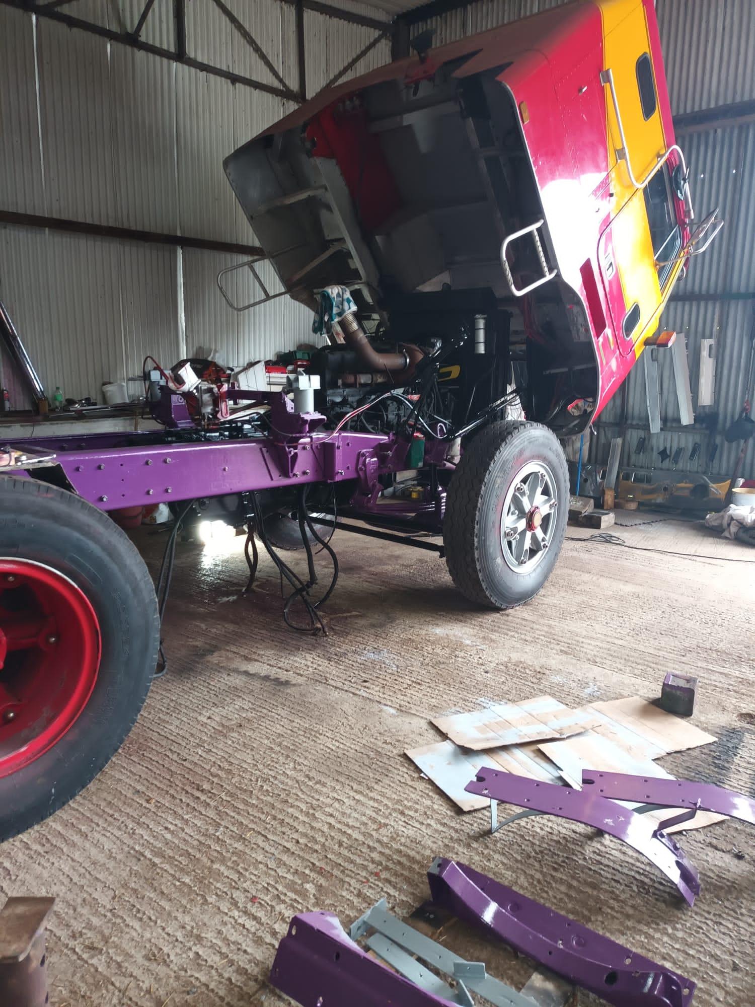

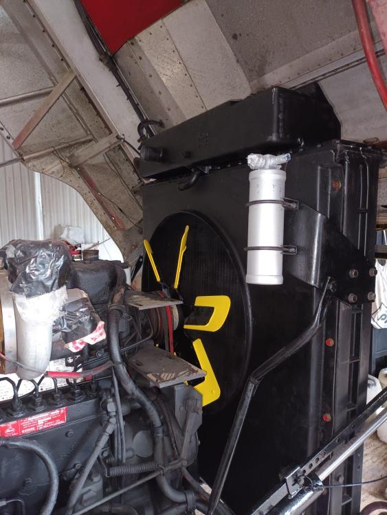

We have been busier than a one legged man in an a$$ kicking contest....So can anybody tell us how thick are the brake shoes when new? Im asking because we have been told by previous owners that this truck has very small mileage but nobody can prove that.When we stripped the brakes the shoes are a half inch thick on all brake sets.So what you may ask,well all the brake shoes are date stamped 1982, the year the truck rolled off the line.....In fact the rad,intercooler,spring hangers,alternator,diffs,water pump,thermostat houseing,wheels,injector pump,springs and Dayton spokes are all stamped with dates in 1982.....just how original is this truck????

Big job! Keep on going!
I'm pretty sure the result will offset the efforts. And as you do it it will be seen very soon on my mind:thumb:
Of the brake shoes and drums my way would be keeping them in place and forgetting about them for at least 50,000 upcoming kilometers. You will doubtly make that much driving to shows and other events for fun. So those shoes have very good chances to serve for the rest of the truck's life. Maybe even more:)
If all them date coded things you said are correct, i don,t think i have ever heard of a truck with so many original factory parts.   terry:MackLogo:
