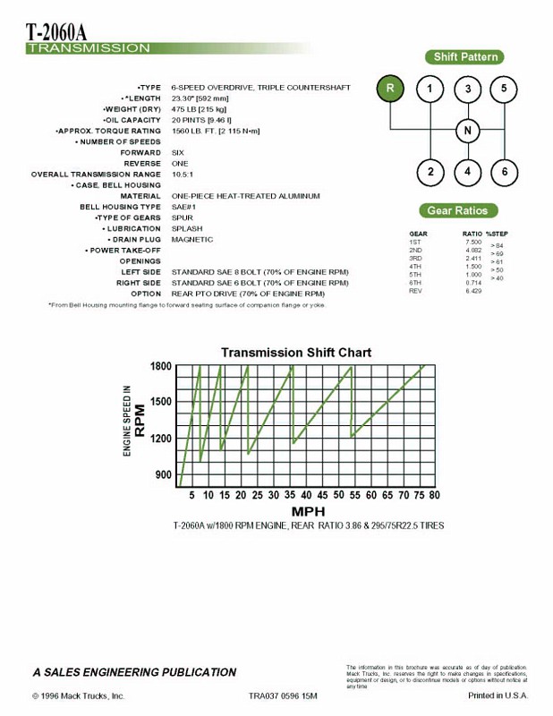

2 hours ago, Warpman89 said:
this is the shift pattern so it must be a t2060a, is this a good transmission? It's the first I've seen like it
once again this proves the old  statement == never tooo old to learn something new. wasn't aware of a Mack non-air 6 speed pattern transmission
