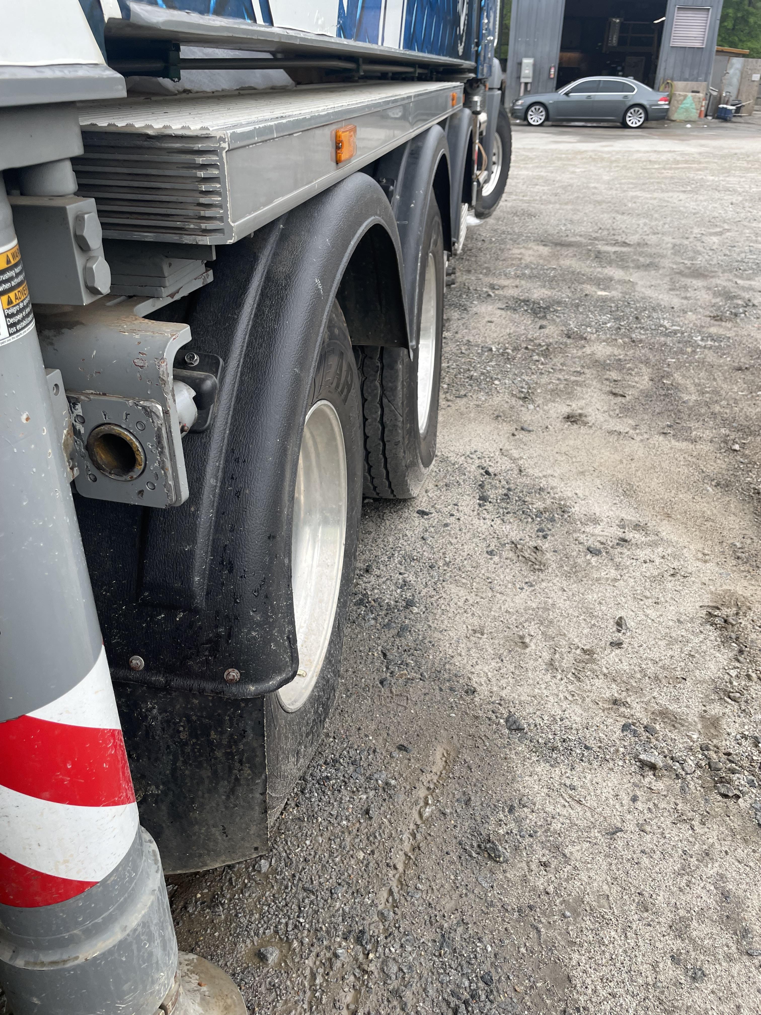

I have a Mack Granite GR64B with Camelback suspension (44k).  The rear axles wander and show significant displacement from each other (see image) particularly in tight turns.  The pictures shown were taken at 20k miles, but the wander has been present since new. The truck is a concrete pumper, and 99%+ of its driving is on freeways or surface streets.
Brought this up to my dealer some time ago who told me "this is a hallmark of camelbacks... they are designed to have lots of compliance".
Recently after reading a few other threads, I am skeptical, particularly since none of my other 7 trucks (all supposedly identical) show this behavior.  The other 7 trucks have very little wander (inch or less).
The truck is quite drive-able (no complaints from any drivers) and the tires show no unusual wear, just looks strange as hell to me.
The unit has brass bushings in the trunions and urethane isolators with isolator spacers (so-called "twinkies").  Both carriers have longitudinal torque rods.  Neither carrier has a transverse torque rod.
I don't see evidence of loose fasteners on the trunions or boxes (u-bolts or bolts) such as gaps, abrasions, rubs, wear or exposed threads, etc.  I don't see evidence of the leaf springs shifting forward or aft on the top half of the trunions which makes me think the u-bolts are properly torqued, and the bottom three leafs are aligned and centered in the isolator boxes (which makes me think the isolator boxes are properly torqued).

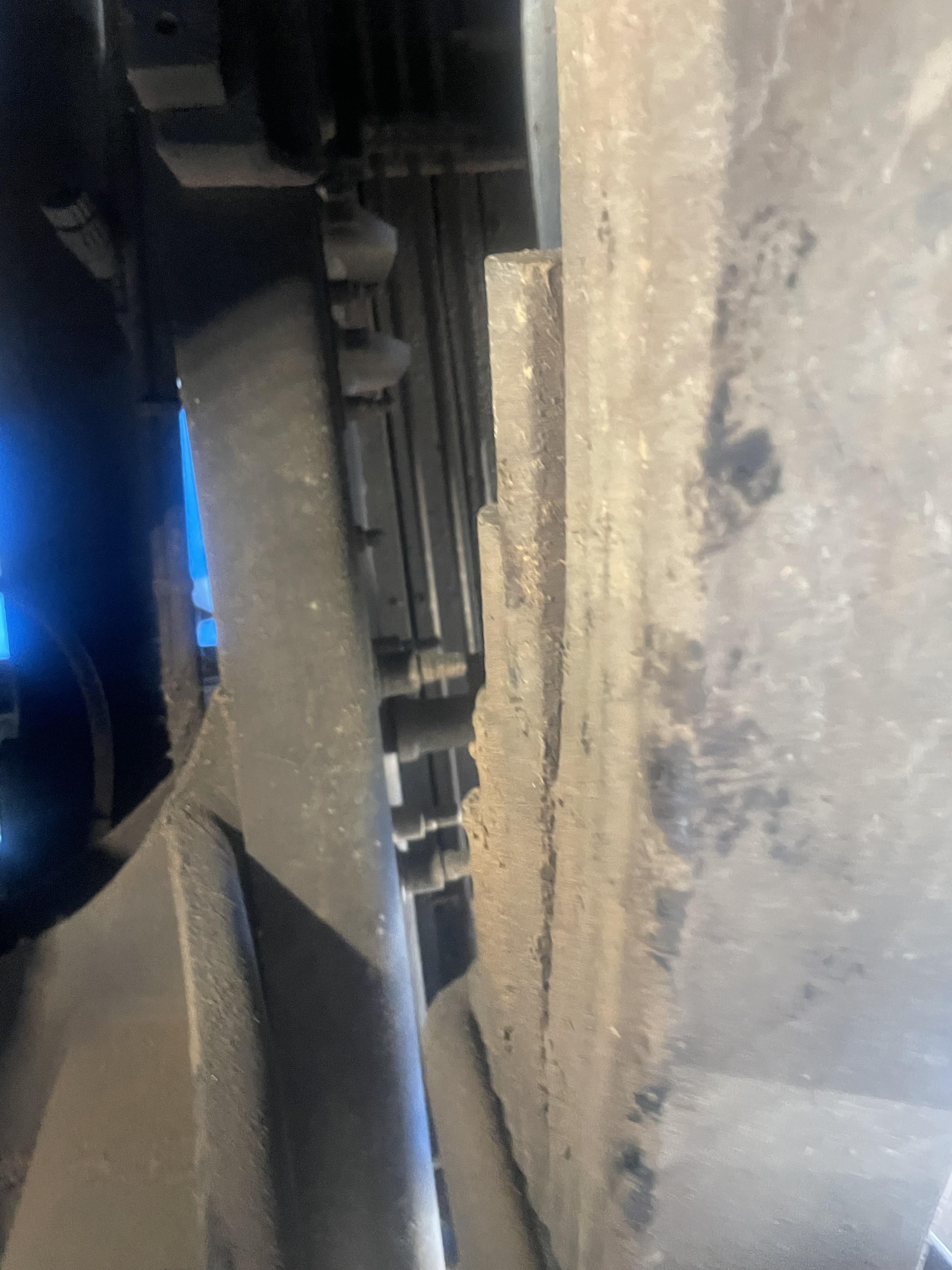

The only two observations I can make that might be clues are that (1) the third spring from the top of the driver's side leaf spring is twisted and is out of alignment with the other springs in the leaf by about 0.5 inch and (2) the isolator pads (twinkies) are loose and rattle from side to side in the isolator boxes.  I am very surprised that the isolator pads are loose... if the pads are extruding outward under the axle load, I would expect the twinkies to be pressed outward against the box and not be loose at all.
What would be the root cause of 2-3 inches of axle wander on a new and/or very low mileage truck?

None of my eight 38 meter boom pumps (same as this one) have transverse torque/stabilizer arms.   The pump kit mounted on the truck sits between the chassis rails, and I was told years ago that the clearance between the carriers and the pump cylinders is insufficient for the transverse torque arms to be installed, particularly on shorter boom pumps.  It is noteworthy that all of my 38m pumps have axle stops to prevent the carrier from pushing up and striking the pump cylinders, which I am constantly inspecting.  This is the only one of my pumps that has this wander.
Correspondingly, my longer pumps (47 meter and 56 meter) have more clearance and all of them have the transverse torque arms.  They also have Hendrickson or Neway suspensions.
I took the pump to the dealer who tells me the wander is due to shot trunnions and pads. This diagnosis makes no sense to me for the following reasons:
wander has been present since day 1 (new)

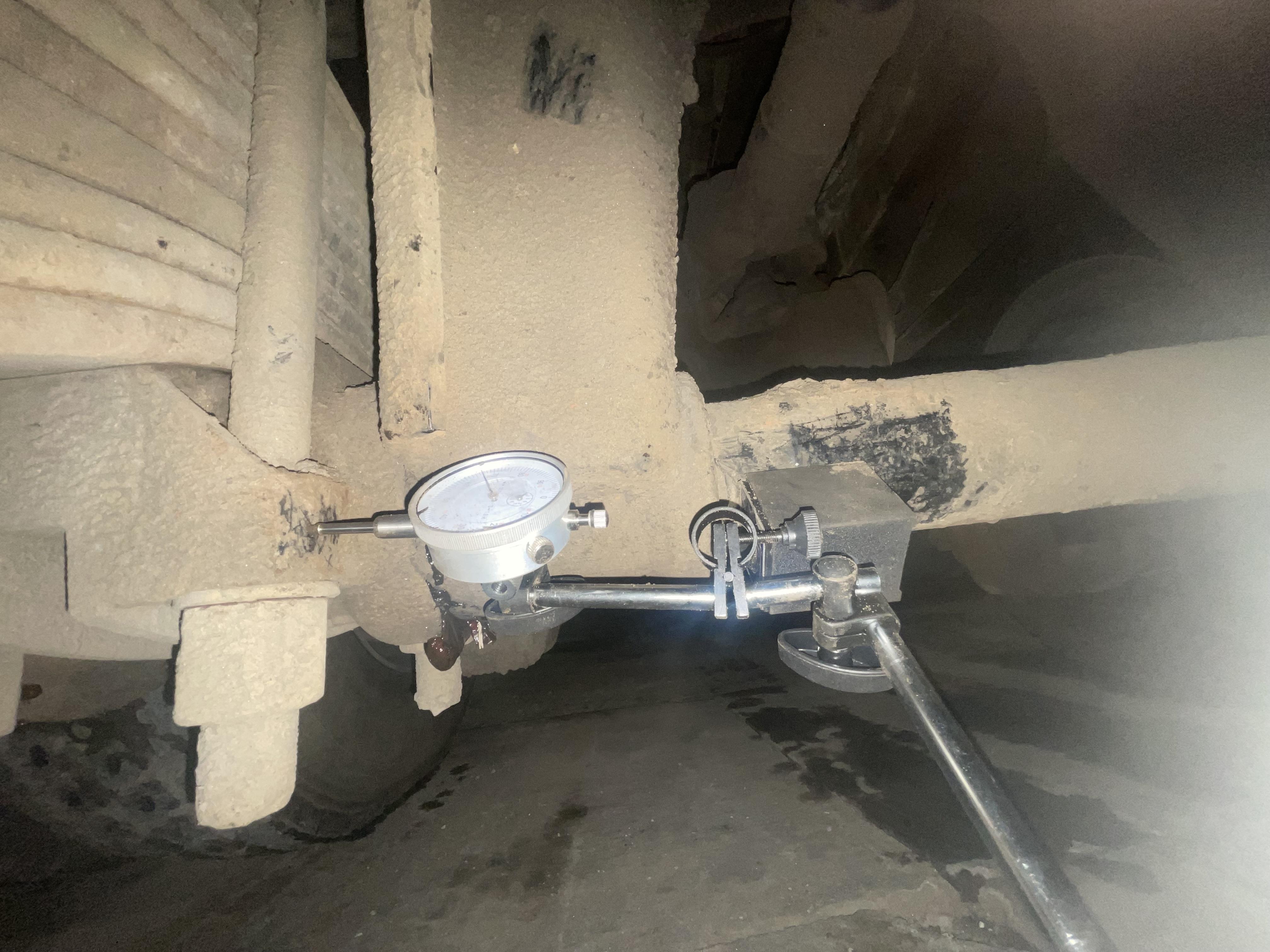

I lifted the truck with the pump outriggers and removed the trunnion caps, wiped out the grease and visually inspected the parts.  Both the thrust washer and notched D ring spin (normal?) and no evidence of abrasions or brass shavings were noted.
While lifted and open, I shot it with grease and grease came out the bottom side of the bushing.  I stitched it back together, dropped it back on the ground and shot it with grease again to get the top side of the bushing.  Some grease also came out of the backside of the trunnion
I backed the truck up on a tight radius to create about 2" of axle displacement, put the dial indicator on (see 2nd pic), and then used the pump outriggers to lift the truck.  Once lifted, the axle displacement dropped from 2" to about 0.5".  The trunnions only moved about 0.020" (well below the Joey Mack 0.100" threshold).
Parked the truck after a hard right turn and inspected the springs, and again after a hard left turn.  I was able to confirm that the leaf springs are rotating on top of the trunions a few degrees (3 degrees of rotation turn into 3 inches of wander on a 48" wheelbase).
By hand, I attempted to wiggle/move the spring bolt on each leaf both when the truck was lifted and on the ground, and could not detect any play, so suspect that the spring bolts are intact.
The springs are rotating in the isolator boxes, minimizing tire scrub when the axles are displaced (no unusual tire wear on this truck).  Isolator pads look good and there is no play front-to-back, side-to-side, or up-and down when the truck is on the ground or jacked up.

So a few questions
  • are the thrust ring and notched ring in the trunnion supposed to spin?
  • was my dial indicator set up correctly?
  • was my spring bolt test adequate, or is there a better way to test for bolt shear that does not involve disassembling the leaf?
  • one spring is rotated out of alignment from the other springs (see pic) by about 0.5".  Any risk of leaving this as is, or essential to realign?
  • thoughts on re-torquing the existing u-bolts, or replace?
Thanks gents, greatly appreciate your experience and expertise on practical repairs.

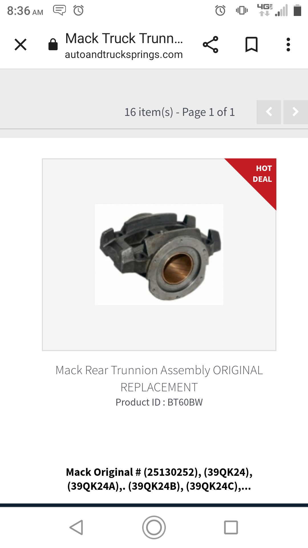

If your goal is to eliminate the axle wander then you're going to want to replace the spring saddles. FJH is right, the spring saddle looks to be missing certain anti wander features. Take note of this saddle from his link:
The lower springs actually set down into the saddle, where part of the saddle casting captures the lower springs from any wandering. If you're not going to replace the saddles then just tighten up the u bolts and call it a day. It'll still wander though.
Saddles are easy to replace.  Block up the trunnion bar, since you're a pump truck you can do this with the outriggers.  (The trunnion bar "hangs" from the camelback springs)
Take cover off end of saddle, remove spindle nut etc from trunnion bar, cut u bolts with a torch and drive the out, jack up the axles to lift springs off of saddle, slide old saddle off.
Generally easier to do with all the tires out of the way.
Assembly is pretty much reversal of order.  Note any shims that may exist between saddle and trunnion stand.
Slide new saddle on, lower axles/springs into saddle, install u bolts, install the retainer nut assembly and cap, grease and done.

Good afternoon gents.  The trunnions shared by JoeH and FJH would clearly be superior, no doubt.
I inspected my other trucks and they all have the exact same trunnion/saddle as my wandering axle truck, and none have this issue.
