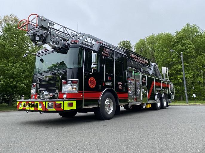

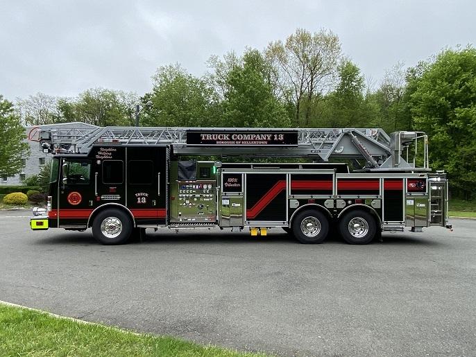

We have an X15/605hp tied to an Alison EVS4000 worldseries automatic in our new firetruck that's 73000. Granted it's not a road or local truck and we're not doing P & D's every day but it seems to be doing pretty well so far a year out. Pulls real strong up the hills of the Lehigh Valley and when you are going up a hill and the RPM's go down a little, if you turn your head just right, it kind of sounds like an E9 or 3408 with the pop pop pop pop pop pop...................LOL
x15 sounds horrible to my Ear ! It sounds like it could come thru the hood at any moment! just me!
That's a nice fire truck! Big mill too!
