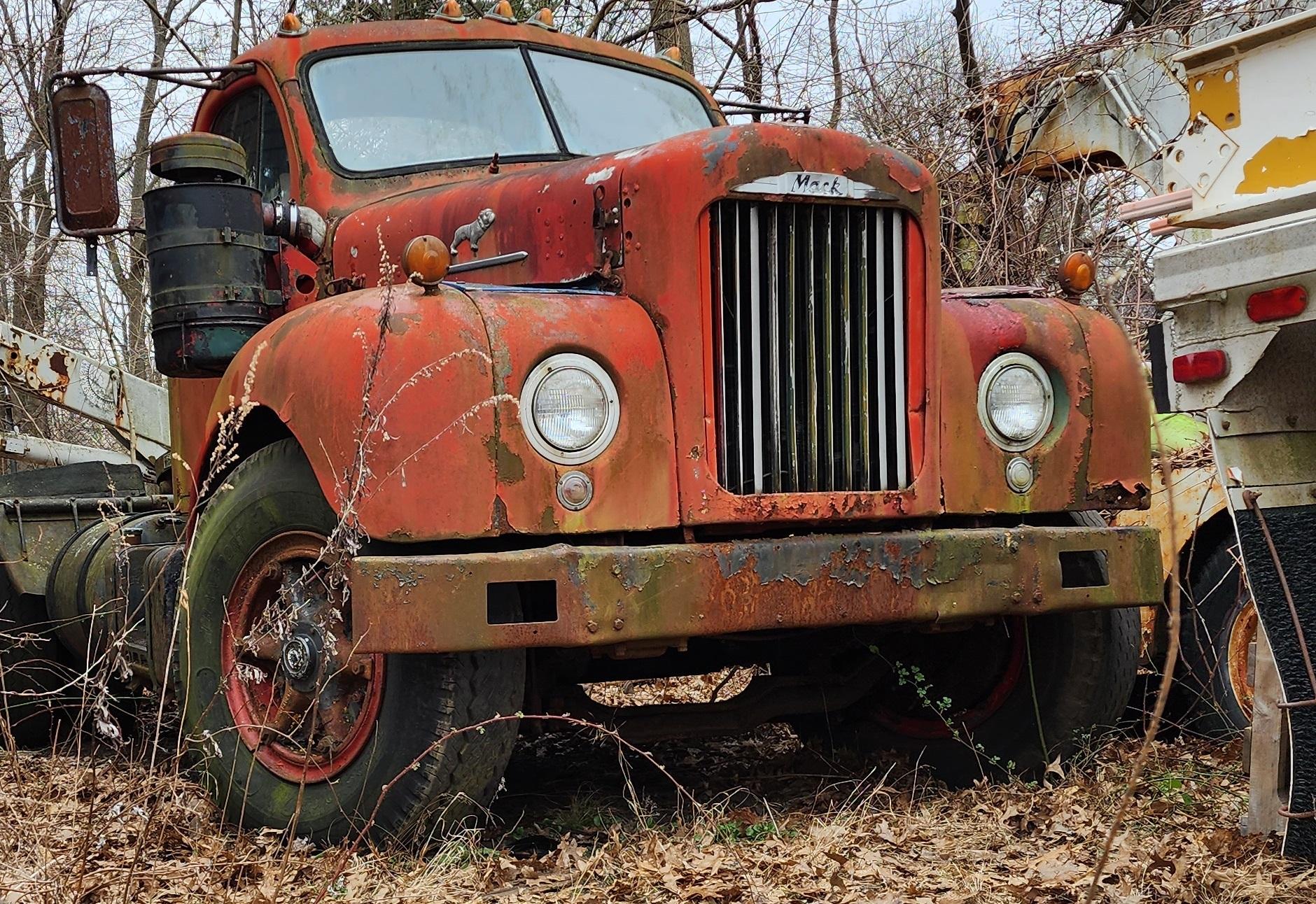

first important question;;; where in CT is all this taking place??😁. technically by taking off  the B67 contour cab  swapping straight back it will become a B61 (or other). the 67 designation referred to contour cab , made to give more clearance for longer trailers coming into use in the day.

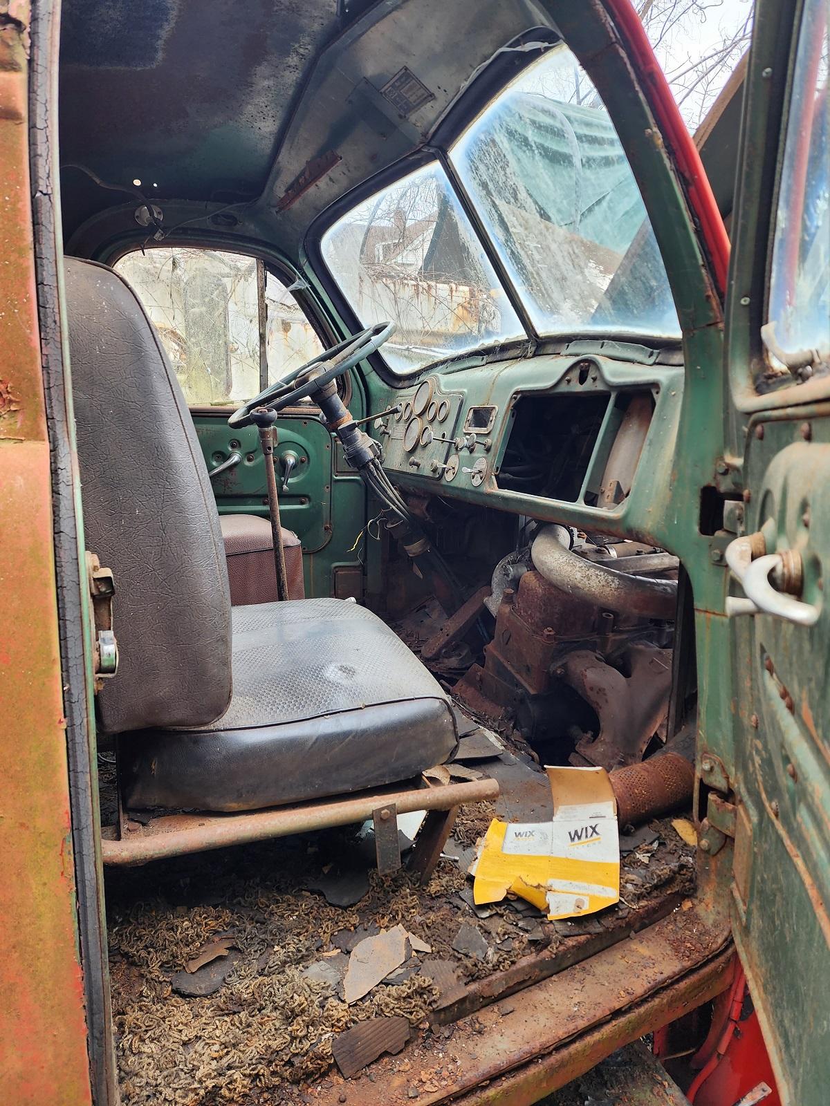

it's like an untouched piece of history. the brass emergency fuel shut off still there : even if it's disconnected. perry water filter , air valve passenger side fire wall was a major discussion a while back  ; someone having tractor/ trailer air issue . mice still there and not paying rent = good air compressor and blast them out .LOL

The contour cab was an option. On several models, including the B67. Most people don’t want the contour cab because of the decreased room in the cab. It would decrease the uniqueness of the truck to put a flat back cab on but not the value.  Have fun with it.  Mike

So the Truck is currently in Meriden CT, it will be going to Stratford VIA Wallingford. I work part-time for a truck repair shop and the boss gave the "okay" to tow in down to get it yard driving. I was tossing the idea of a standard cab mainly because there is another B model on site that has a decent cab, its a gas powered single axle dump truck, not sure what it is as far as numbers go.
I don't mind the contour cab...but the one on the truck I'm attempting to save is going to need A LOT of sheet metal work, and that assessment is even before pulling the front windscreens off.
If you think this truck is untouched, you should see the sister truck I picked up as a donor. Another B67, and old Pratt & Whitney truck (posted on FB "Scrap Macks" group. It still has the asbestos heat shields above the exhaust manifold, and all of the air plumbing is intact and neat, too bad the double frame is rust jacked and the cab is completely rusted away.

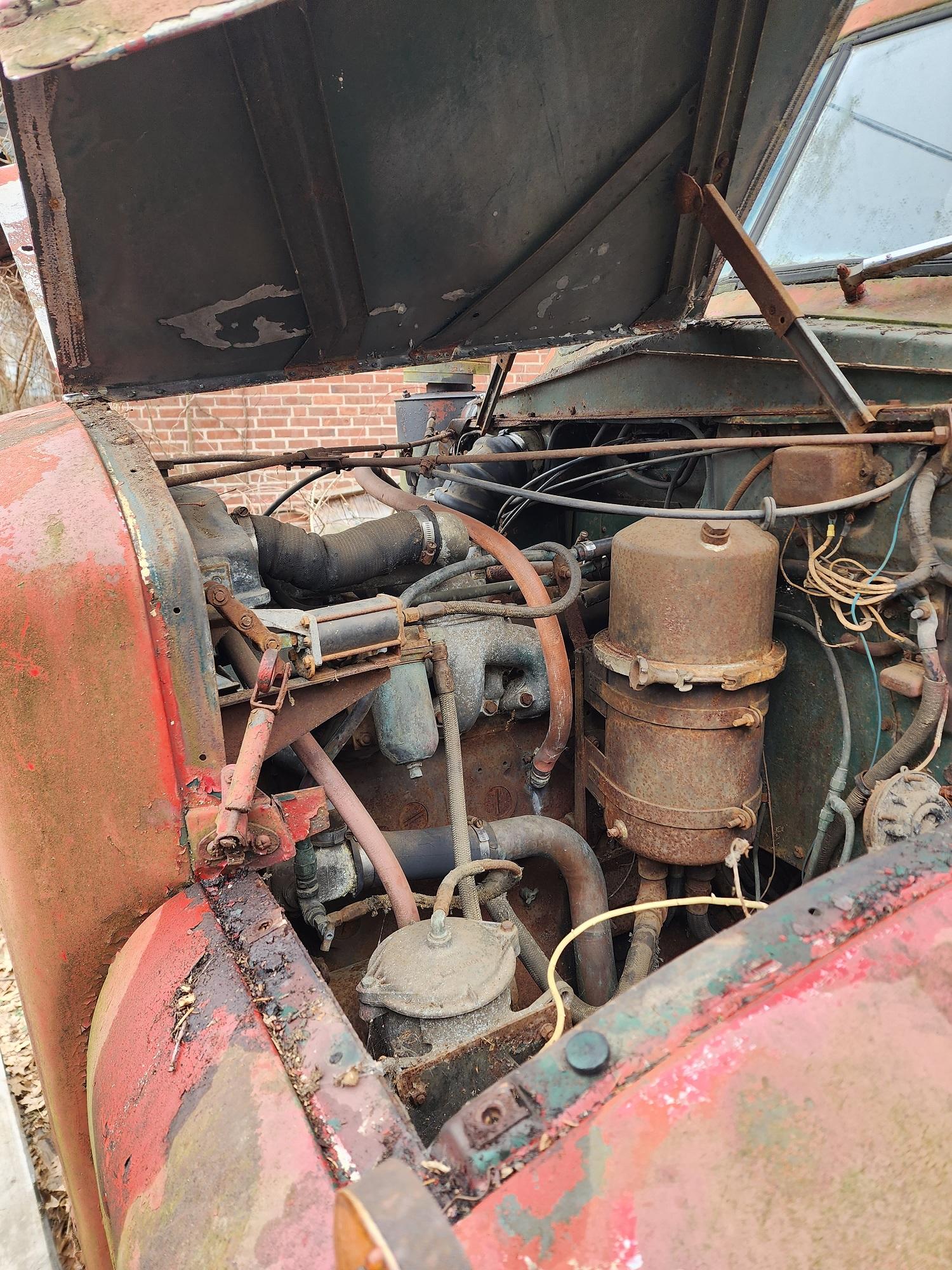

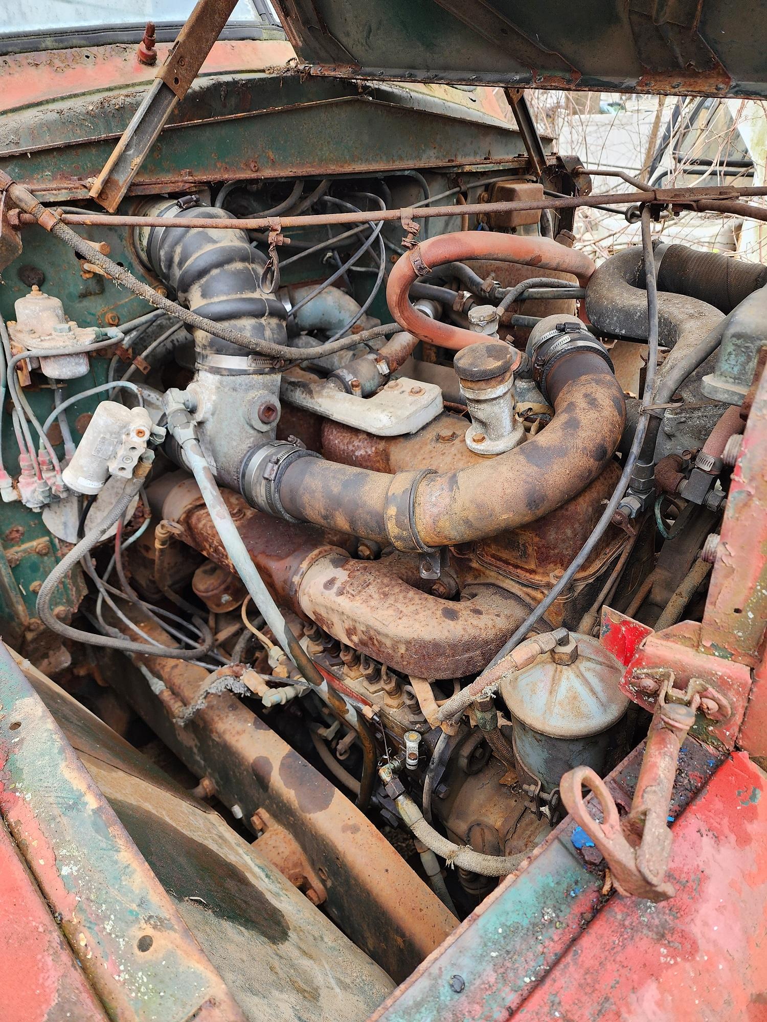

Excellent great choice take all injectors out and soak cylinder’s with mystery oil and oil and make sure turbo spins free as far as changing wheels.. to each his own but expect alotta running around for the parts… good luck bud… Bob
I literally used most of the can of PB at the end of the day to spray down all of the fittings that connect to the injectors, they looked like they were going to be a fight. Most things so far have come apart pretty quickly and easily.
Monday I'll be ordering up the main supply line that feeds the air starter from the air start tank.

Almost looks like a shifter for a Monoshift in that one picture.

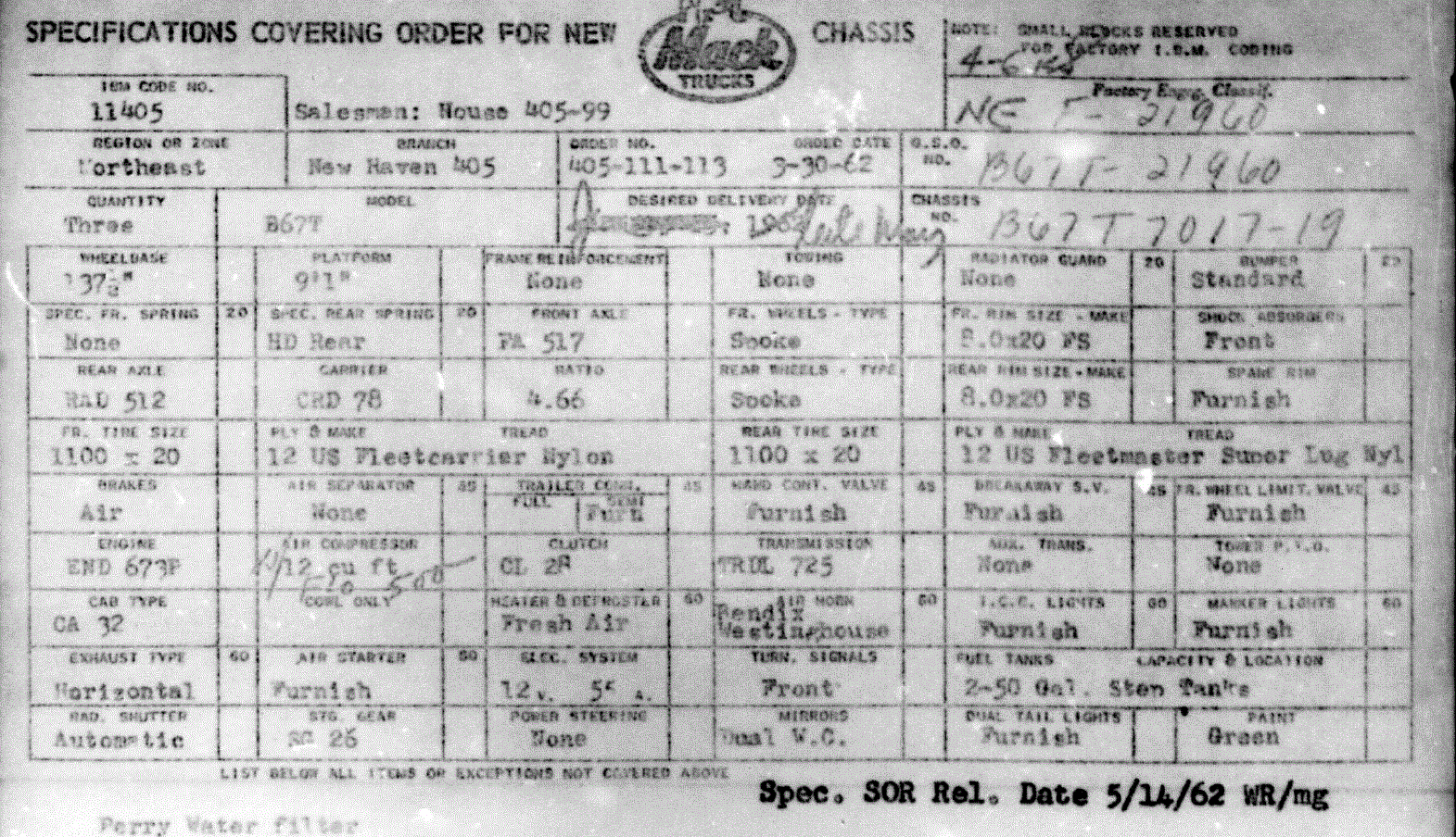

It is a Monoshift, I was fairly surprised at it when I found out, I had initially assumed that all older Mack's had twin stick setups. The Mack Museum was able to get me the original spec sheet and this truck was built with the monoshift. The other truck (donor) has a twin stick setup. Spec_sheet.thumb.gif.77616e0d3eb878132277851debefa3df.gif
10 hours ago, mowerman said:
Oooooooooooooo never mind the turbo I see it’s naturally aspirated… Bob
You knew it was natural asper;;no turbo == YOU were checking to see how many were paying attention to the pictures LMAO :SMOKIE-RT:
