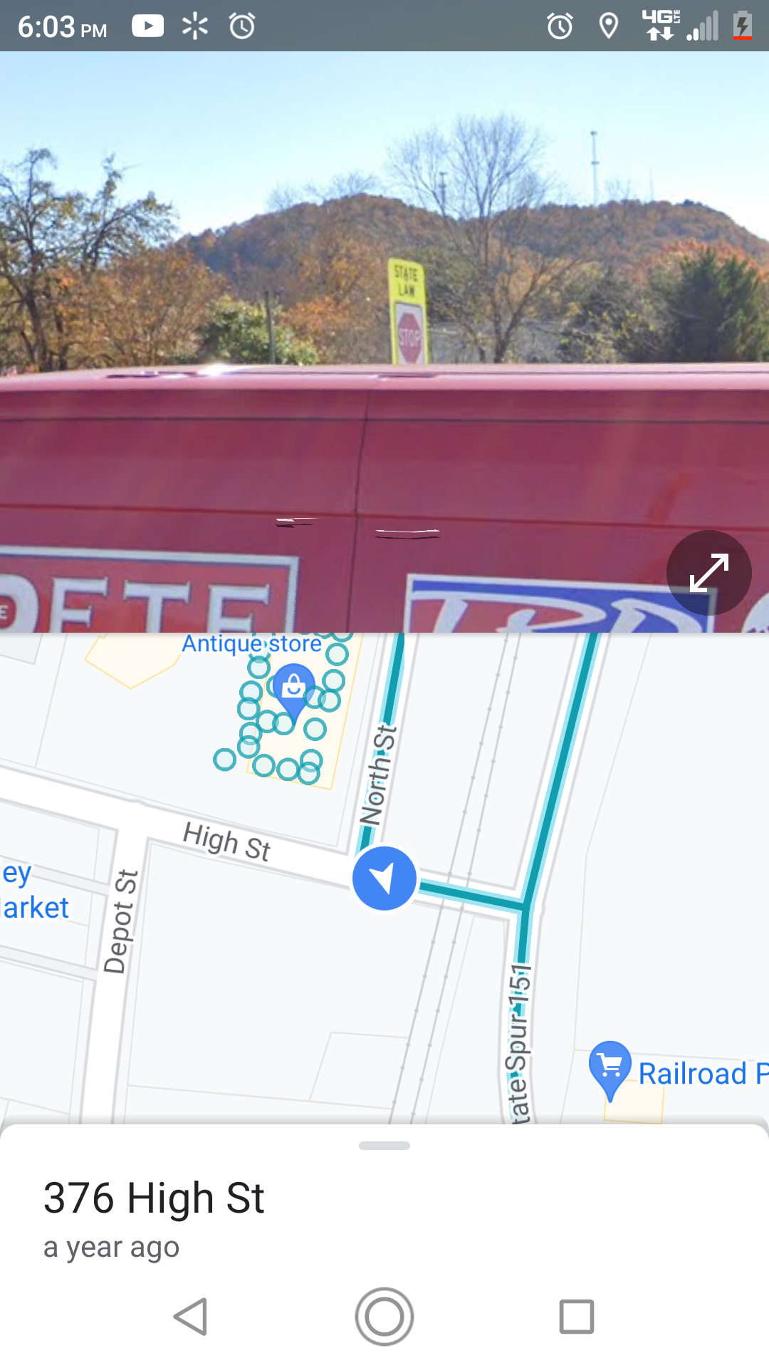

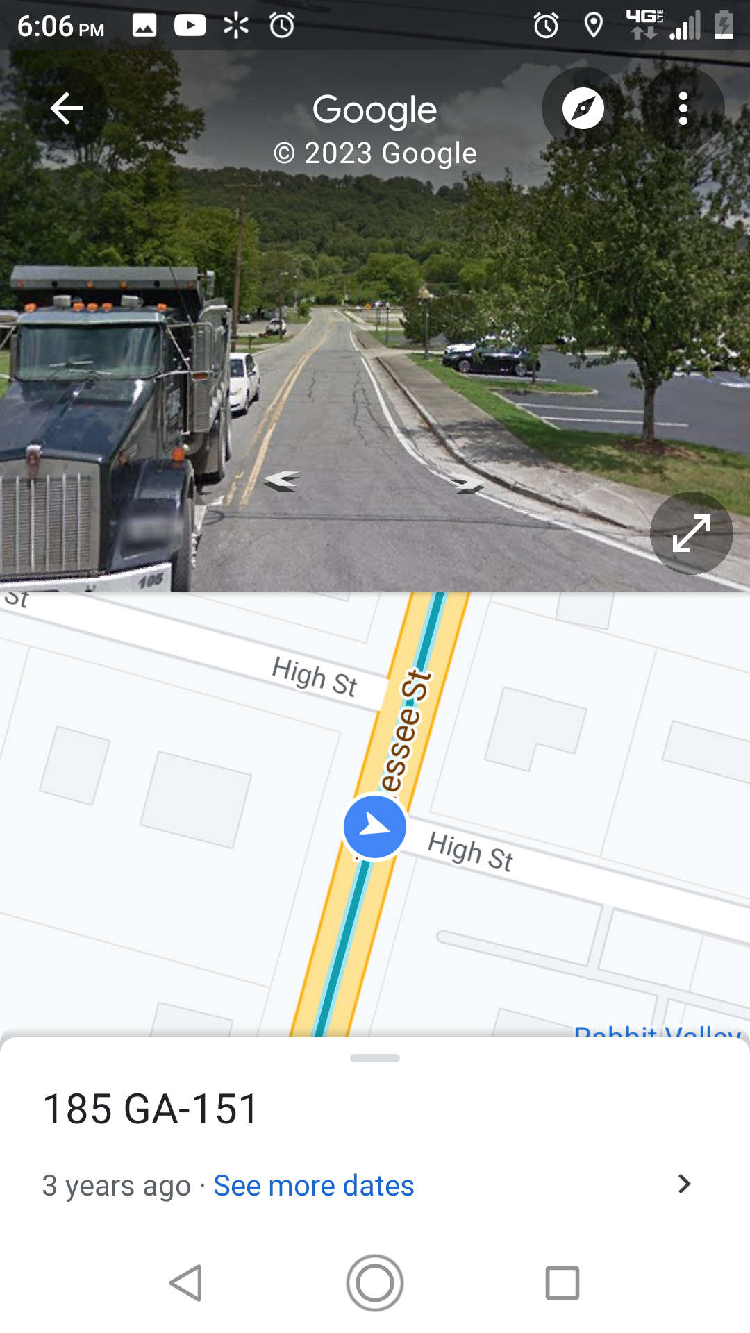

Google Street View of the intersection doesn't show any low ground clearance signage, I'd be harping after the municipality and CSX that they should have had signs up with minimum ground clearance requirement signs.
I've never driven a low boy, but I have seen ground clearance signs for exactly this type of thing...
