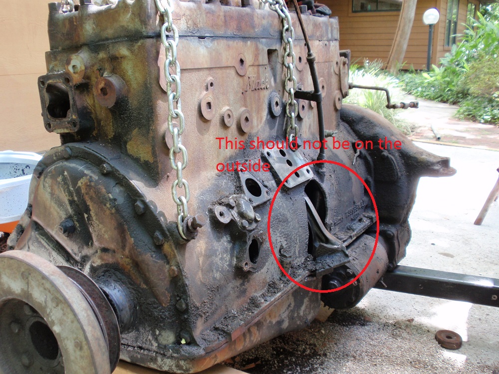

The Mack was gasoline with a rod through the block.
The Corvette was a '76, very undesirable.
mehhhh.  that rod just wanted a breath of fresh air!!!  😁
