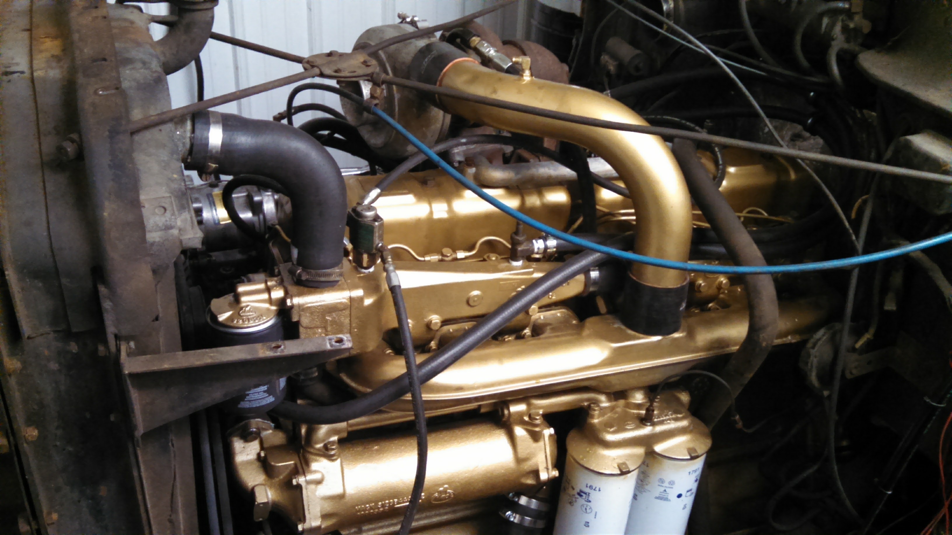

Well, I’ve let mystery oil sit in the cylinders (still only have the front head off) for about a week now and the oil has gone by the first two but still sitting on the #3 piston that looks like it got heated up. Will get the rear head off next week with any luck and do the same on those. The cylinder wall doesn’t look too bad either.   Might be able to make this one work with rings.

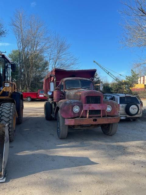

That said, I’m going to look at a donor truck on Monday that’s local to me. Runs great supposedly. Has an air start and is an ENDT. Do the turbos make much difference in HP?  It’s a 10 wheel dump truck which gets used regularly for the guys stone wash plant.  Has a quad box too which I really want over the duplex.  Body is rough, but that’s fine since the body I have is nice. Gotta see how it is. It’s the right price too and I have a guy who will haul it locally.
So, the two cylinders that let the oil by, they look real good. Top of piston too. Anyone think the rings are stuck in the piston grooves to have the oil leak by like that?  I’m probably gonna tear this whole motor down. May not get rebuilt, but we’ll see

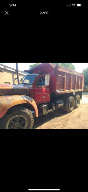

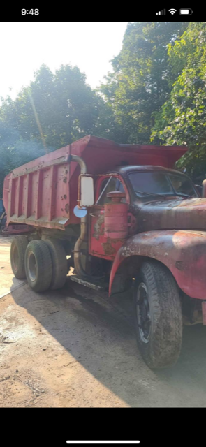

Hopefully have the donor truck Saturday. Really nice running ENDT 673. Air start, air assist steering. Runs and drives real nice. Duplex transmission. Dump body works well. Frame is nice. Stops really well. I might just put the nice body I have on this chassis. Not sure what I’m doing yet, but the price was right and it runs great. I have a video but not sure I can load it on here
