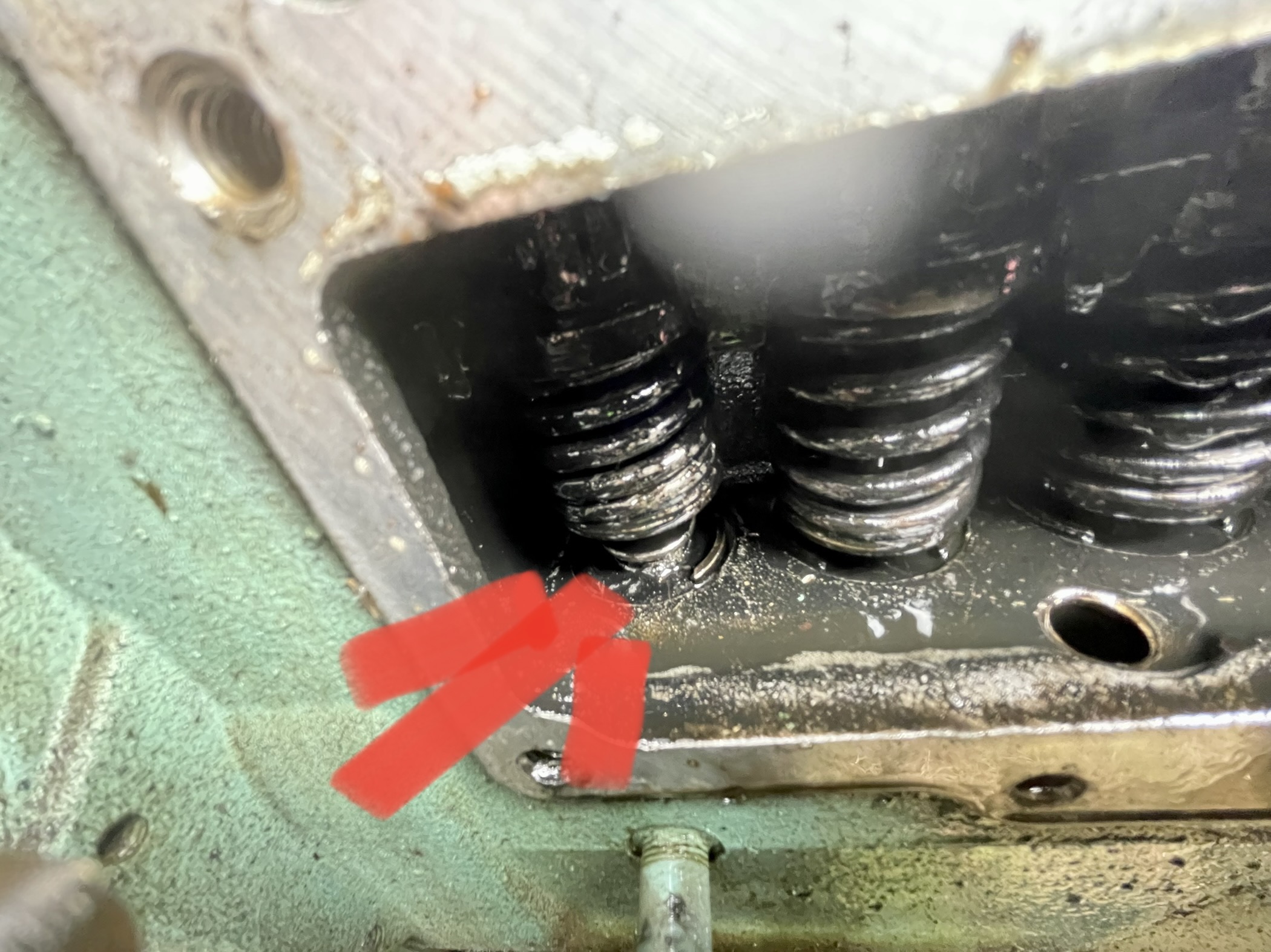

Engine was running as expected and then three weeks later when started it went to max rpm and will not idle. throttle linkage was checked and all appropriate still will not start and run it at idle. It’s not a runaway just goes to max RPM. Have to stall eng to stop the shut off will not stop it.
You can pull the cover off the injection pump and free up the rack.
I had a couple plungers stuck on my 237 when I bought it.  A screwdriver and some WD40 got them freed up.

Took the side cover off and this is what I found. #6 spring is jammed.  I have tapped it and soaked it and it hasn’t’t released. Any suggestions or do I need to take it out, and how would that be done?
Gotta echo what Glenn said.  Springs don't get stuck.  The plunger that the spring is attached to is what is stuck.

So is it oil lubrication or fuel lubrication that controls that?  Time for some fuel additive and let it run before parking it?
Larry
I agree with Larry.. Your picture of Sept 13 shows a lot of GOOP around the springs, is there more elsewhere???? I would get this stuck one loose and get the lube changed and let it run for a while before parking it for the winter.. A long inactive period might just set things up worse??????????????
Brocky
Get it running and pull the hand throttle out to like 1000 rpm.  Let it run for 1/2hr or so.  Make sure the temp is up, block radiator if shutters don't work.
