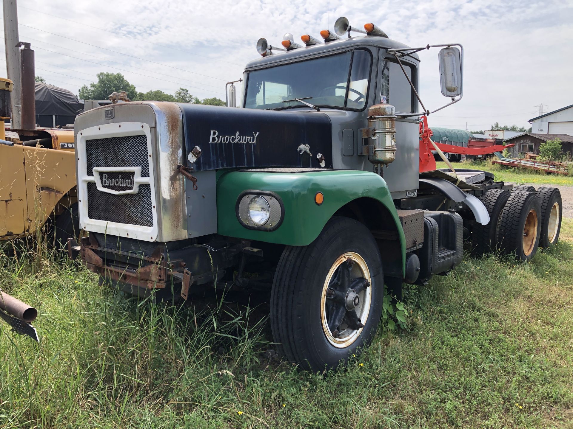

sweet looking brockway.Β
i ran one just like that back in the mid 80's as a lowboy tractor.Β
only issue was the cab was rotted out and ready to fall off it, and it had tiny rears.
350 cummins and a 13 speed.Β

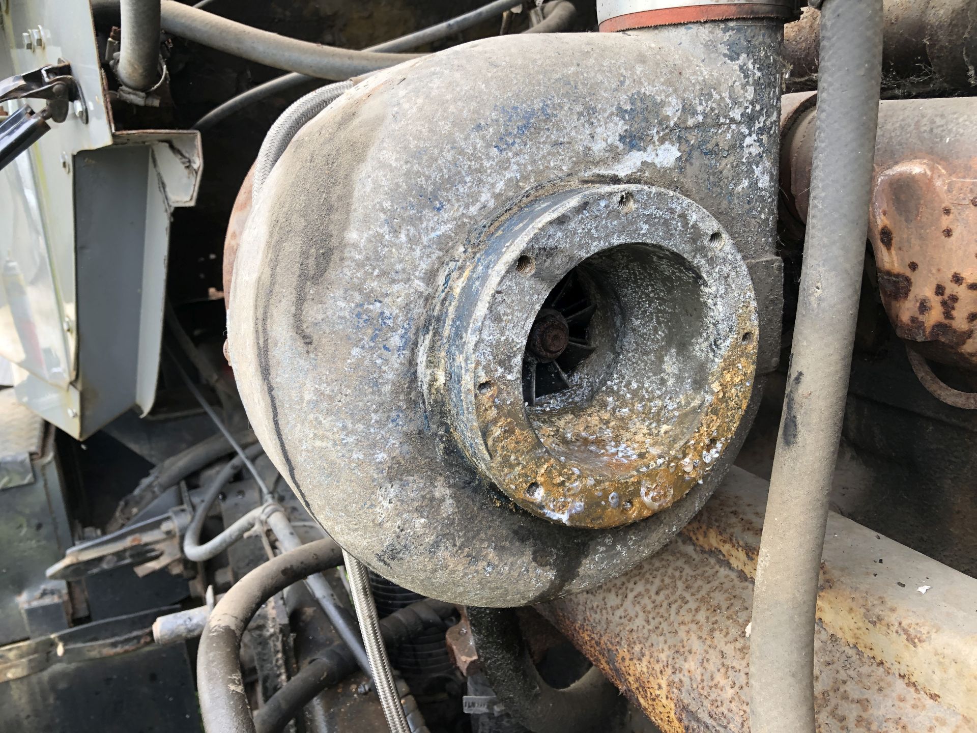

It should run with out the turbo, block off the oil lines and it should run
It will be smokey umder load but should idle pretty much the same as if it was turbocharged, the motor wont be making any boost at idle and stuff all boost until it gets some revs and loadΒ
