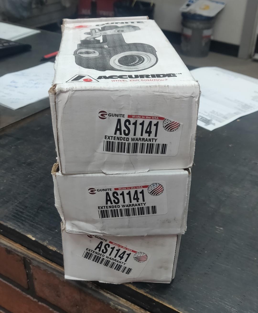

2000 rd688s
anybody have a good part number
I'm trying to order some online but wanna be sure I get the right parts
mack said they couldn't give out part numbers
imagine that 😳
Off the top of my head 44 rears on camelback would be a haldex 10144 and aftermarket uses the same numbers
8 hours ago, Hans Remmers said:
According to law I was told at a bendix foundation class they must be the same brand across an axle.  So even a haldex against a reproduction haldex can get you written up.
That there is pretty bad splitting of the hairs hairs! long as a slack is holding its set there should not be an issue!
yeah that seems like a stretch... hell, is there a law dog that would even know what they are looking at?  as long as they are the same style and 'Length' positioned in the same holes, I dont see a problem........  and I too, tried to buy auto slacks for a steer axle last week. i gave them the part number on the slack adjuster, (Mack dealer)... they said, I cant help you, I need a VIN and need to see them..  I explained the truck was an '86 Superliner.  "Well I need a VIN"...  what a pain in the A$$... jojo
