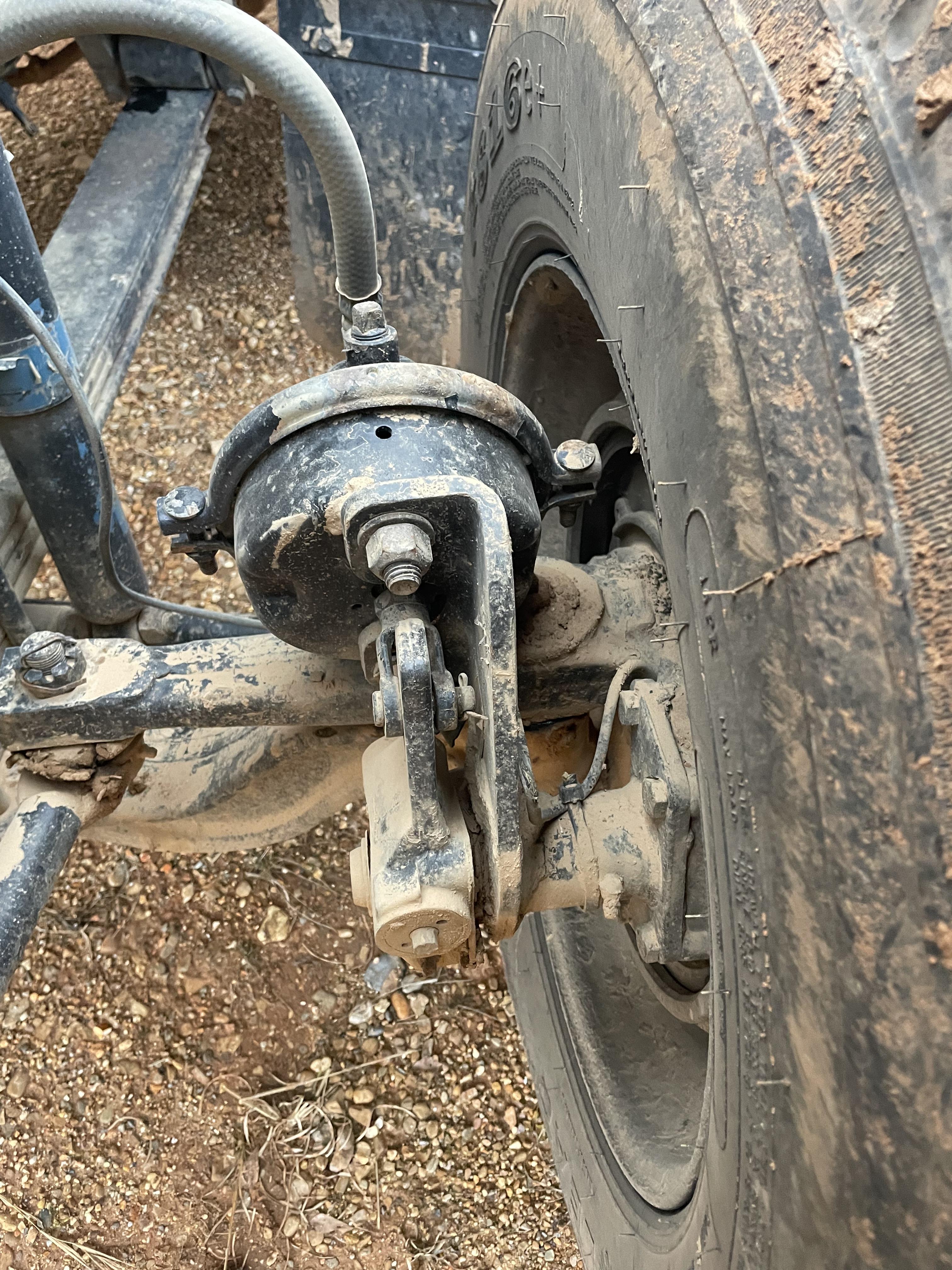

17 hours ago, Onyx610 said:
Good solid piece of wood and how ever long you need to to get between the tire and frame. Once you turn the wheel into it the distance will close. Your just using the power steering to help you move the axle beam which would show a loose spring pack or bushings If worn. It won’t hurt anything as long as the wood isn’t on like a abs modulator valve or something haha.
Onyx610 I just don’t see where to wedge a block of wood at to turn steer tire into it. Like I said never seen it done so having to visualize it. The brake can in the way on top and nothing to wedge on the bottom
Edited by Ricky Beals

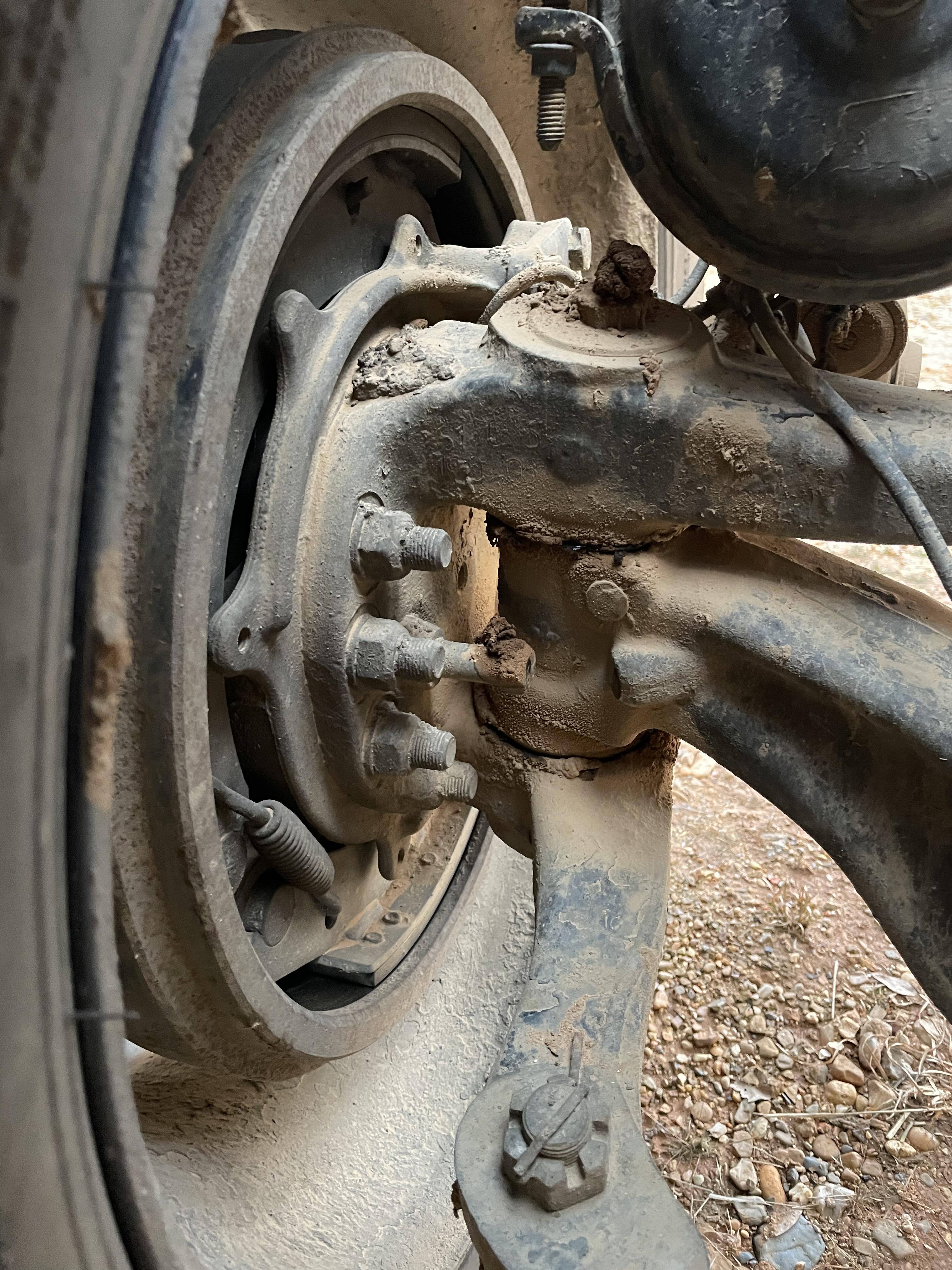

You can actually see the bushing out of center in that one picture and the leafs are worn into one another. Time for some new springs and you'll need someone to either find you the heaviest to fit the chassis or add to it like someone already did.  They're only rubber bushings and not very good at taking the pounding  greaseable pins and bushings will .
Sir ,what you are describing in my opinion are the bushings as you have suggested.our 2 mack chs have this problem.since they were over the road and since converted to dump truck the rubber bushings don't hold up.. usually we can get a year out of them.they are not greasable ,either in the front or the back at the spring hanger.They noise is most easily heard when turning loaded.see if upgraded polyurethane bushings are available in your area.. polyurethane usually last longer.. picture above from onyx is from an axle that has threaded pins and are greasable...and a later year model to yours ..indicated by the 3 holes on the pin,which I believe is a Volvo design.
Where do you see the springs worn into one another. I can’t see what you see.
For a quick check I use a small bottle jack on the spring behind the axle to jack against the frame just a little bit and remove the shackle and you can then check the bushings and pins
I'm thinking you may need to remove the springs and frame hangers and take to a shop with a press.. I have done then on the truck and I had to get creative to get the new ones in. the old ones are usually so bad that the pin will come out and then I cut the rubber and bushing with a sawz all, yes i do nick the boss but I had to do what I had to do.. then I buff the boss with a flapper wheel. then I fight and curse trying to press the pin in the hanger..  in recent years i send them out to get pressed..  I wonder if there is a mobile service in youre area that has a portable hydraulic press..  jojo

I'm afraid that 1/2 drive won't be enough..u bolts are one time use since they stretch and the nuts on them pretty much weld themselves in with rust and road grime over time..we use a torch or cut off whel to cut them.
You can take them to your local springs shop or big truck parts store to be measured..while your there ,pick up a spring center bolt.this is the bolt that keeps the whole spring pack together..it's doweled at the bottom to center springs pack into the axle..we use a one inch drive impact with short anvil to tighten the u bolts.. tighten evenly and don't forget to put back the wedge...that's what sets your caster .let us know.
Red
Ps: there's a channel on YouTube called "semi working"..he does this for a living and has a videos on macks too.good luck.

We just take spring pack and have the shop press the bushings in..3 spring should be enough for a tandem truck grossing less than 50k pounds I believe.we use 4 springs ,since the trucks are tri axles and run gross around 55k to 57k pounds .
Been as the spring is only single wrapped, or at least it appears to be
What I mean by that is for many many years, like 40 years or more 1 spring makes the eye for the shakle and next leaf makes a bigger eye around that eye but loose encase the end of the spring breaks off you still have control
Anyway been that it looks like a single wrap around the shackle pin should be in the center I would think, it doesn't look anywhere near the center to my eyes by that photo
The bushes looked fairly flogged out, might be just the way the photo was taken
Paul
Edited by mrsmackpaul
Forget about doing it yourself,call a spring shop,they will give u a price to re bush with new pins over the phone,if u don’t have the bucks then keep on hauling,it’s not gonna brake anytime soon,when u get the bucks get it fixed…
I agree with macks ,the learning curve is to steep ..this is the front end we are talking about.something comes loose going down the road because of a error on your part and the results could be catastrophic..this is a dump truck we are talking about ,which carries the load , not pulls it..stubby one inch impact is the way to go...but that's just my .02¢...if your not tooled up to do it , just have someone else take care of it... besides the one inch impact , we use some 25 ton jacks , pry bars and engine driven air compressor big enough to provide the cfm for the impact to work like it should.let us know.
Red
if the picture of the rear spring hanger is the actual truck being discussed, this ole man wasn't that far off in the text of check rear hangers LOL,  picture looks as tho the pin in spring is way worn. i would take HD bottle jack ; 20 ton (over kill)  always worked for me. place jack on top of spring between spring and bottom of frame rail closest to rear  hanger , jack up to see how much play in pin bushing. looks definitely worn in picture. as previously stated; job for spring shop and not a safety hazard just a noise till $$ and time to tie up unit for proper repairs. almost looks like movement on the bolts holding rear hanger to frame -maybe not.
