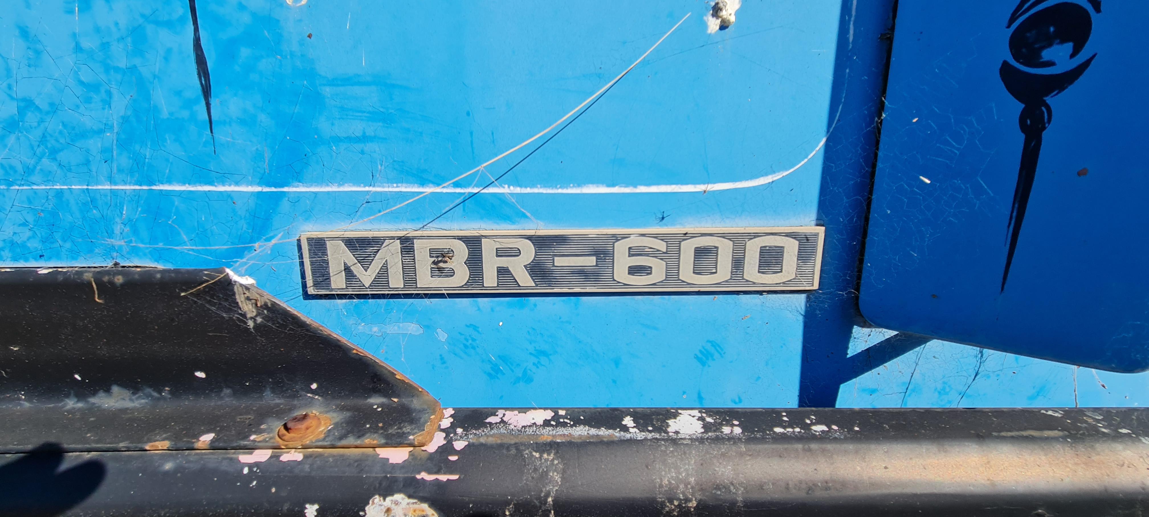

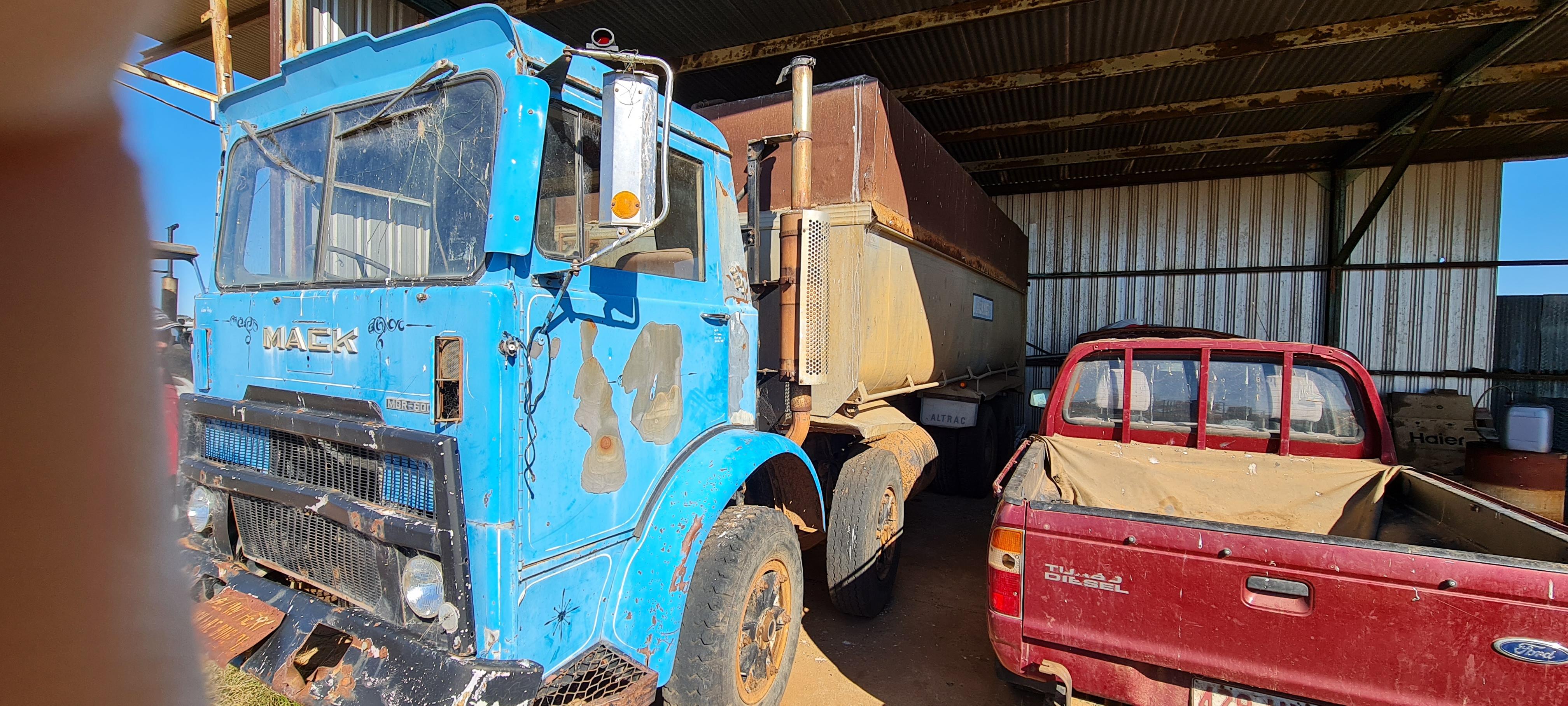

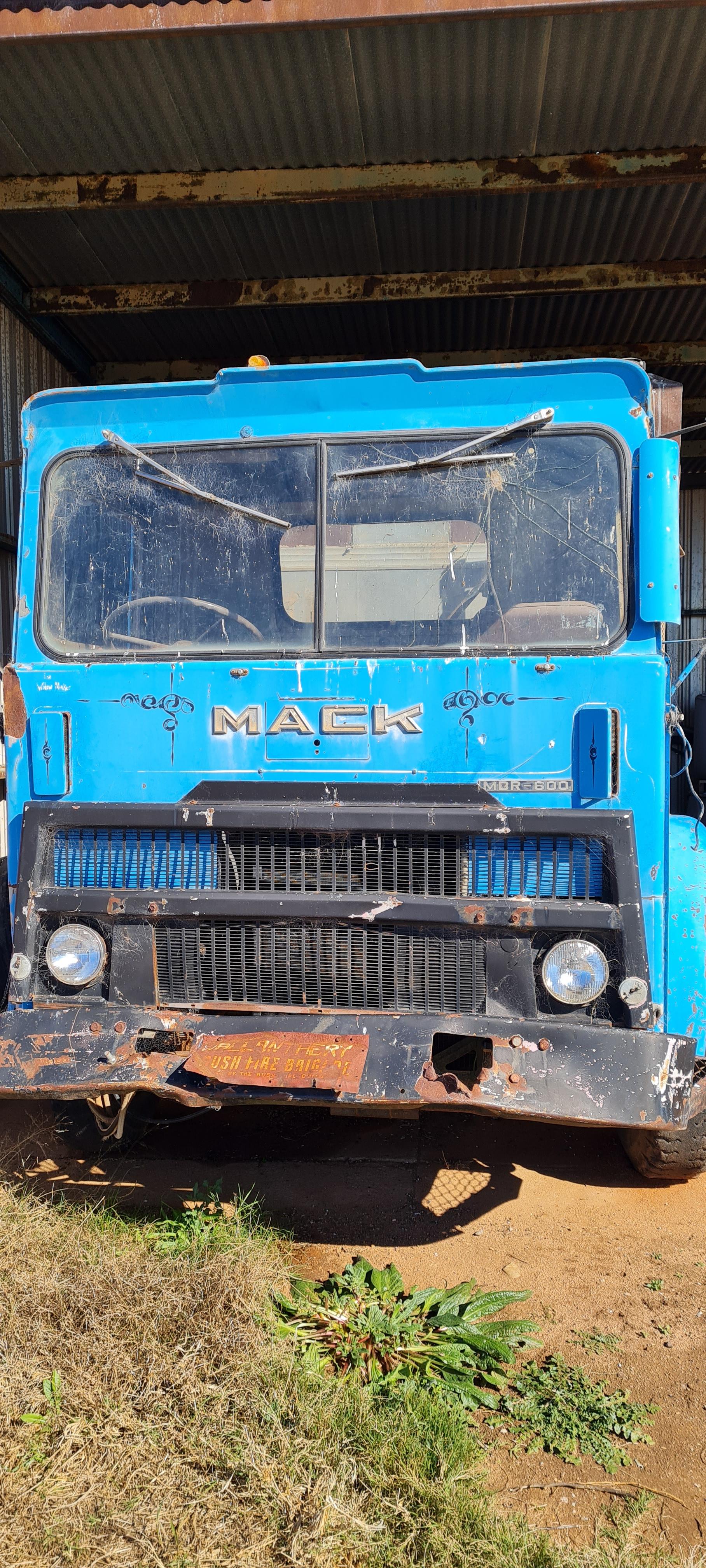

I have a few questions for all you MACK enthusiasts out there. My father and I bought an MACK MBR600 twin steer cab over tipper to cart grain around our properties in Central west NSW Australia. We have been unable to find ANY information on this truck or its lineage? Its an air start diesel with a 9 speed Road Ranger gearbox. Any help would be greatly appreciated!

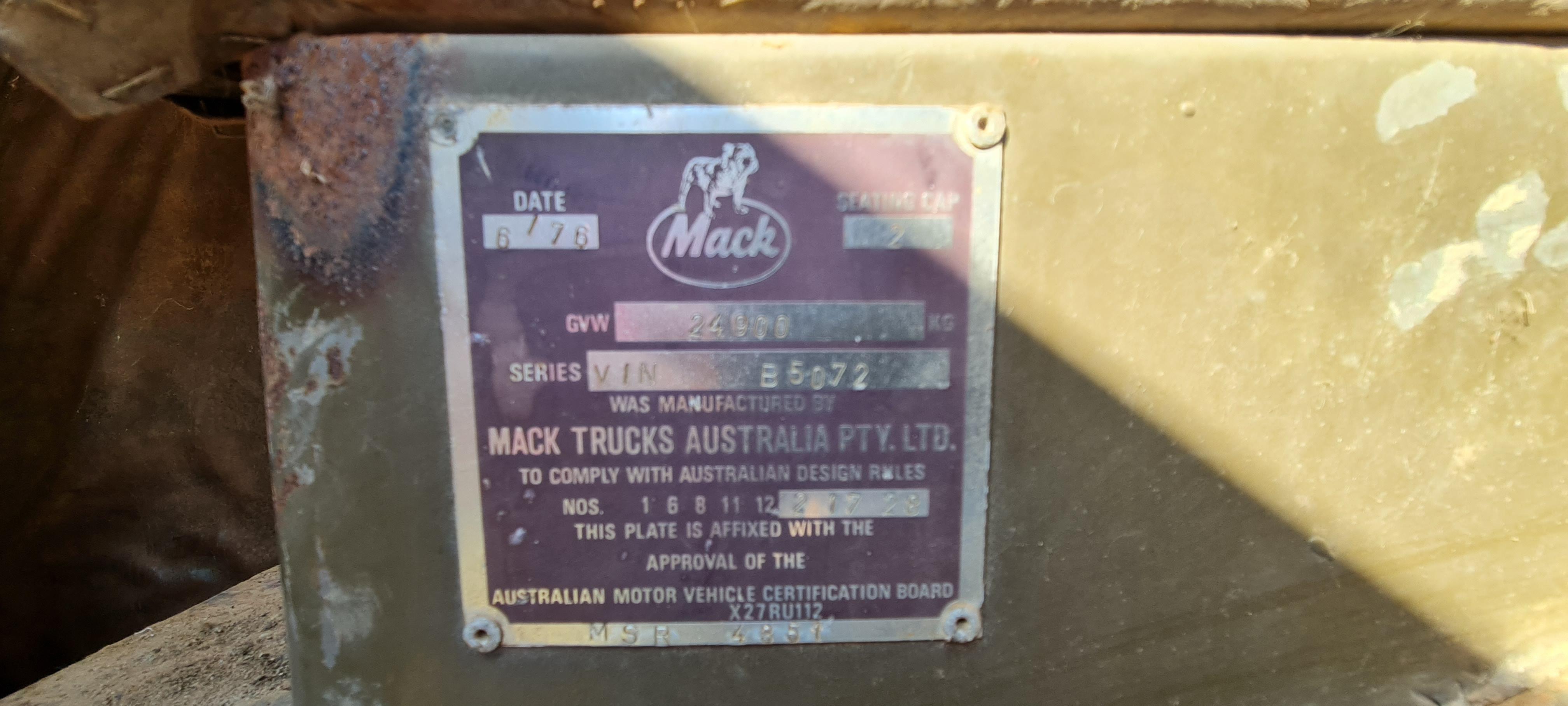

Photos of the motor and the plate on the motor should be able to tell you all you need to know
The chassis number is used for id in Australia on the older Macks like this even though most Mack dealers ask for the vin number they will soon go "it doesn't work"
So the chassis number is stamped behind the leading drive wheel drivers side on Australia

Make sure you have all the Numbers of the Plate inside the Cab. The Most Important one seem to be the M.S.R. (Mack Stock report) Number.

Is that Blue the Original Paint?

Ok guys thanks so much for all your help! I am going to start getting the old girl harvest ready tomorrow. She hasn't started in 6 months so it's going to take some coaxing into life. Sadly it's a pretty rough old truck but tough. Eaton 9 speed is a great box to learn on! 😄 more photos tomorrow...please go easy on the judgement on the trucks condition. We bought it as a paddock truck!

The same truck model in the US would be called MB. Your mark MBR means it's a MB built using R-model chassis as the most every Mack truck built in Australia was. So actually I expect finding a typical R-model chassis with typical (one of) in-line 6 cyl Mack engine (if it's a Mack engine) with a MB-model cab fitted on. I doubt it would be easy to find info on the particular model (but too possibly if someone in your country has a manual) but quite easy to find info on R-model chassis components and Mack engine. I'm pretty sure if you post some basic views of the engine and the chassis a lot of members on the forum would determine their kind and narrow down the search on the info sources.
Vlad
