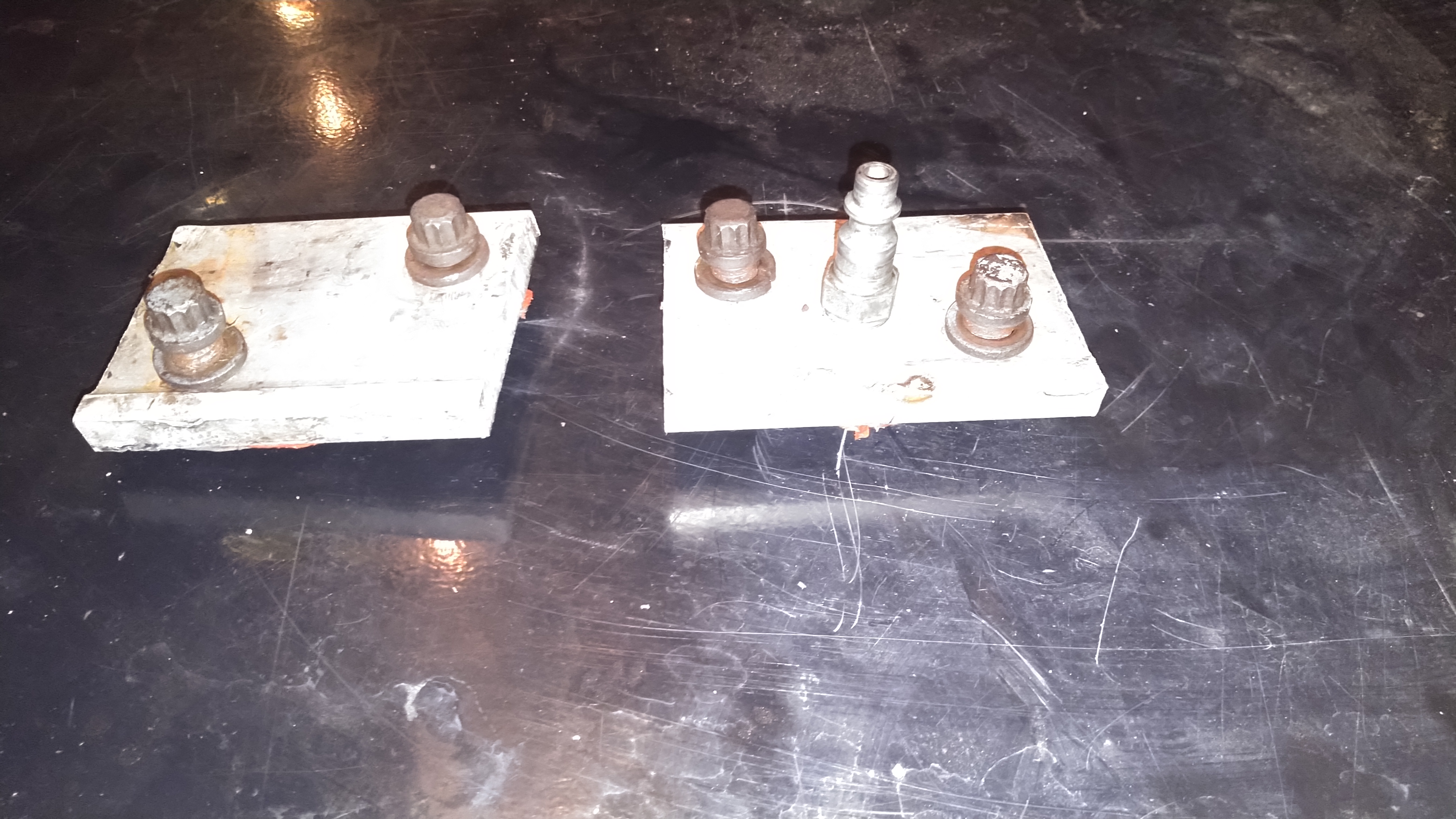

Bundle type oil cooler o-rings are still availlable... may i suggest pulling the oil filter pad and resealing it as well. you are already there. ... also you can make 2 simple little blocking plates to pressure test the oil cooler.. I did this a few years ago. I used 1/4" aluminum flat stock... I made 2 caps. In one of them I tapped 1/4 npt threads and installed an air compressor nipple.... The test is done at 80 P.S.I. in a tub of water.  I did this on an E-6 2 valve that I am building. In my case, My oil cooler was good...  Jojo
