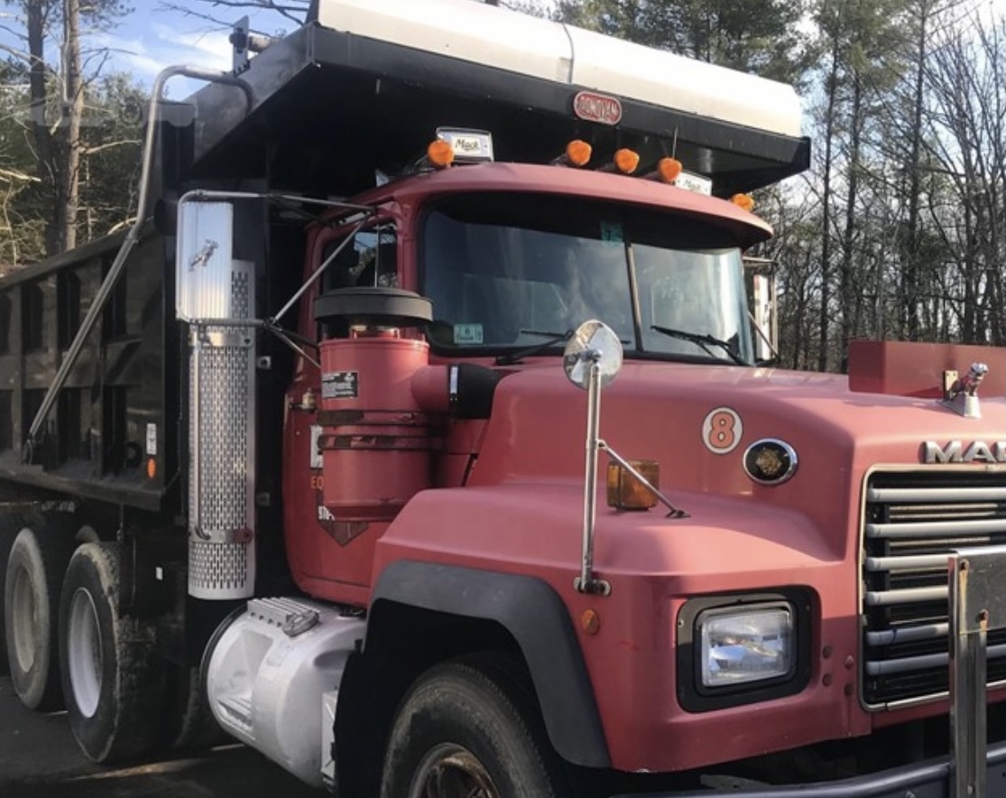

I decided to try to up by budget a bit, I found a 96 cl713 locally been rebuilt, has 7-800k total on truck. Price seems pretty fair for it. But it’s got a 18 speed. I don’t know much about the 18 speed but I feel like with an 18 your going to be shifting so much it’s going to get annoying. But just figured id throw in a little update
