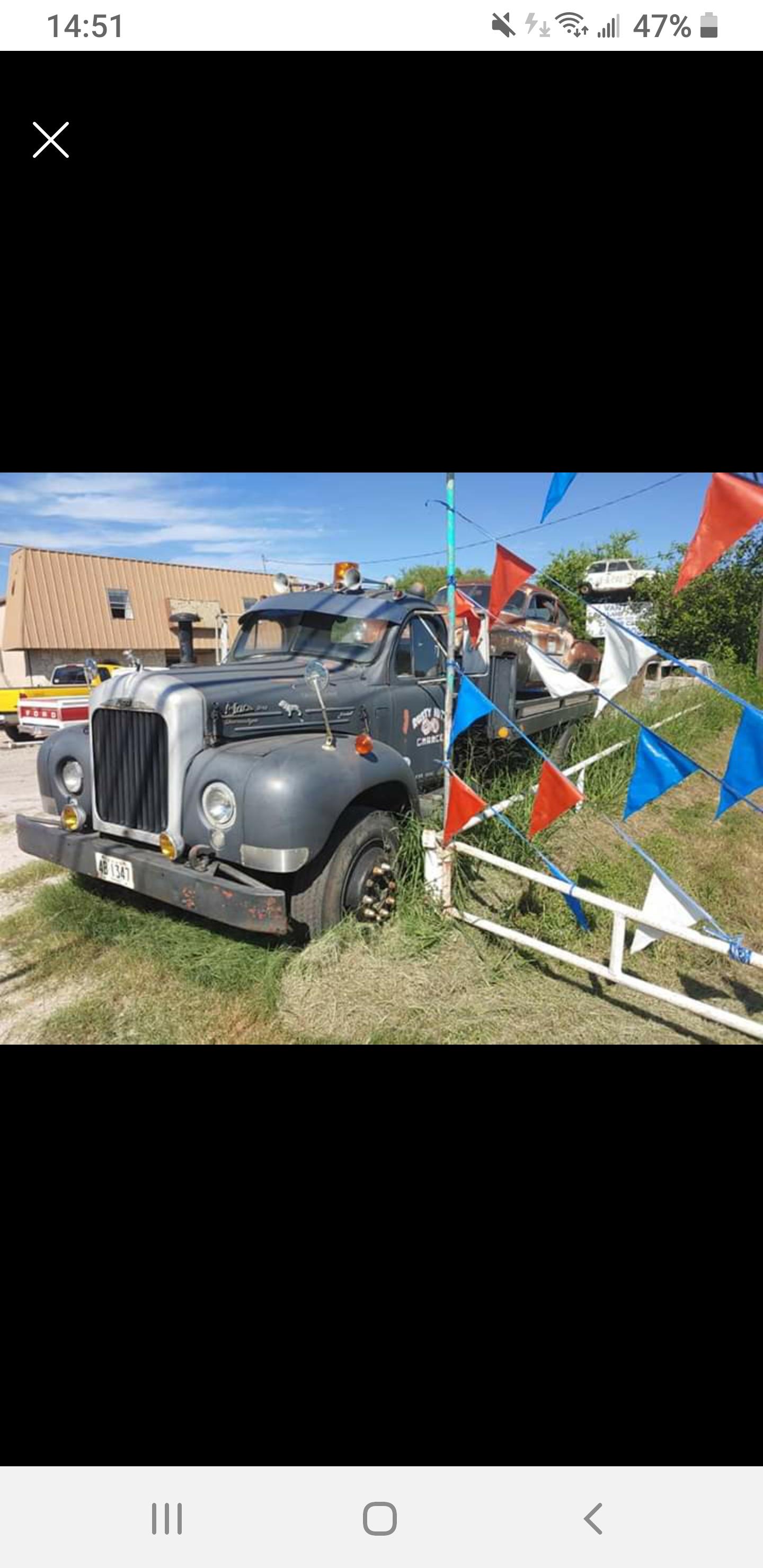

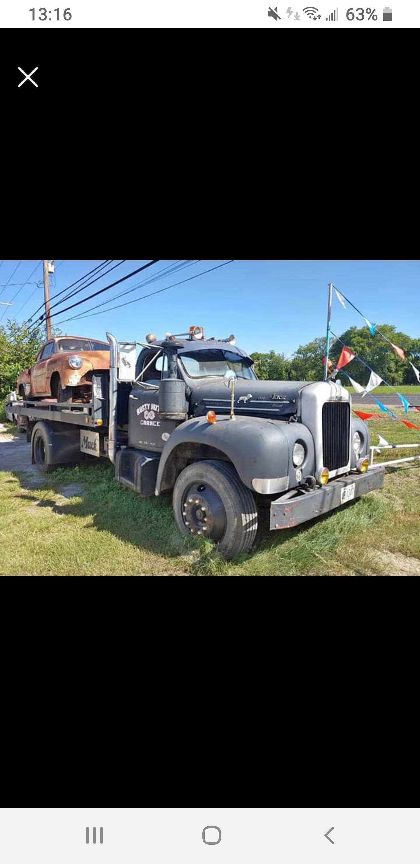

To start off, I am almost totally ignorant when it comes to Mack but have experience with other diesels, multifulers, and gassers. Recently while looking for a car hauler I came across a 1961 B61 mack that was converted into a roll off tow truck. The seller told me that it has a 6 speed and a thermodyne engine which tops out at about 60 mph. Here is where my questions come in:
1. Can you get a Thermodyne and a 6 speed or is he mistaken and the engine is a Maxidyne? (I have not seen it in person yet as it is a bit of a drive to get to)
2. Seems pretty easy to change the rear end or gear ratio to get somethingmore freeway friendly. Is this something that the engine and transmission can handle?
3. Other than the obvious hard starts, white smoke, blowby, fuel or coolant contamination in oil, knocking and other odd noises what else should I be looking for?
Thank you again!
that old horse looks really good in the pics. if he`s not looking for both arms and one leg for it`it could be a keeper. I`d say say go look it over thoroughly for rust & such. as you said power & running gear can be changed . & welcome to the forum          also not likely a maxidyne . trans could be a duplex 5x2 mistaken for a 6 spd.

Went to go look at it yesterday.... the cab had lots of rust around the front windows, driver's side cab corner and a bit in the passenger door. Not terrible but not great either as there was lots of bondo covering other parts of the cab. Passenger door fit terrible. The wiper motors and hardware was missing and the holes were silicone shut. The rear diff was puking out gear oil from the pinion seal and had a lot of vibration above 45 mph. Not too big of a deal because I would want to replace it with something a bit higher geared. Drive shaftvm and U joints were all brand new. King pins had a bit of play in them but I did not notice unusual tire wear or steering issues. Engine was a maxidyne with a 5 speed duplex. Shifted as expected (double clutch every gear), the engine had minimal blow by, some oil seepage but nothing bad. Steered well, stopped great. The wrecker bed has several issues but still functioned OK but not completely safe and not completely dry. Had a few air leaks nothing too difficult to fix. Tires are old, 5 out of 6 seemed fine. Guy dropped his price to $7500 pretty quick, I am stuck at $6500 just incase the rear diff blows up on the 3 hour (at 45 to 50 mph) drive and I need to hire a medium duty wrecker to take it rest of the distance.
