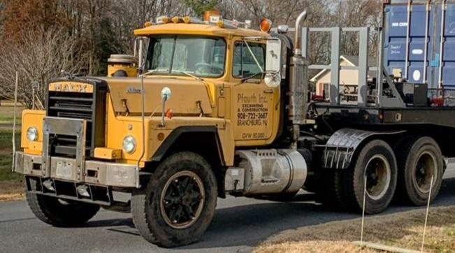

Pic of the truck?
Disregard the name on the door, that was the previous owner lol. I just joined the site so I'm new. I've been trying to research and learn more about his truck. I know it's an 85 RD688SX and it has a 350 2v and a 12spd. Has 67k original miles and everything works, including the heated mirrors and ac lol. It's going to get repainted in a few weeks, along with new exhaust, wheels and tires, led lights and some shiny stuff to dress it up
