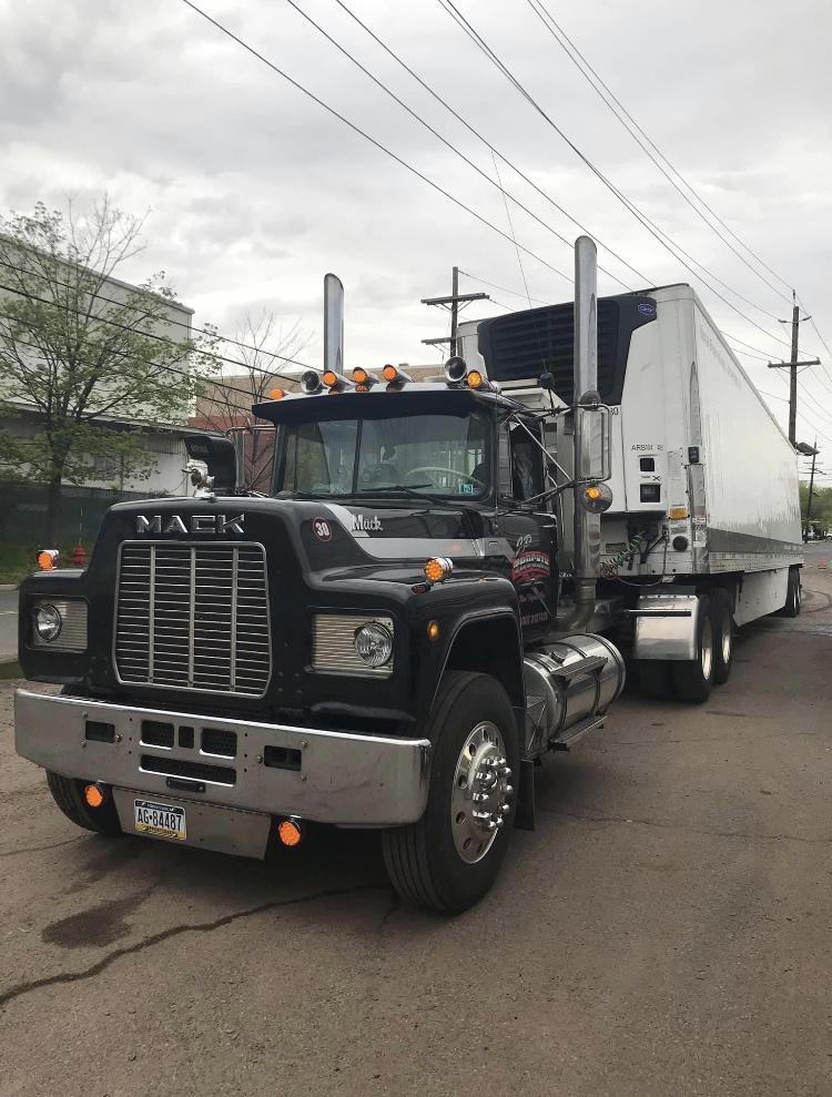

When did this grille come out in the R and DM or U? I always thought it was the same as the one in topic until the responses enlightened here that it was different
This one was attached straight onto the aftercooler. So I expect it appeared together with it. Starting from 1984 I guess. The models are usually 688 and could also be 690.

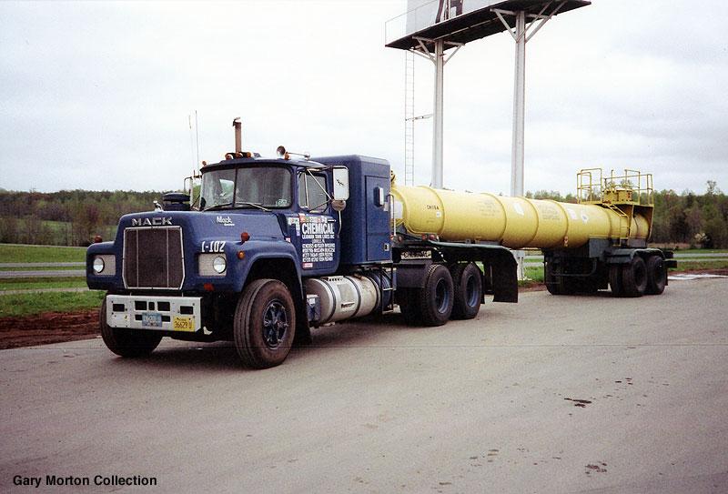

Wasn't there also a two bar vertical grill
Like this? More looks like it was a winterfront conteining two bars.

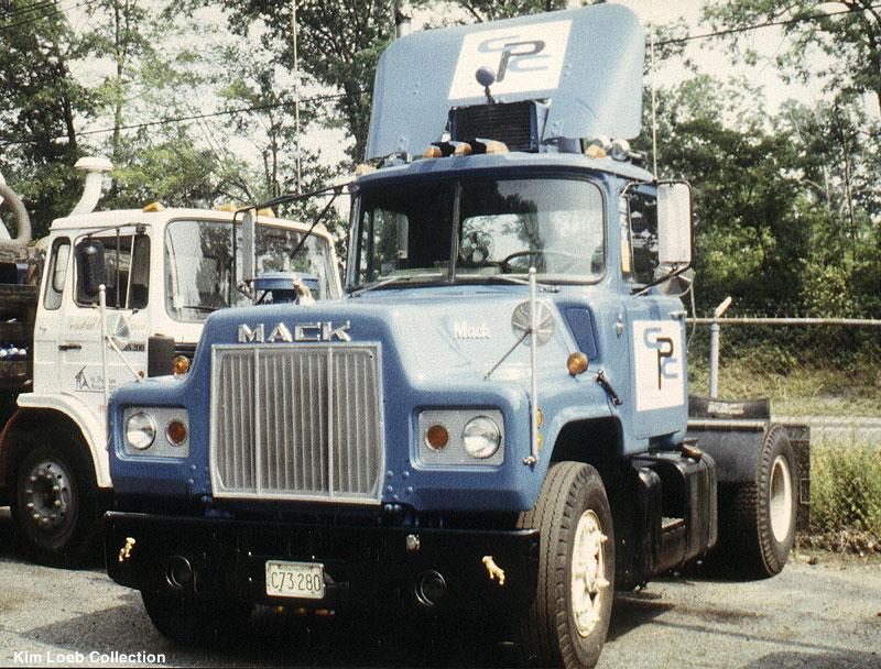

16 hours ago, Maddog13407 said:
our 82 R600 had the one like the pic i was referring to attached to the air the air. just a stainless thin look a like grille
Lengthened R-model hood is described like starting from 1982. Does this mean that CMCAC took place starting from that time either?
In 1982, the Tip Turbine (CMCAC) was beginning to be phased out and the ATAAC (air to air after cooled) was being used.  CMCAC stayed with the DM model for a while and steel noses for design issues.  No place to put the cooler in the front.
