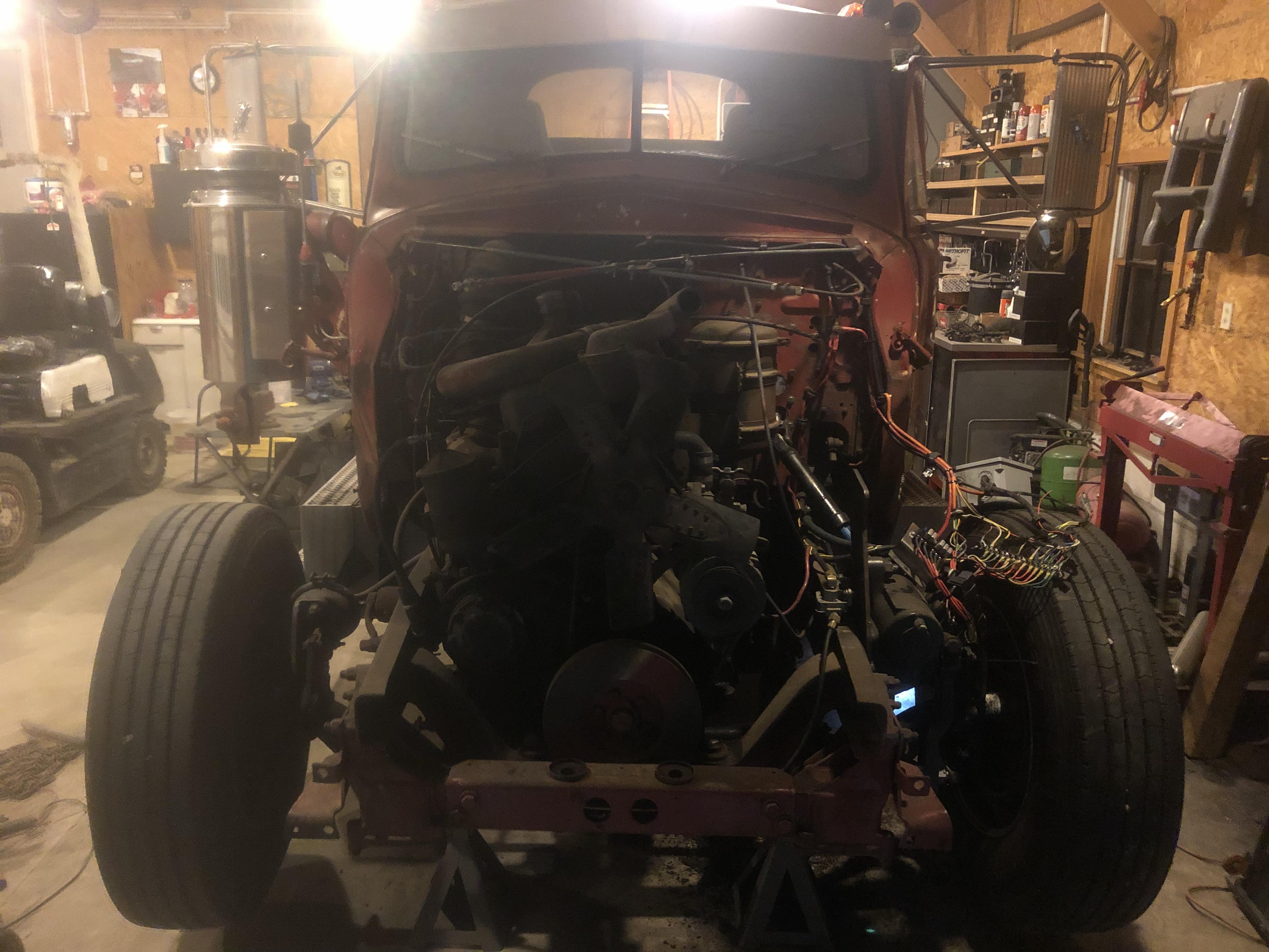

And so it begins
Hmm, that's gunno be interesting.  I know I made hooks to bolt on front and back of heads when I did mine.  You might have to sling it side to side inbetween the heads since the rear of engine is buried.

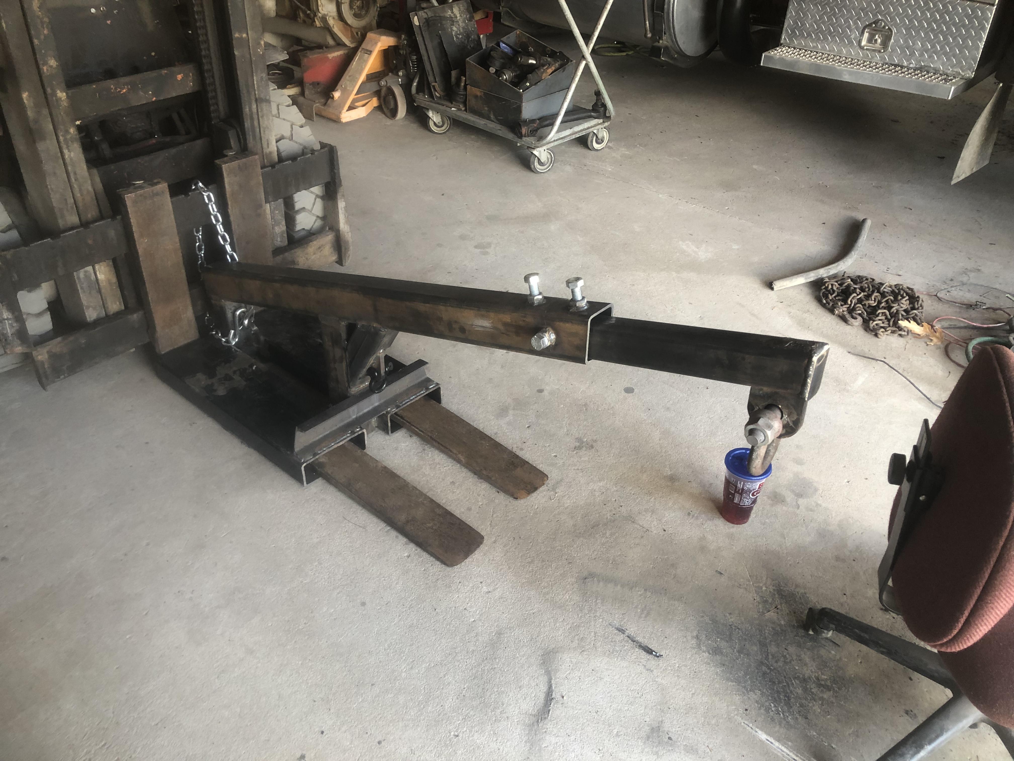

Your life very well can depend on what is on that hook remaining where you put it and that vendor is NOT the best choice with the inherent risk factor.
After removing the intake manifold, bolt onto the ports a strip of 1/2" steel with a pair of clevis or eyes welded to it. I like these types of clevis as easy to reposition: (Pack Of Grab Hooks 4) 5/16" Weld-On Forged Clevis Chain Grade 70 Industrial
You can "pick" from these points and the engine will want to roll slightly to the left as it breaks free of the bellhousing. It's more manageable if the transmission is removed from the truck first.

After removing the intake manifold, bolt onto the ports a strip of 1/2" steel with a pair of clevis or eyes welded to it. You can "pick" from these points and the engine will want to roll slightly as it breaks free of the bellhousing. It's more manageable if the transmission is removed from the truck first.

That is what I did but my lifting bar was a bit different and experimented with to find center, or balance point. I had the luxury of an engine on the floor from a donor to build from however.

Car engine 400#.  Mack truck engine 1500#.  I dont care how Harbor Fraud lists it, I wouldn't use it.
I wouldn't trust it with 400# either.
Mine failed with a a GM 3.4ltr engine going into a Monte Carlo which is not a heavy engine by any means.

I have one similar but without taking heads off there’s no way it would fit.   Being a b67 my front end is 8” shorter then a standard B.    The back 1/3 of motor is crammed in a dog house under the dash.

Inferior is just an  opinion I guess.   If being able to get parts off the shelf about anywhere, almost twice the hp and torque as my n/a673,  being 100 + cubic inches smaller making fit better, and the fact it’s been around for 30 years makes it inferior, then I guess it is.    I also have freightliner air ride,  power steering from a fl70, and front axle from a fld120.  I’m building the truck to use and abuse with parts that are reliable, easily available to me, and have people experienced in working on them.    And mostly because I want to.
Then it would have been nice of you to start with a less complete truck rather than butchering a complete one. IMHO
