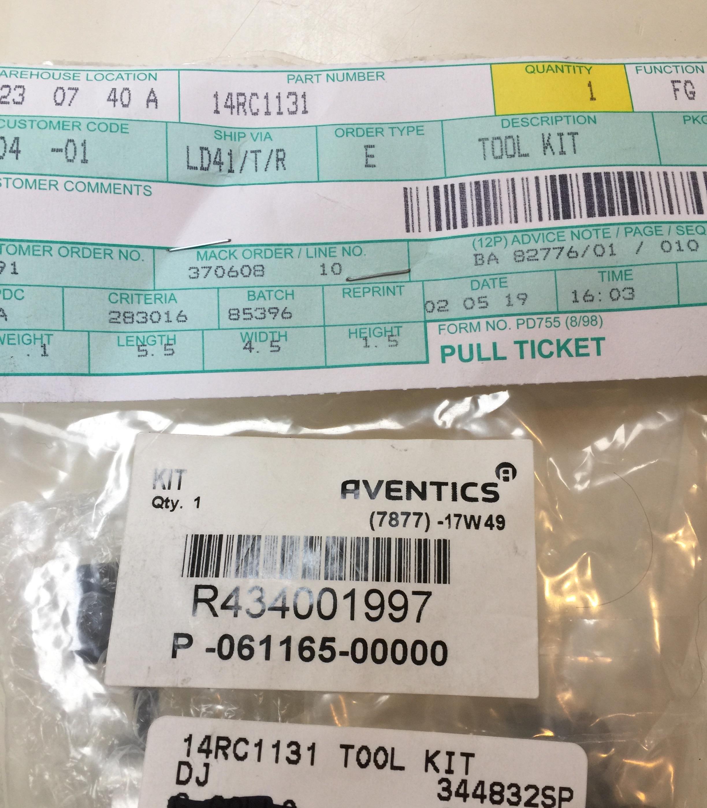

My selector is dumping air like crazy so I'll attempt to rebuild it,got this kit a Mack is has the barrel and every thing else in there I hope,they banged me 226 bucks,a new one is 400,here's the part number if anyone needs it.

As the old saying goes, "can't rape the willing" . Take that ridiculous thing back and pay whatever restock they charge. PAI Industries sells that same branded kit for $55.34, available, in-stock @ Georgia's PDC. The PAI conversion part number is FKT-1148.

14RC1131 is indeed the part number for the rebuild kit, but did you mean to say $226.....or $26?   It used to sell under $30.
No 226, I said wtf I might as well buy a complete one he looks it up,over 400 bucks..two months ago I went to them for two cab mounts for my cl,already found em line for 120 each,well Mack wanted 260 each,I said no that's for two,nope head honcho in he back confirmed 260 each..I just walked out,crazy chit going on with them..
