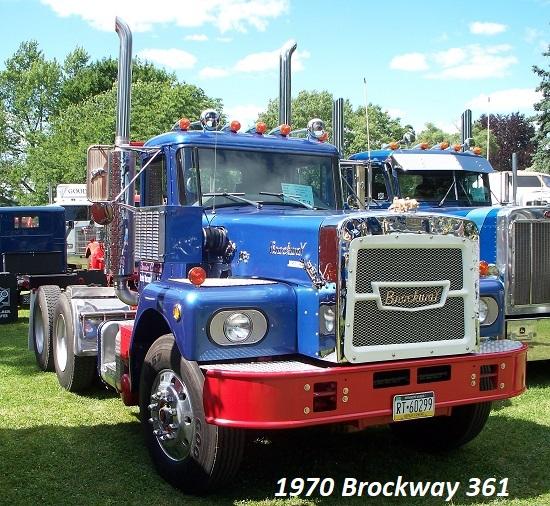

The Blue Huskie  picturesd is owned by some friends of mine Joe and Tom Marushin from Hazleton,Penna. area. They have a few other Brockways also not selling them though.

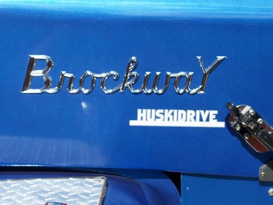

On 7/11/2018 at 8:42 AM, j hancock said:
Huskidrive was introduced by Brockway Trucks in 1968.  It utilized a high torque rise Cummins in conjunction with a Fuller 5 speed transmission with Eaton 2 speed rears (5.05/3.70 ratios).   Power or economy at a flip of the switch.
A truck with Huskidrive featured two Husky dogs on top of the hood.
The Huskidrive was in competition with the Mack Maxidyne system which had been introduced mid decade.  Brockway Trucks was an autonomous division of Mack since 1956.
