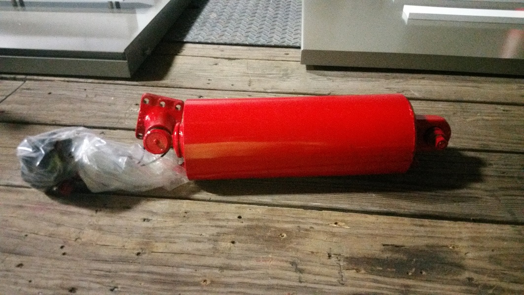

My Autocar had Air-O-Matic when I got it and although it made it possible to turn the steering wheel after a couple of turns back and forth the maxis would come on. I took it out and armstronged it for the last few years.
After a couple of times being embarrassed backing my short single axle Shertzer I had to do something so I sucked it up and dropped $700 on a rebuild and although I swore it wouldn't go back on it's going back on.
It probably would have helped if I had held off on taking it of because about 2 weeks later I met the original owner of the truck and he showed me the air valve under the dash where I could turn it on and off. He also told me that before it had the air assist he would put drivers he wanted to get rid of in this truck so they would quit. I don't know why but this is the hardest to turn truck I've ever been in.

I did add a tank, it couldn't keep up with the air leaking out of the piston. I guess it was in pretty bad shape internally.
Not to be Capt. Obvious, but I assume you have checked the steering for any place where it might be binding. If not try jacking it up and see how it turns with the weight off.
Steering box adjusted too tight?

Hi Carl, when the front is jacked up the it wheel spins like the big wheel on The Price Is Right. Now that it won't leak air so much I think it will be all right.

Could be thrust bearings. When I happened to meet the original owner he said it was always hard to steer since new. When I had it on the truck if you drove down a bumpy road it would try to turn into the nearest driveway on it's own.
