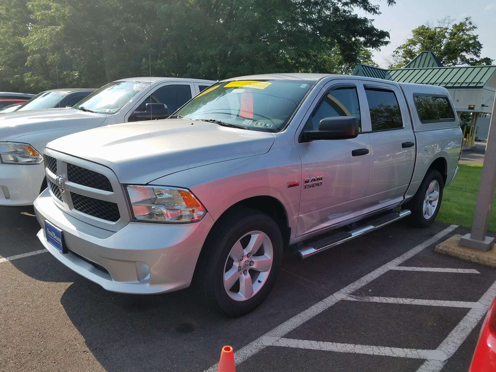

Here is the new (used) ride. 2013 Ram 4x4, 5.7 with the 8 speed. Full width rear doors. Took her out to Mechanicsburg Pa today for the part time job. 16.4 average mpg, had I not done so much local driving in town that would have been higher. Rides as smooth as butter melting on a hot buscuit.
