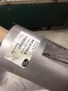

Rock got back to us with a stack muffler that will bolt on with no fabrication. It is a 5"inlet/5"outlet @ 51" length and 9" diameter.
PART #                      M-132
Cost w/mark-up     $127.00

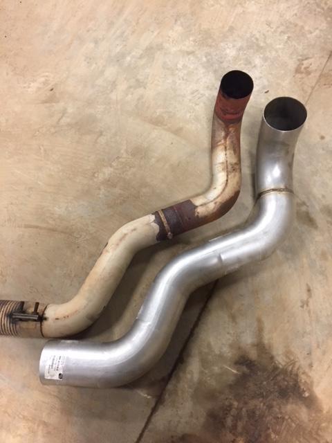

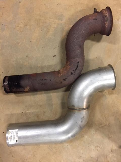

Stripped down the pipes and made a comparison of exhausts........looks really good.
Be Advised: When I came to pick up my pipes the final bill was almost double my original quote. I raised issue with my Mack Dealership parts guy and he went back on Grand Rock for satisfaction. They dropped the price to the original numbers I listed on this thread. If anyone buys from Grand I'm curious to know what the cost is? Are they going to jack it through the ceiling or was it a case of Grand actually investing a lot of retool and time to get this "first production" of a 5" custom? Hopefully just an attempt to recoup loss and the upgrade hasn't now become less practical due to expense.
Edited by Mack Technician
The pipes are a very good dimensional likeness.

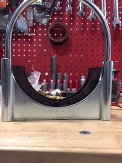

Note to user: Save yourself some trouble and pull the air cleaner housing, w/rubber inlet tube, right away. You are going to need to pull it to fit the 5" into the existing space so you may as well enjoy the accessibility while removing the 4". The 4" can be otherwise be removed and installed with the air cleaner in place.

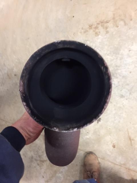

The Muffler purchased from Grand does not have a break-in baffle. It is straight through design. The pic is the closed baffle of the old muffler, we will see if the audible changed much. Yup, I did get a little medieval on the muffler to get it off....things been choking the dog for 12 years, why be nice?
The 4" clamp and 5" replacement are almost a perfect cross over. Everything must expand 1/2" wider from imagined center-line of exhaust and it is about a perfect 1/2" drop in the 5" saddle.
Exhaust is installed, sounds very conservative. The only difference is not in the baritone, but the whistle. The (now missing) baffle apparently reflected the sound of the turbo harmonics and it now has a magnified spooling sound.
You can hear the impeller talking, but the actual depth of tone is still very similar to what we had.

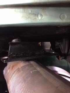

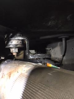

Everything fit perfect. Compress the flex pipe and cut an additional 6-7" beyond gap measurement for good solid overlap. Remember the cab bounce motion is completely absorbed in the flex pipe since stack is cab-hung. If you get cheap, and don't make a deep overlap, you will pay for it later with motion loosening clamps and wearing a slit cut in pipe. Make sure you get decent stainless steel flex, if it rusts to -zero- flexibility it's shot and taking the pipes with it.
Did a simple chop and weld to 5" for bracket. You will want rear pipe to lay on frame when cab bags are deflated.
 2041291093_exhaustbracket.JPG.7b01d4f9501f971d18e92ed6f7739fb4.JPG1809756878_exhaustrefurbish.JPG.464bc111d9474fb91bfe730651510992.JPG
