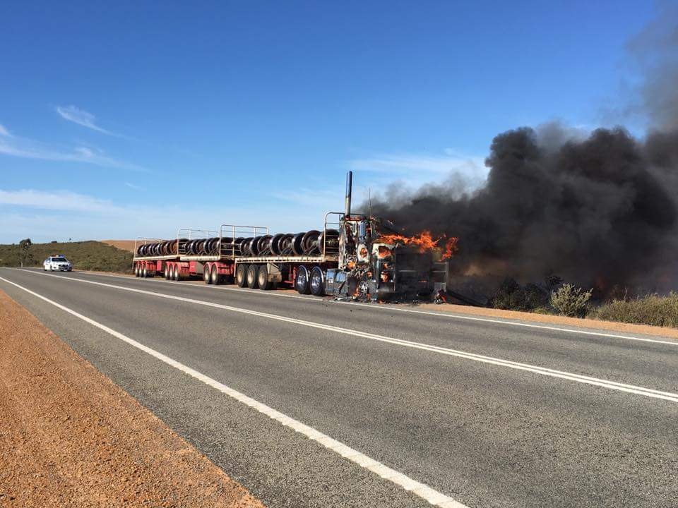

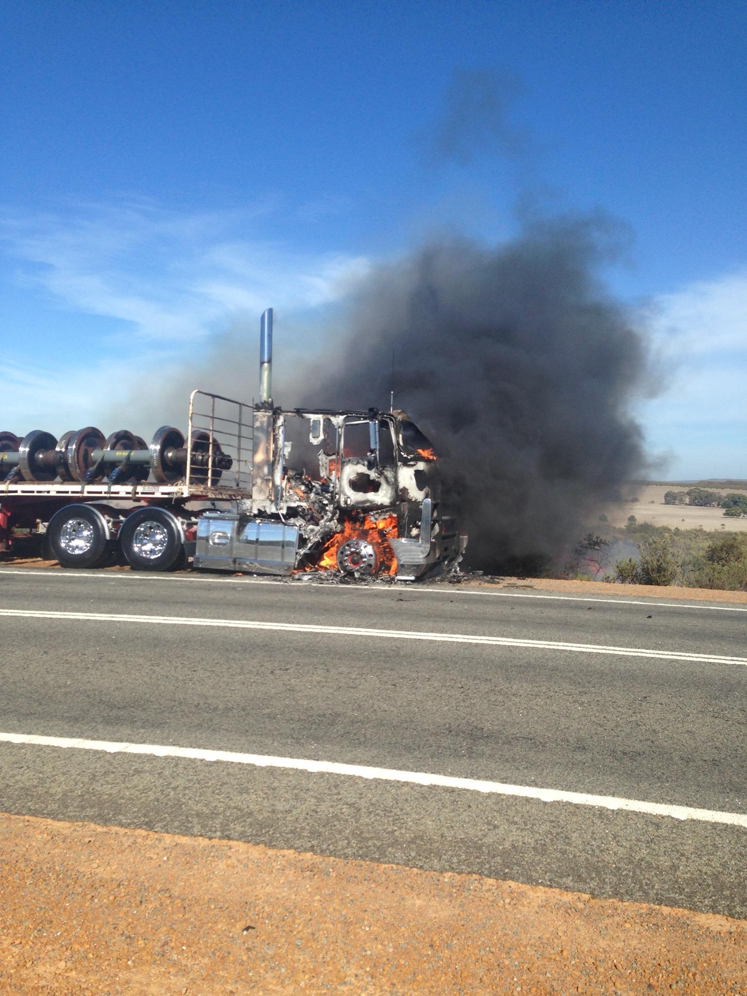

Paul, yeah mostly aluminium and fibreglass. Not much left after they burn out.

The back half of the truck looks untouched, even the fuel tanks survived. IMG_2968.JPG.c9276b45aac7eefa9b9ad28f22fb43ee.JPG

Interesting the way aluminum cabs  burn/melt yet the rubber tire 3 ft away is like new.
The fuel tank was obviously full. It takes a huge amount of heat to get a full tank to burn or even vent out. The tank acted as a fire break to keep the heat from the rear tires.

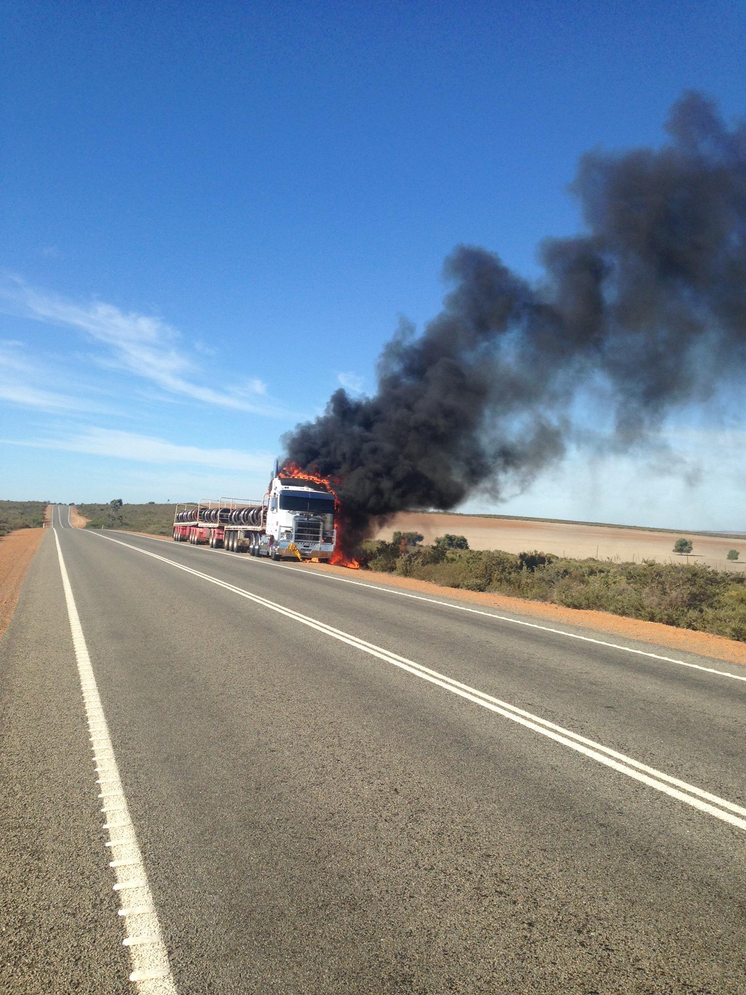

Based on the first pictures I'd say either the left fuel tanks, or the fuel delivery system, failed which resulted in the ground fire you see. Also note that there is almost no interior fire in the first picture. Just a swag, but I'd want to look at the left fuel tank mounts, fuel delivery system or check to see if an object impaled the tank or struck the fuel delivery system.
