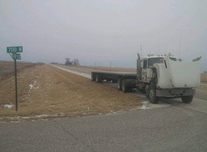

If it weren't for bad luck, I'd have no luck at all. I think it's the turbo...2 1/2 weeks outside of the 12 month warranty. Holed up in a motel for the night...shop will dig into it tomorrow. Too damn cold to do it on the side of the road & too far from home & any other resources I might have available to lean on to help get it done right myself, so it was towed to a shop.
Hell, ain't put but 76,xxx miles on the SOB since I got the new ReMack motor installed...new turbo with the new motor. Not exactly happy right now, but whatcha gonna do?

While waiting for the wrecker, I pulled the intake and pressure side hoses off...no oil, and a little end play...which matches what happened when I blew the turbo with the old motor still in it several years ago. THAT time, though, the thing went suddenly with a "pop" and then sounded like a siren when it tried to spool up without making boost. Pulled it all apart, found a little end play (but no oil) anywhere...intake, pressure, or exhaust...so decided to "limp" home. Made it about 45 miles until directed to a gravel lot by a state trooper who raised me on the CB and I told "it JUST happened, and I'm trying to get it off the road". Good thing he stopped me there, though, because the air cooler was FULL of oil, and it was getting to the intake. Wouldn't have been long before it would've run away on the oil. That and when I changed the oil while installing the new turbo, there wasn't MUCH left...so I learned not to do that. That time, though, I was 2 hours from home. This time, it's probably 4 1/2 to 5 hours. When it popped and I lost boost, I shut 'er down.
This one didn't go as suddenly, though. The exhaust sounded like it was breathing through a fan...sort of choppy, rather than smooth, for about 50 miles. I had checked the oil when I dropped my load and picked up an empty trailer to see if I was "making" oil...and the oil level was where it was this morning during my pretrip...so I figured it wasn't a stuck injector dumping fuel into the cylinder. Gradual worsening "puff" of black smoke when I'd shift, and then the 4-5 miles right before it popped, it was starting to smoke a little just driving. Being empty and too late for a backhaul, and not wanting to spend the night to grab a load that went out farther before getting a load back home, I was bouncing home...hoping to make it. Was going to pull into Mack in the morning to have it looked at before I pulled another load. Truck had other plans, though...
Hopefully the fact that I shut 'er down quick saves a little on the repairs. I know what I did last time (removed everything between the air cleaner and intake manifold, washed them out w/ dawn, rinsed, dried, new turbo, new air cleaner, oil change w/ new filters)...and that turbo I put on lasted until the motor blew up a couple years later. I guess we'll see...they ought to be picking me up here at the motel in a little bit to head in to the shop and have a look.
Warranty on the turbo was 12 months. I'm at 12 months, 2 1/2 weeks since getting the truck back with the new motor. JUUUUUUST out of warranty, despite only running 76K miles.
Good news & bad, though. Good news is I'm home. Bad news, it was on a hook. They fired it up in their shop this morning and the way it smoked, they said "it ain't the turbo" and suggested it go to Mack. Frankfort, IN was 60 miles. I had them look up Joliet, IL Mack because I've got family up there I could stay with to help cut costs on motels and meals, and it was only 20 miles farther...so I said that's likely where we'll go, but just for S&G, let's get a quote back to Cape Girardeau. 325 miles. They quoted $1400 to go to Cape, which included the mile or so tow to their shop last night and whatever time they had looking at it this morning...and Joliet was only $650 less.
