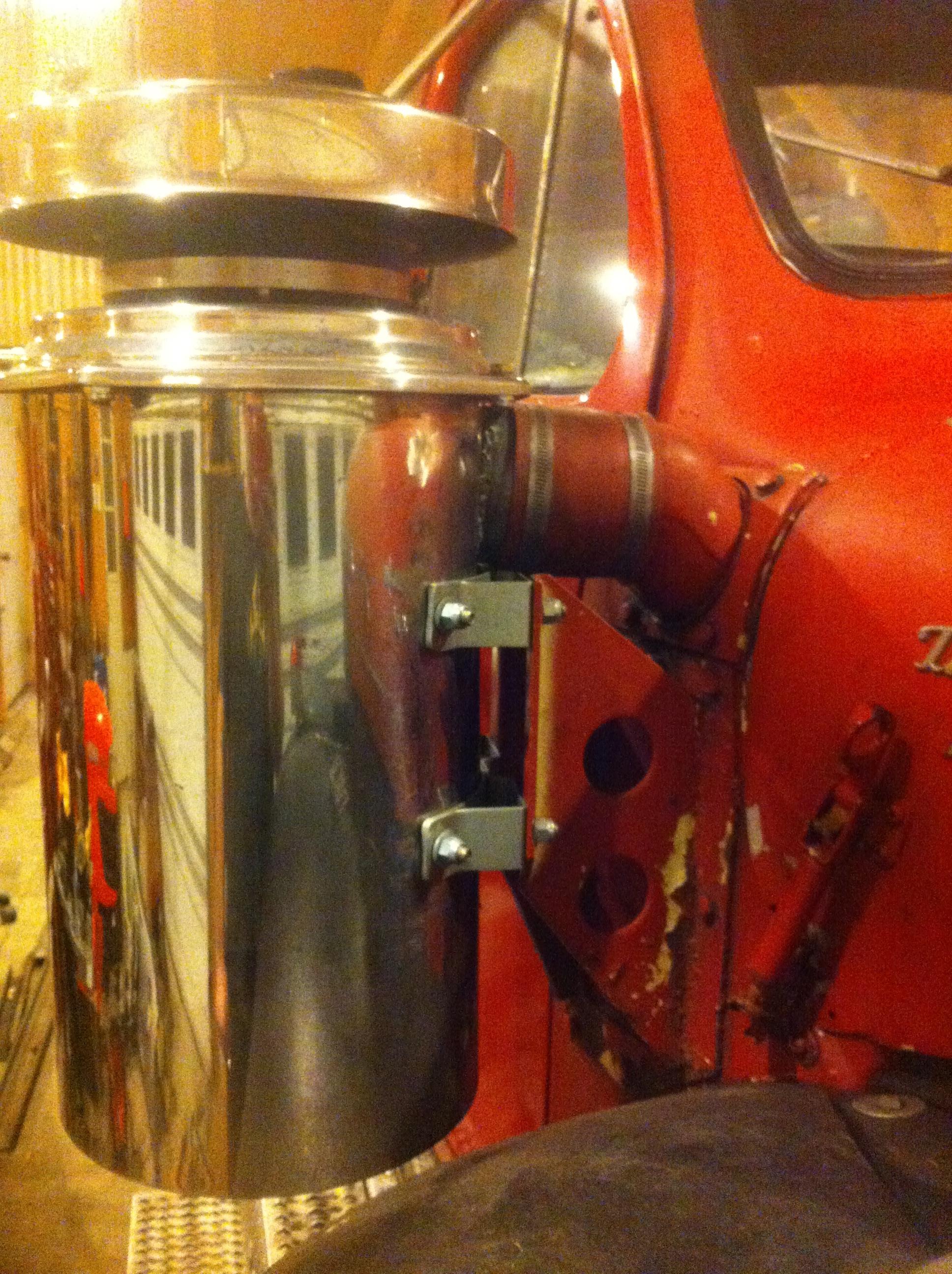

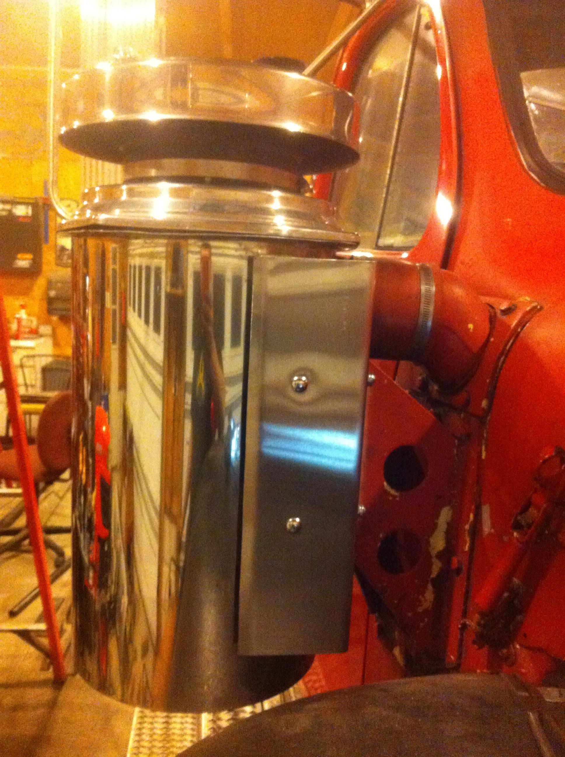

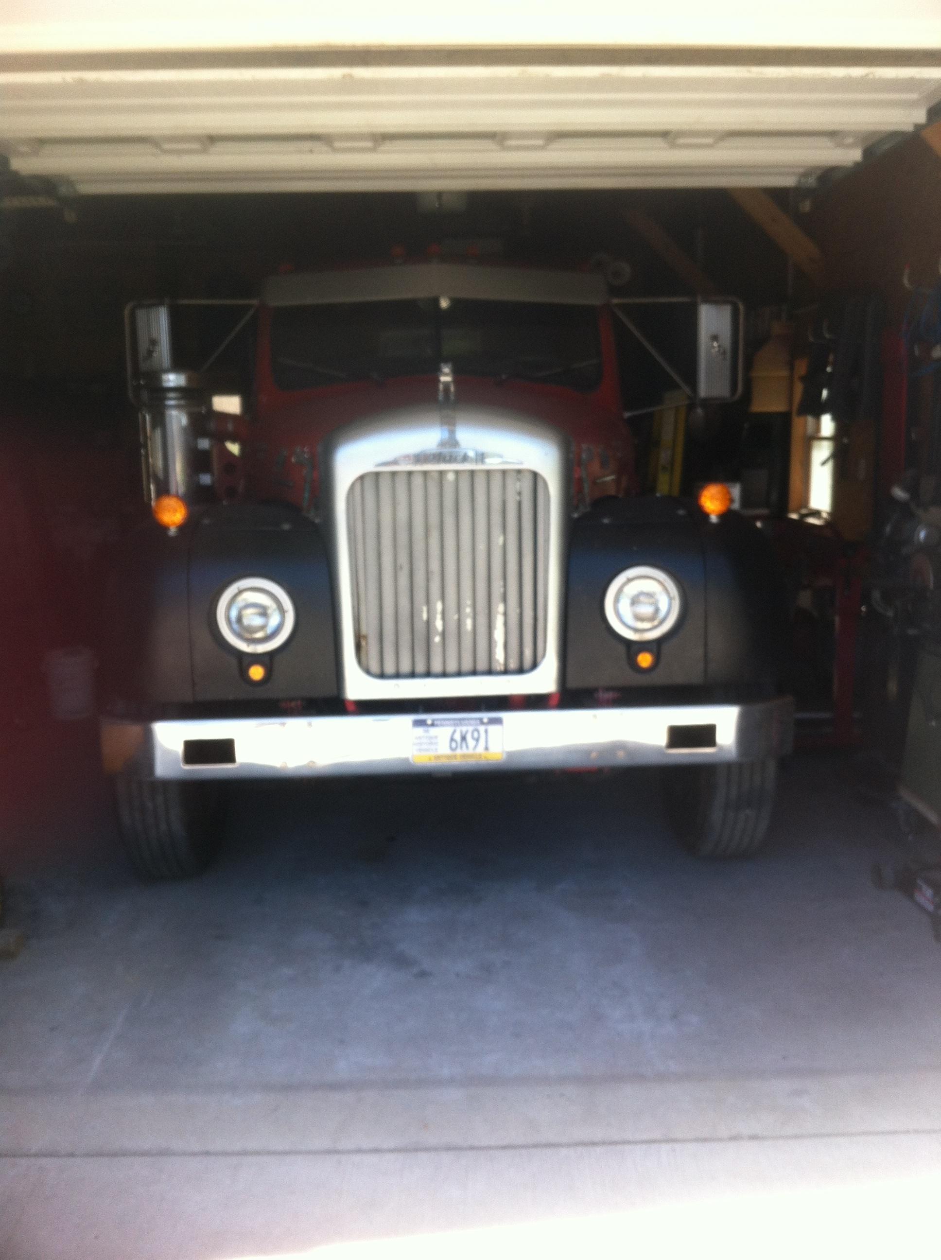

Finally time to start assembly.

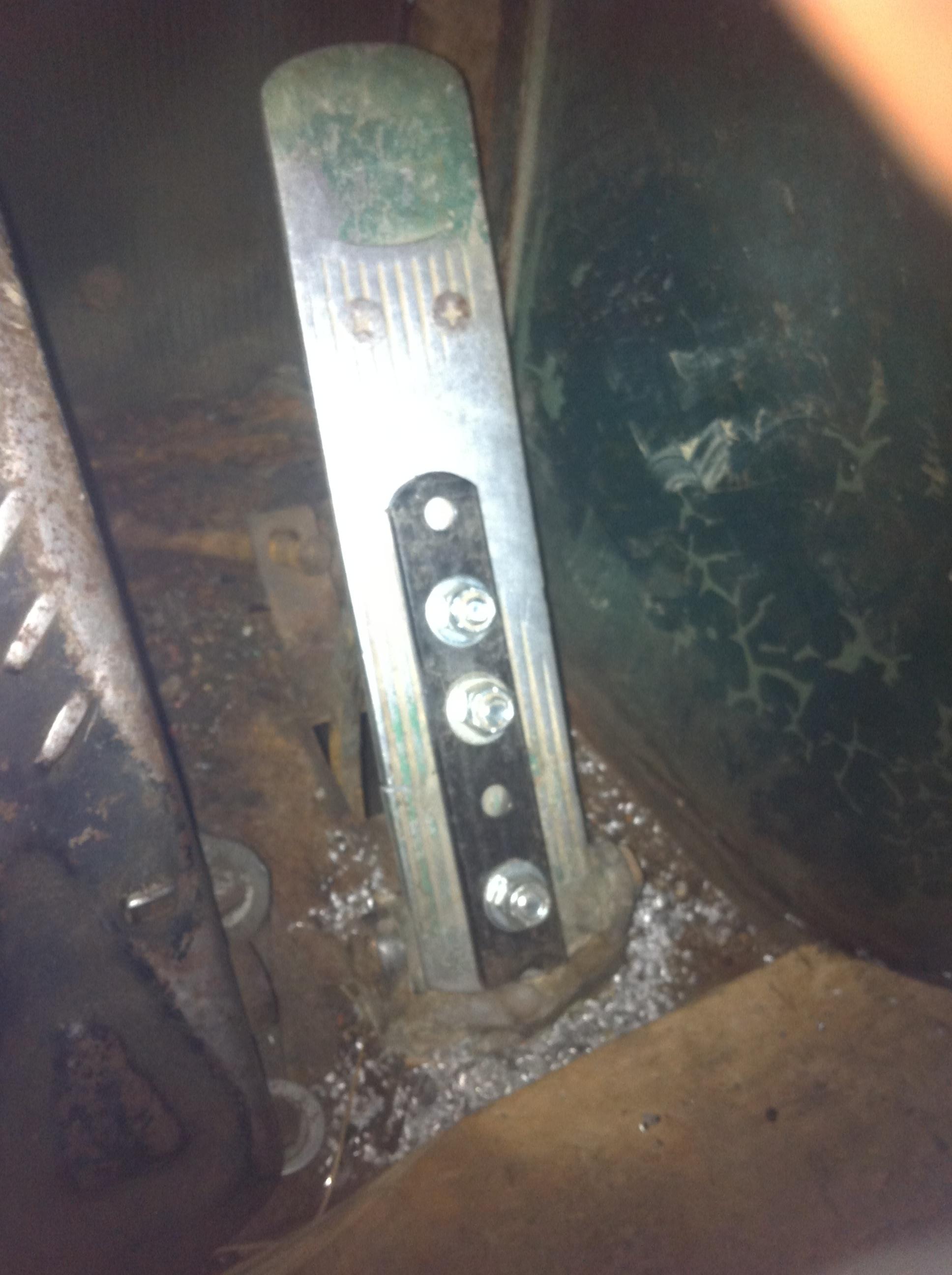

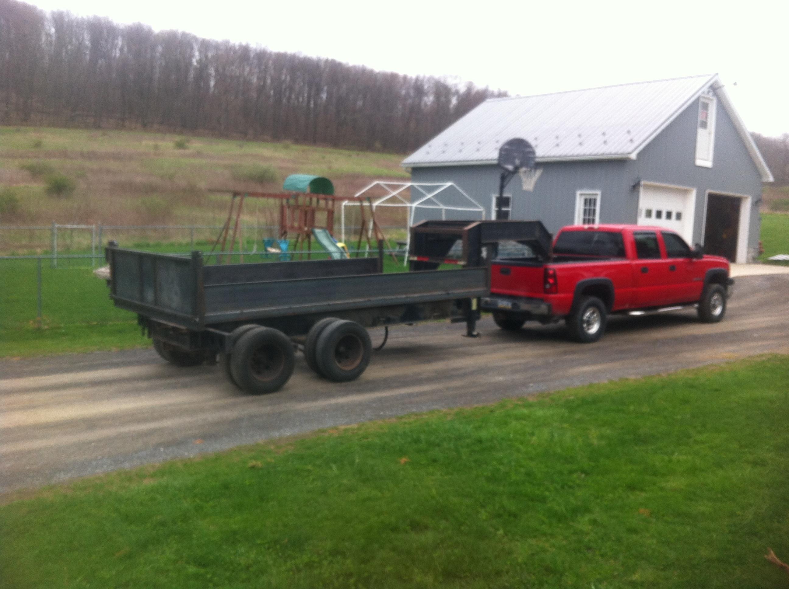

Not so good day today.   Loaded our 2 johndeere's on the trailer behind the "B"today and the 2 kids and myself left for a show/pull about 25 miles away.     On the way there truck  something didn't seem quite right,  seamed low on power.   This was the first i took it up and down the hills that way loaded so I just wasn't sure.   Got there and fuel was spraying on the side of the truck.    Front injector line is spraying fuel out the fitting on top of the pump.  Nothing to do there so wired a can over it to keep the fuel from being sprayed on the exhaust and it will have to do.   Unloaded tractors and got a 2nd place in my first weight class with the kid's "B".   Second class something seamed to get tight in the motor and slowed it to a stop.    Pushed it off track started right up and loaded it back on trailer.   End of the day went to leave  made it 1/2 out the driveway and the throttle pedal on the mack snapped off about 1" above the pivot where the 2 bolts go through it.    So I called my dad and had him go to my place (only 1/4mile) to get my pickup and a list of tools I came up with in my head.     He took the kids and the gooseneck home so they could get to bed(very unhappy wife).   I ended up drilling the pedal and bolting a steel plate across the brake to bring it home.image.thumb.jpg.724260ee8dc306914a8f30c39485d859.jpg.  My pillows not on the couch so I guess I'm safe.
After all my rambling on now I'm gonna ask for info.    The fuel lines that go from the pump to the injector. Do I buy them, make them, or how do I go about that fix?  Do I change them all right away?  How high of pressure are they?
  I think I've seen the fuel pedal assemblies on the Watt's sight.

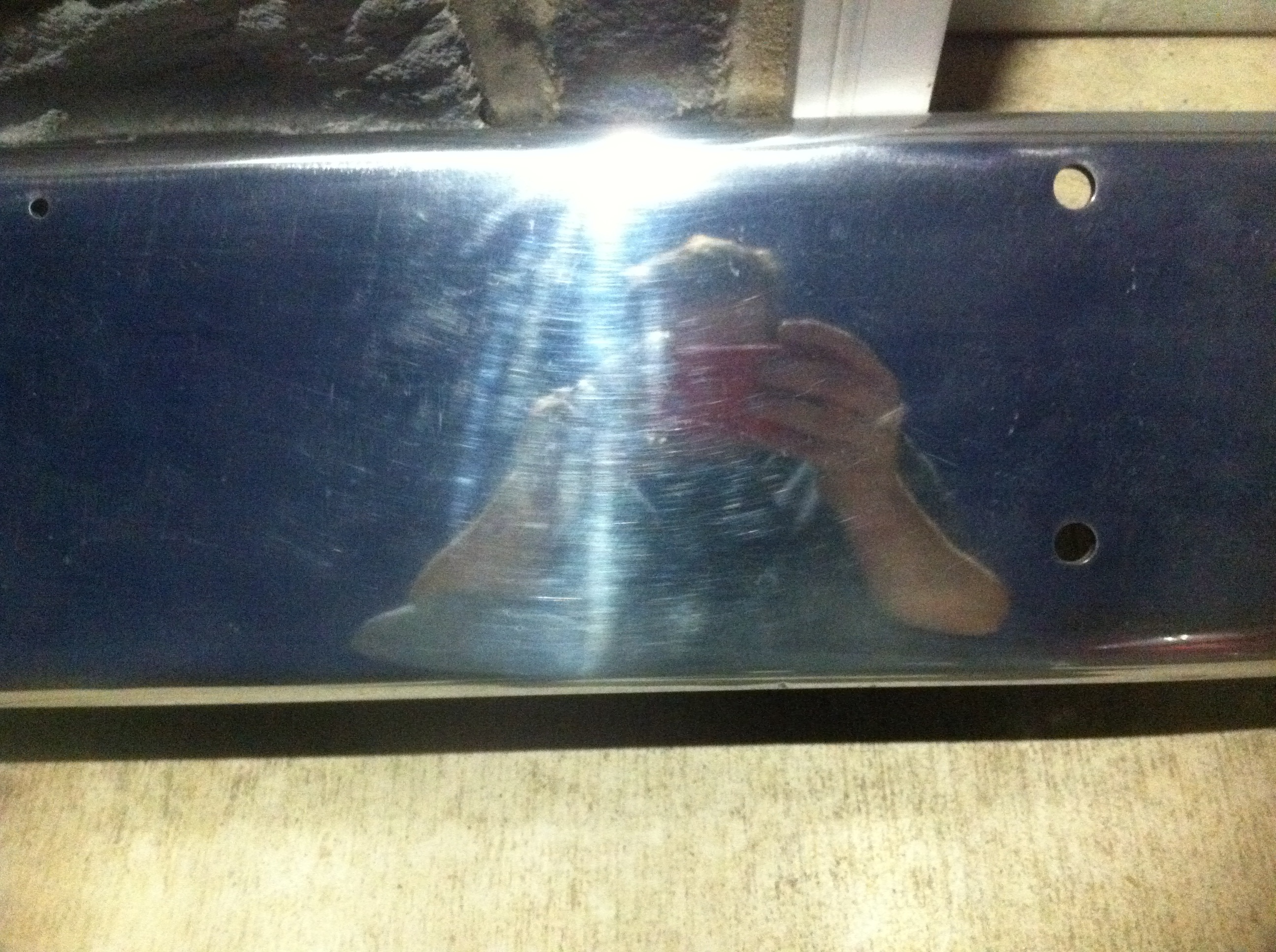

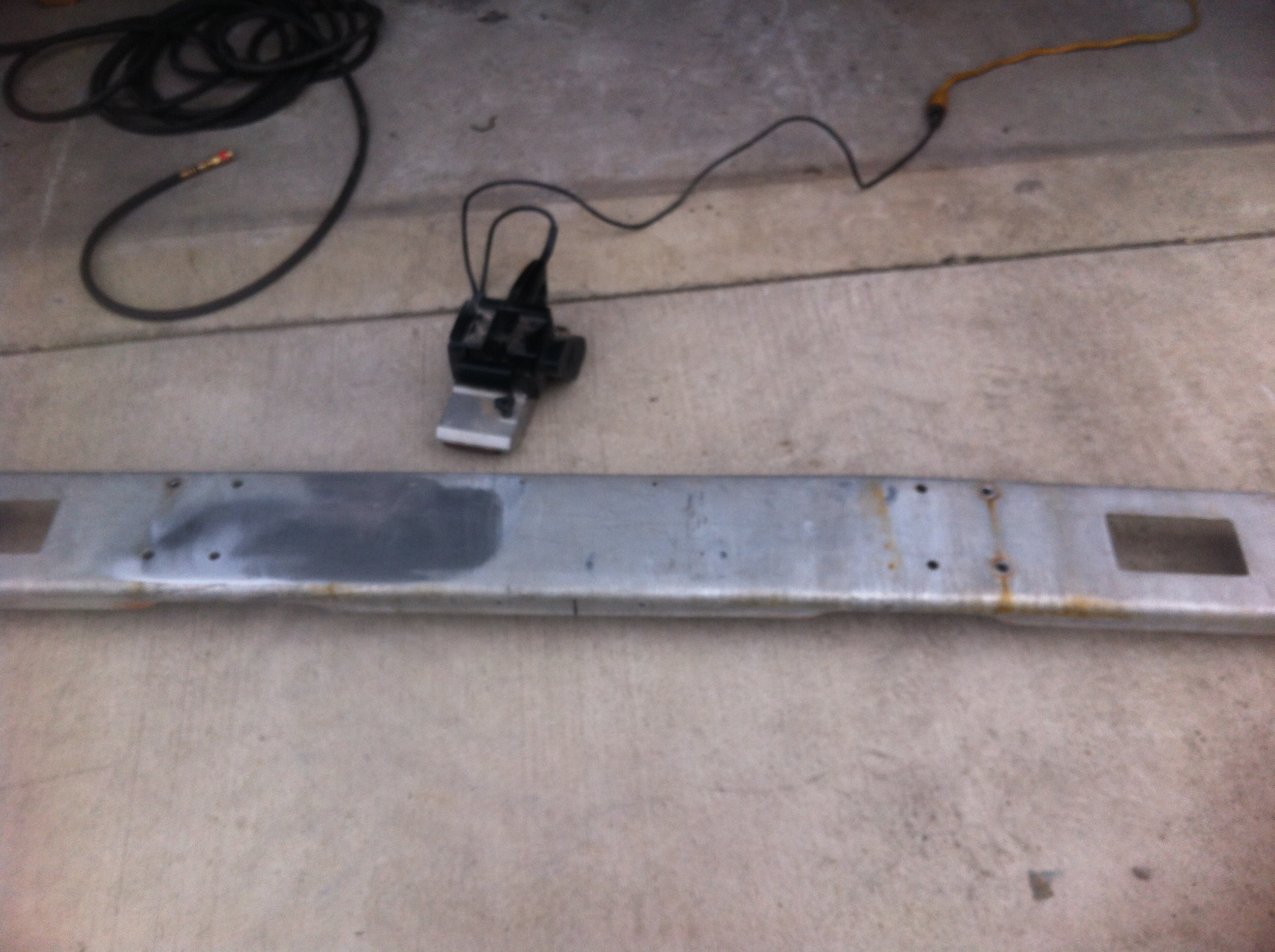

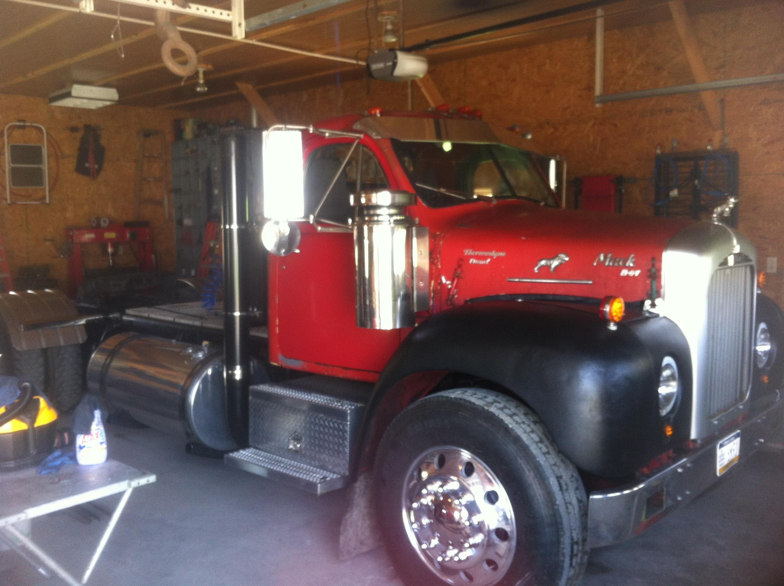

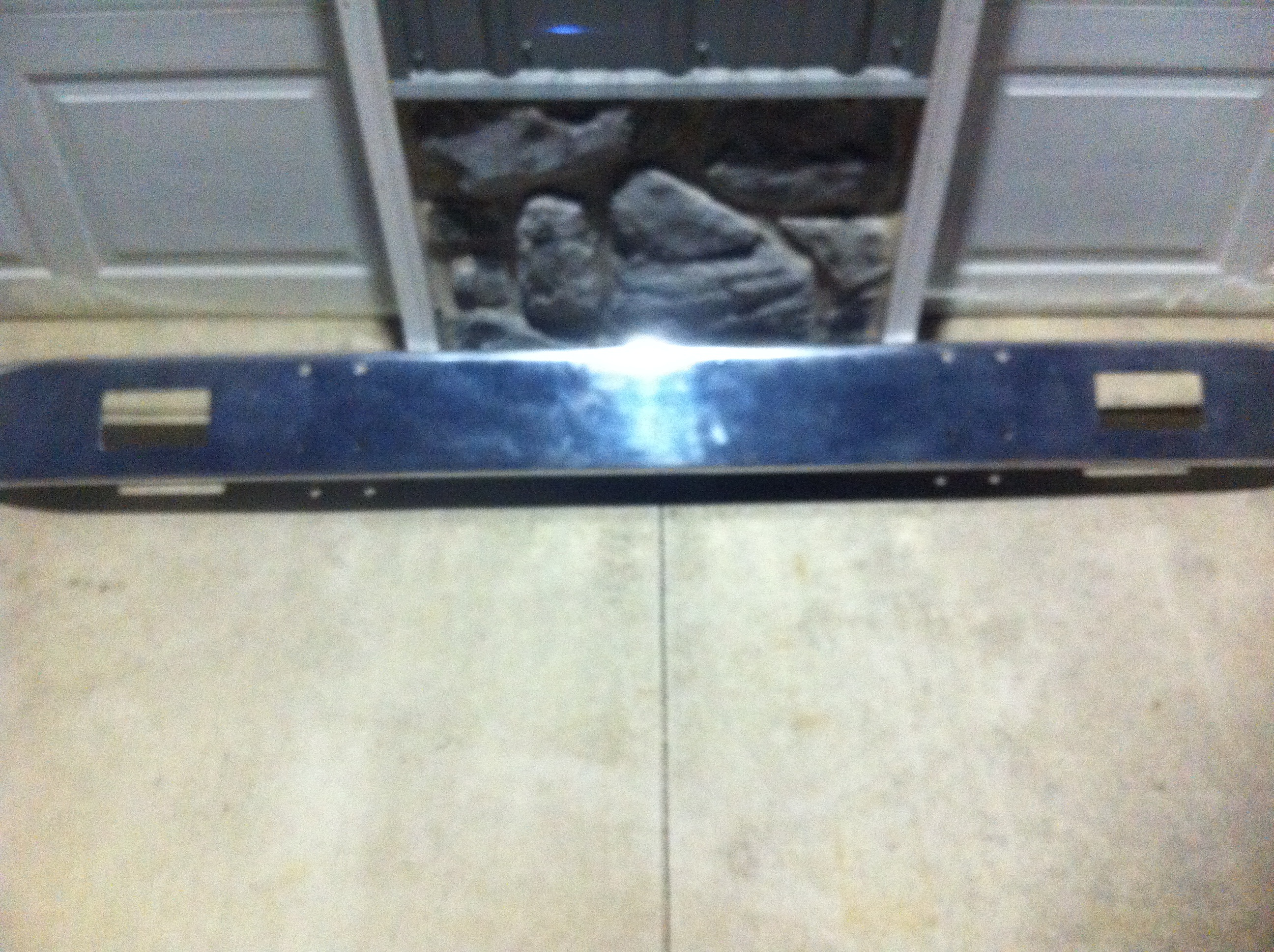

Started on the front bumper yesterday with 80 grit on the da and belt sanders.    Then went to 180, 240, 400 wet, and finally 1000 wet before buffing.    Then dad started with his red cutting wheel with rouge and I think 2 other steps.   Still needs rubbed over by hand once stuck back on truck, but turned out pretty well.
  The finished pictures are under my led pole light at 5:30 this morning.
